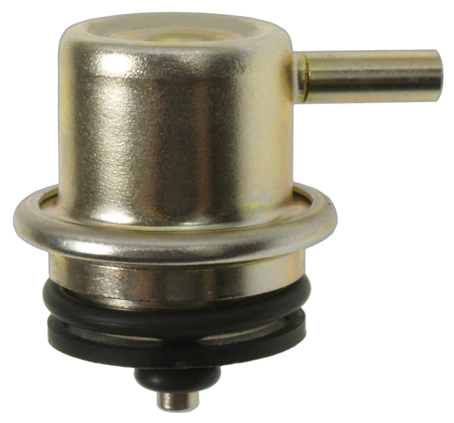

I thought he was talking about the one you would see on an FPR
Maybe I misunderstood. I was thinking about the fuel line that returns fuel back to the tank
I guess it could be bleeding off too much...

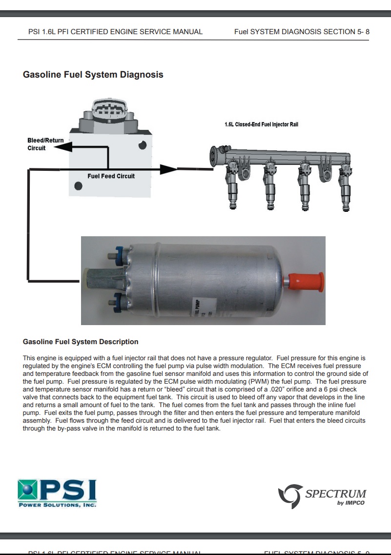

Do you have an actual manual?
If you talk to somebody at PSI that sounds like they know what they are talking about ask them which method is used to calculate the fuel pressure. It may not be gauge pressure and could make that 32 or whatever what you should actually be seeing on the gauge.
It's possible it could be bleeding off too much. Especially since it is the only thing separating the two sides with the only other leakdown point being the injectors. I ended up finding that 55 number which got me thinking about why would it be bleeding off too much.
When the manual tells you to put a gauge inline it doesn't say where. If we assume before the manifold is where you should see the 55 +/- 5 I suppose your reading of 70+ could be overpowering the check valve in the bleed circuit. Are you using the correct pump?
do you have a model-specific manual?

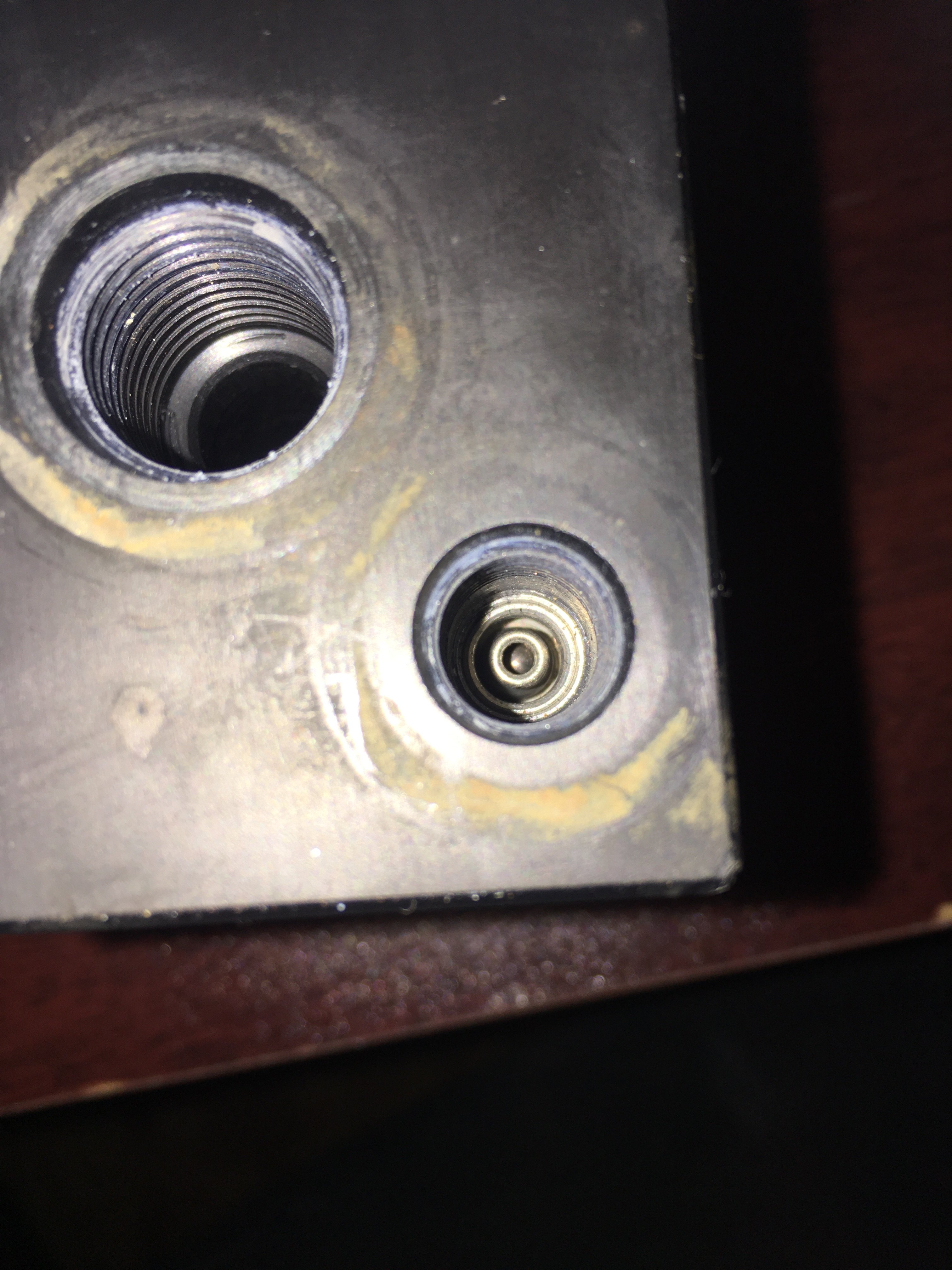

Fred, that's the exact fuel pump I use. It's rated at 95psi, and sapphire told me they use a 120psi pump. I bought one of those on their specs and it didn't give any improvement. So I put that 95 back on since it looks more original

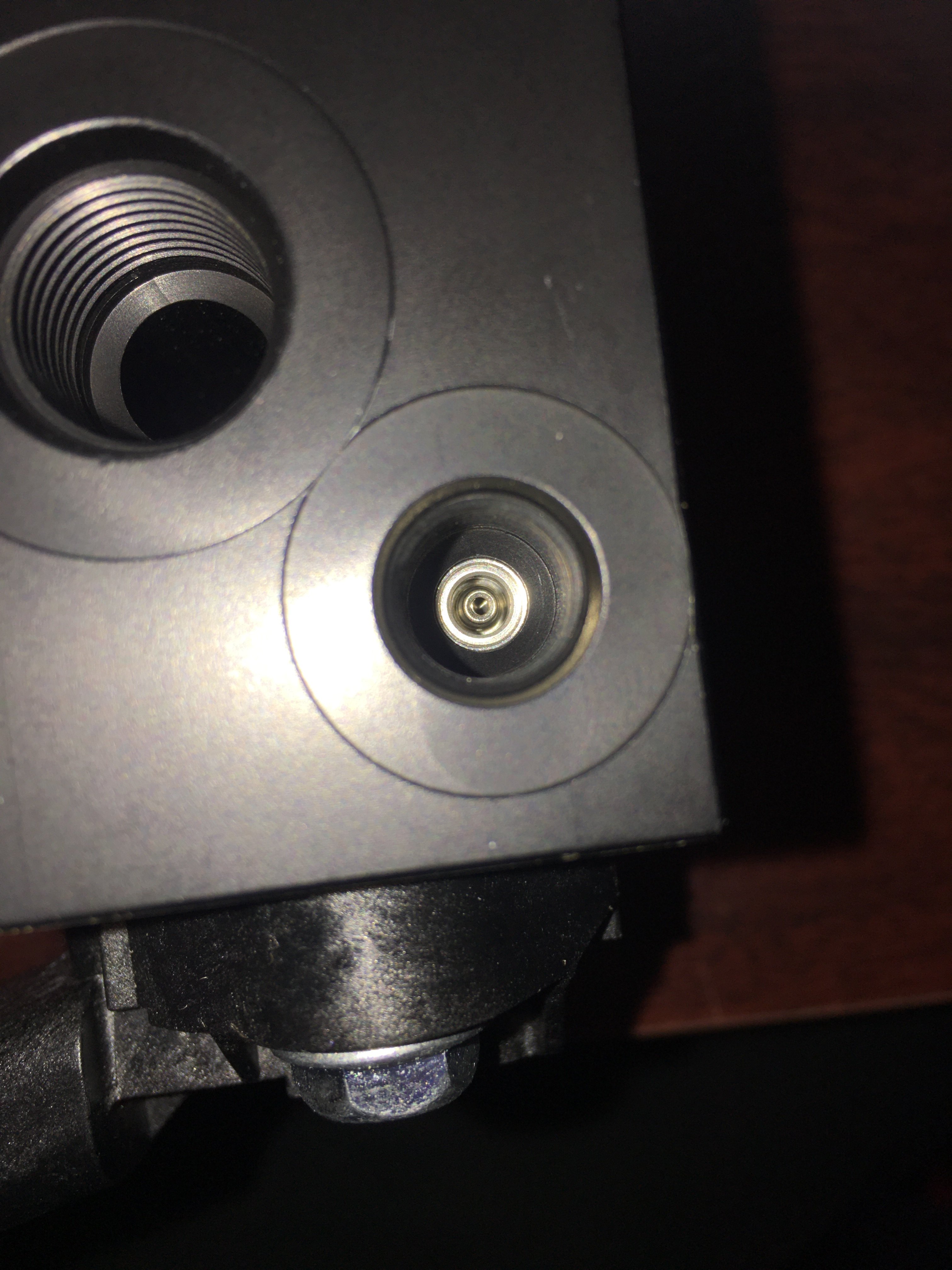

That ball in spring valve is deep inside the bleed port that goes back to the fuel tank. I'll post a pic of both the old and new one
And Nate, I tried clamping that bleed hose to see if it'd increase the fuel pressure, and all it did was prevent my machine from starting up. So that's a dead end.
And look how the fuel goes into the MAP sensor manifold. Sapphire flipped that thing backwards and the fuel enters the manifold from the other end. I tried flipping it on the old manifold, but not the new one yet. I never got an explanation on why they suggest that on the thermal wave.

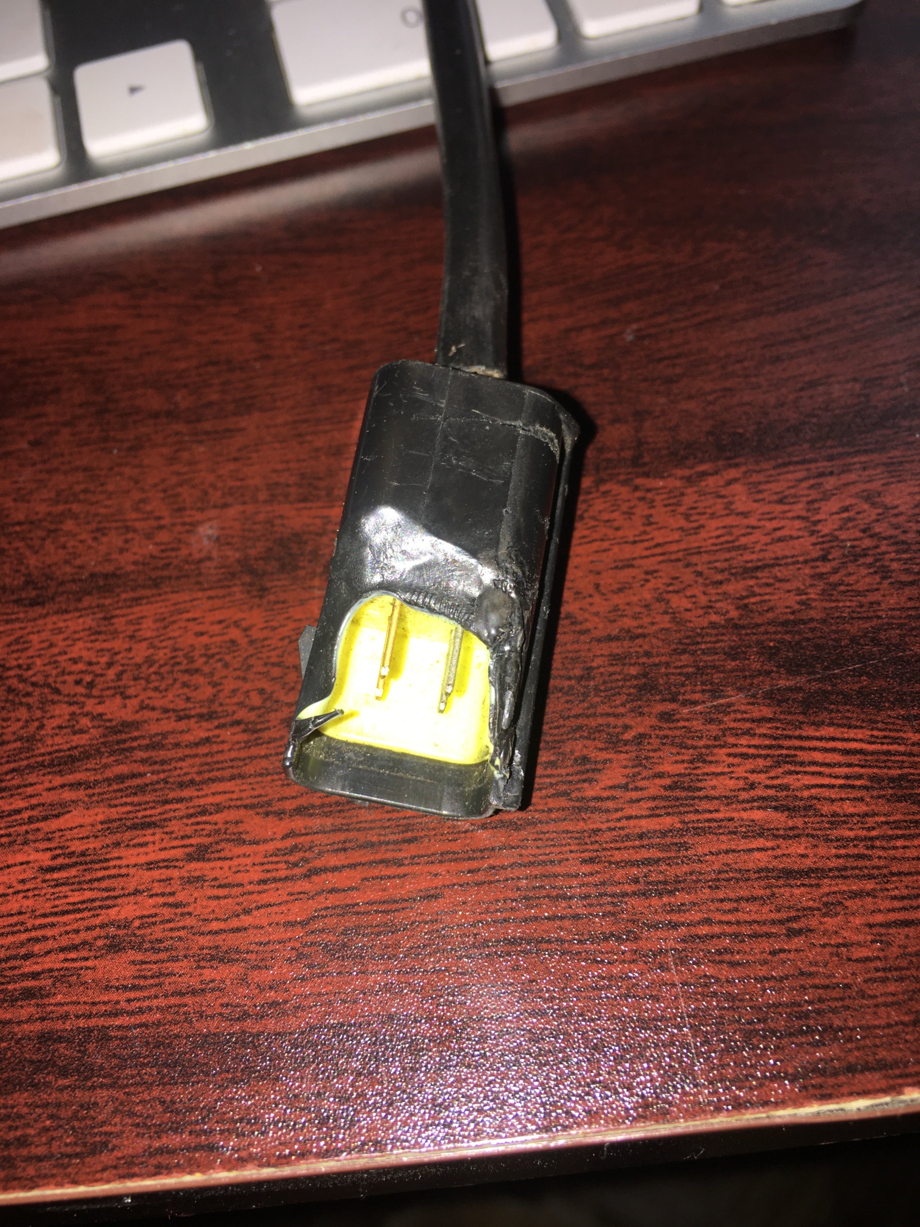

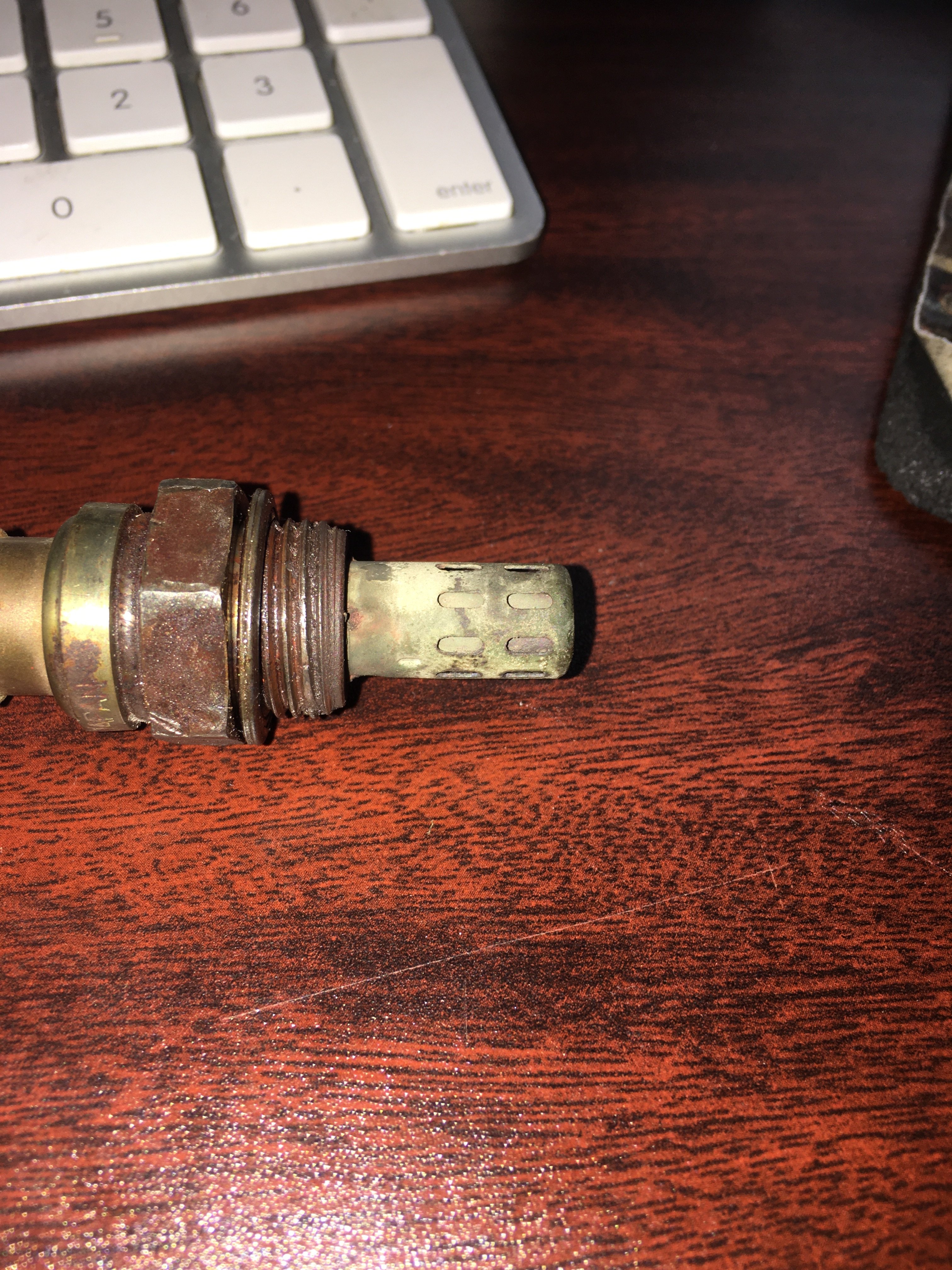

I haven’t tested the area yet but I think you were right on it being o2 sensor related. @Mike J told me to call Scott Lombardi (thanks Mike!) I spoke to Lombardi this morning and he targeted the area of concern from my description of the problem and code 91
I’ll let you know what I find when I get back on it

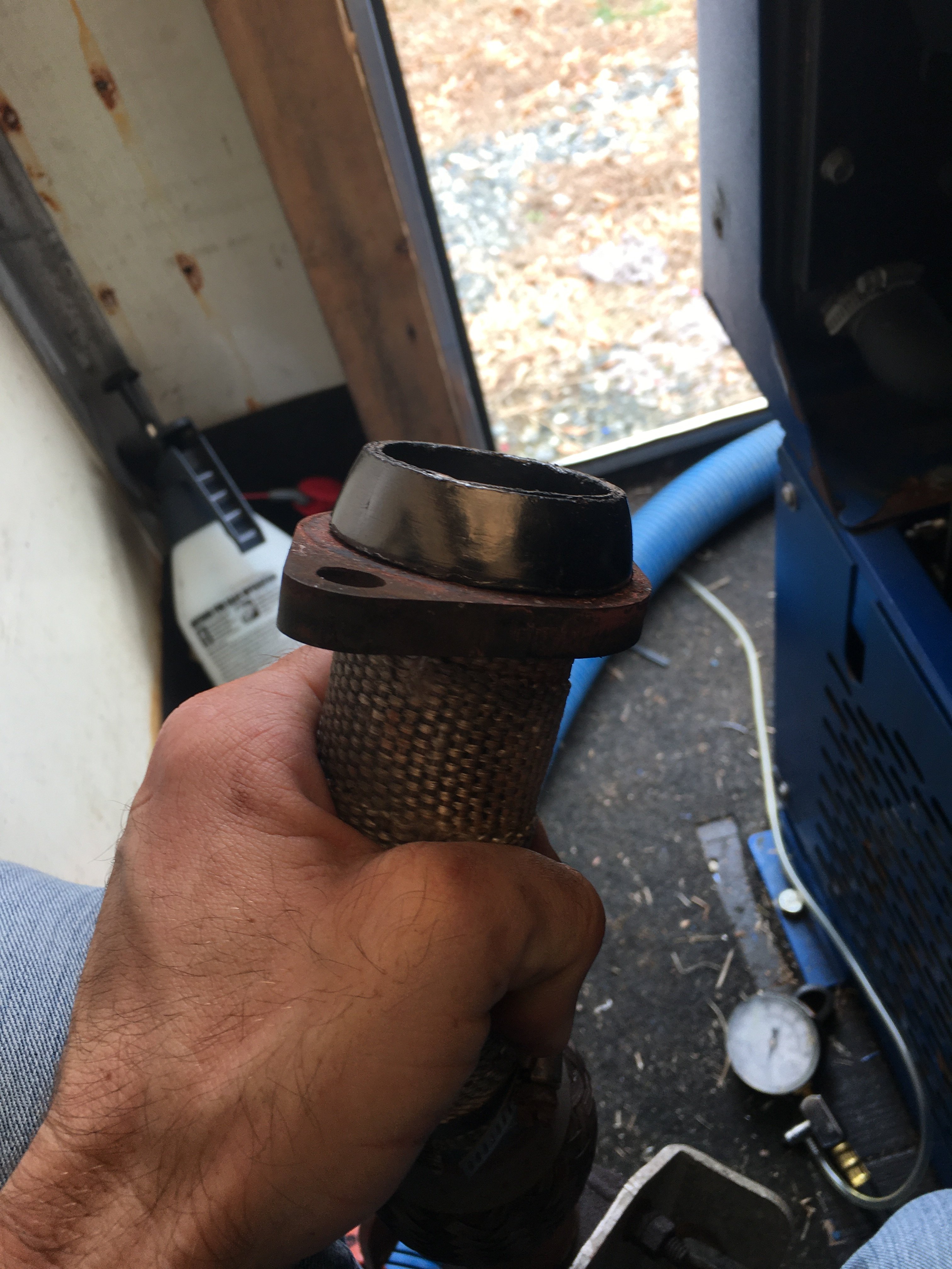

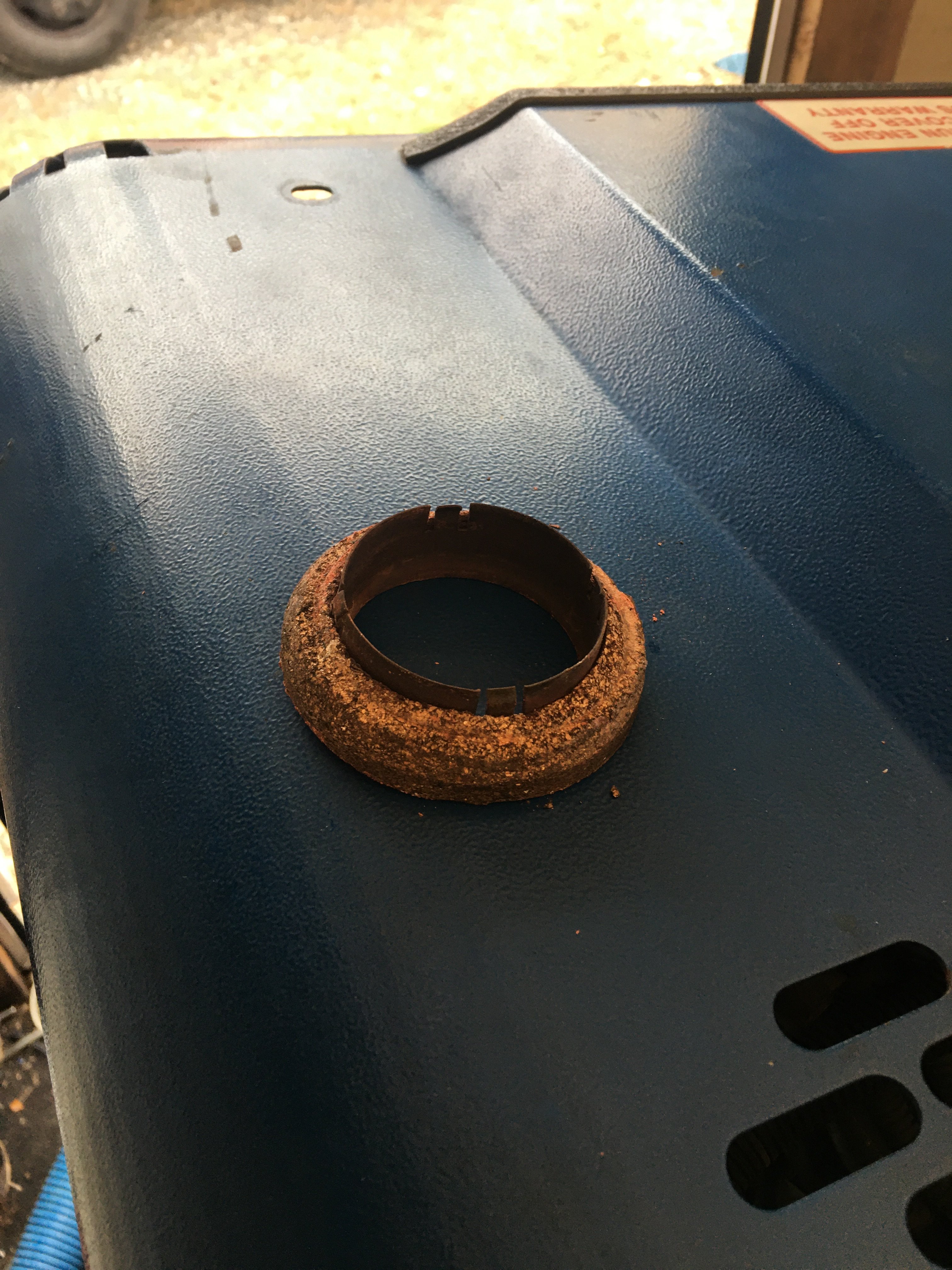

The part I'll check on this weekend is the doughnut gasket under the exhaust header. I was told that is a troubled area and I remember the previous owner telling me he replaced it with a "matched" one he found at an auto parts store. FKIN BAndaided almost everything on thiS DAMN MACHINE! I hate cleaning up rigged shit! Why can't people just fKIN replace shit the right way, instead of duct taping!!!
Back to my problem...If it's still leaking, it's pulling in fresh, cool air, telling the O2 sensor it's rich in fuel, therefore the ECU tells the pump (code91) to lighten the fuel pressure so it burns leaner, which causes the problem I'm experiencing. That's what Scott Lombardi told me this morning, which made perfect sense. Especially since I know the history of the douchebag bandaid ing this part.
An exhaust leak would more likely create a false lean. The af sensor right after would be reading more air than it should be and therefore reporting to the ecu that the mixture should be richened.
But you are seeing signs of an actual lean condition
Of course it’s still not a bad idea to listen/check for leaks
And check/replace the upstream o2 sensor
14,095
He made a point about the cool air being the culprit, saying that it reads too rich since it’s cooler, but I’m just repeating what I remember for our conversation. I’ll know more when I do some testing and checking codes after I swap out the doughnut gaskets
I think you might be misremembering. An intake leak could certainly cause a lean condition.
Introducing air into the exhaust stream before the o2 sensor is more likely to make it appear to be lean when it’s not. Possibly even throwing a lean code but depending on the severity may just attempt to richen the mixture.
So you would see indications of a rich condition at the plugs while the o2 sensor was indicating lean
Barring some more serious issues the combustion chamber mix shouldn’t be directly affected by an exhaust leak
I suppose there is a chance this could somehow trigger the 91 but that seems more likely to be a wiring issue if not o2

Fixed the code 91 with replacing the donut. I'll post some pics and video soon
A new code came up. 134 EGO 1 open/inactive

The fuel pressure is still the same but the o2 sensors might still be the cause 1E1D84CA-85D3-41DA-9CC5-7666B454C895.jpeg 75338DA3-10B8-4D6C-899A-5F428F1D7111.jpeg
