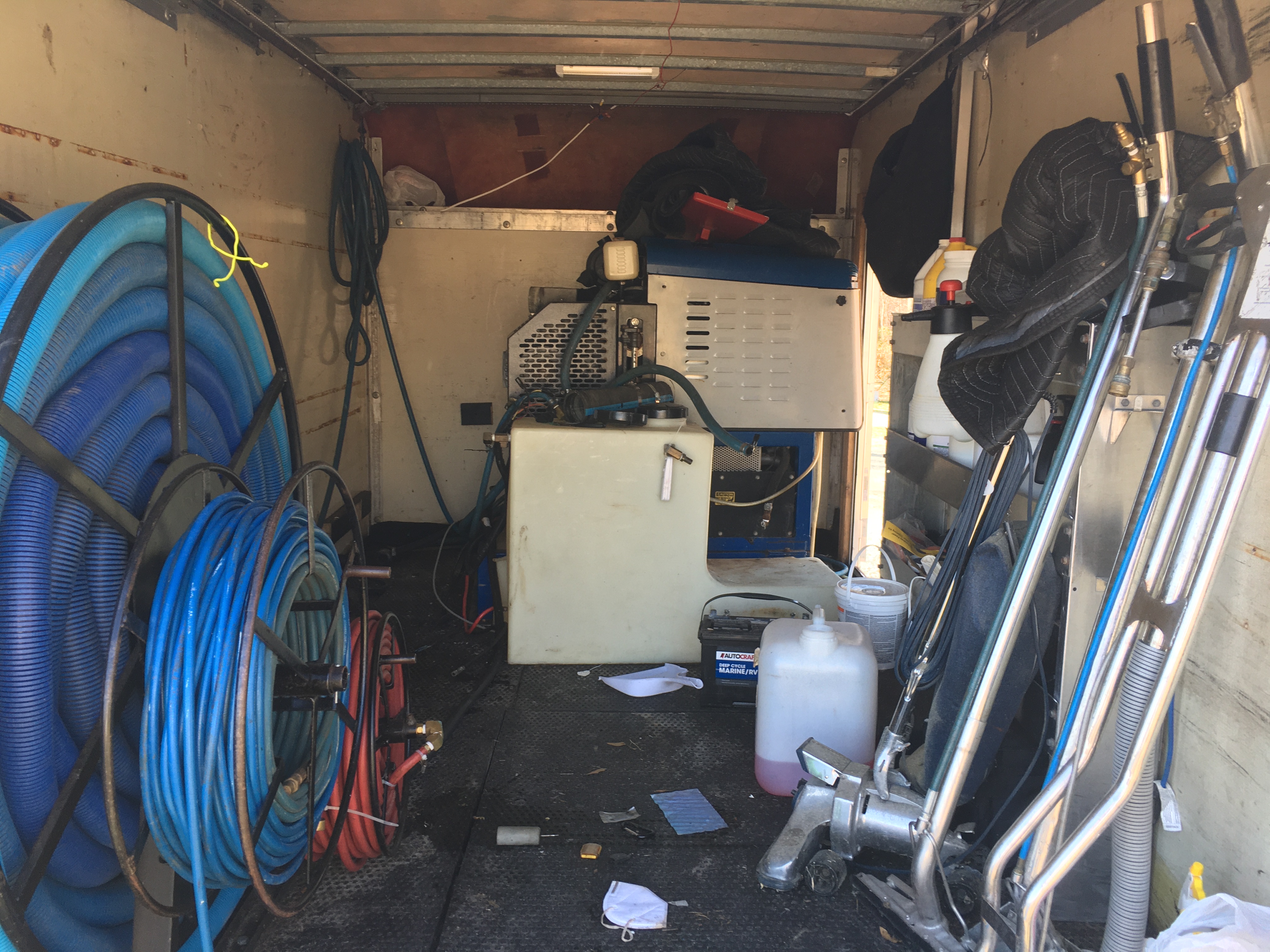

I’m taking it to the forklift later this week to move it. Rubber mats underneath are getting pulled up.
The waste tank was behind it but I think I’m gonna move it to the left side of the machine for better mounting space and ease of access to the rear and right side of the machine.
The van needs a power steering fluid reservoir, a tuneup, and a new rear door
As for the tm, the water pump needs tlc, and the 185f thermal relief valve needs replaced. 🤞. Once I get it completed, we’ll see what other issues it might have

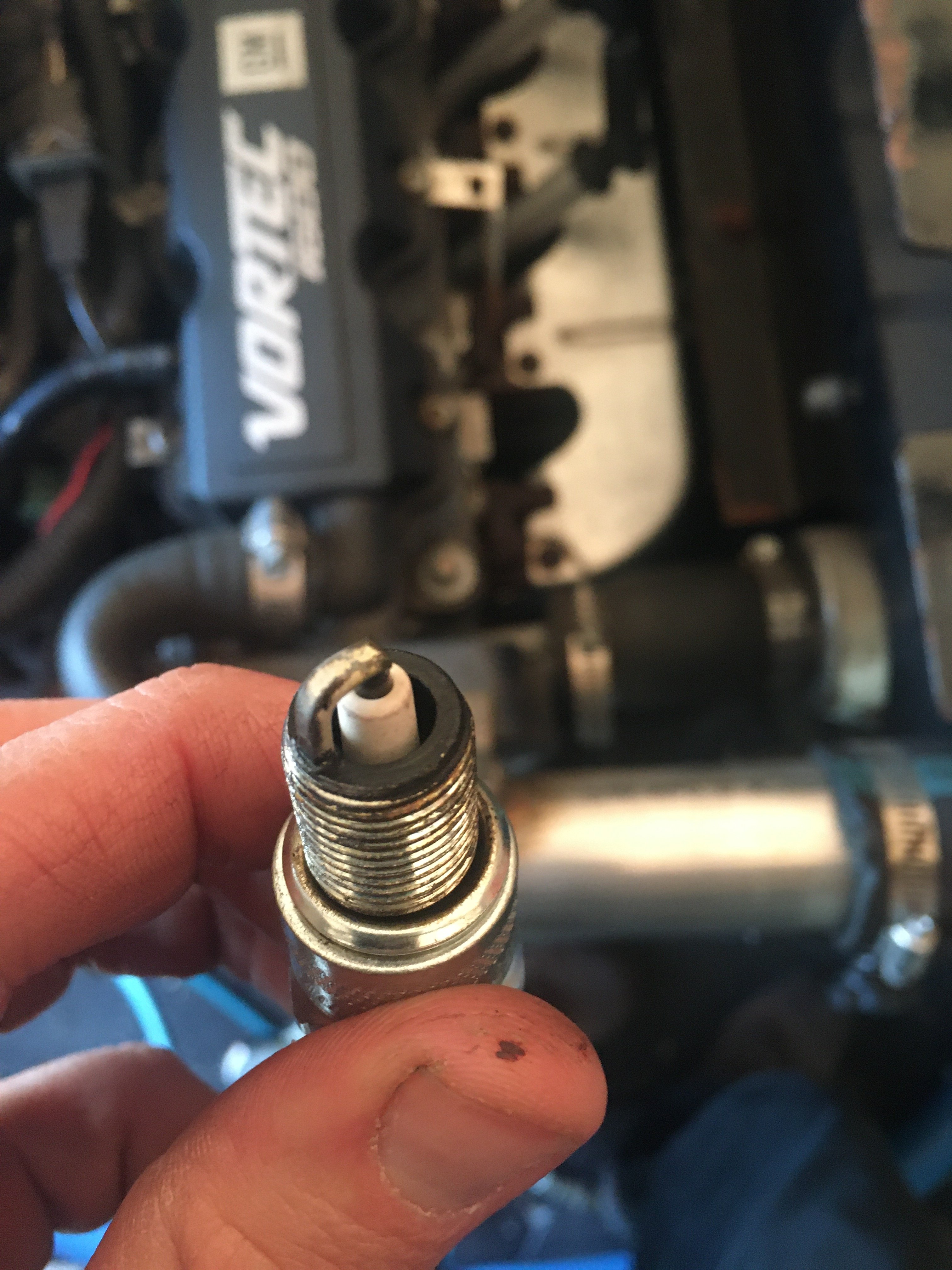

did you check the plugs?
Yep. The gap is supposed to be .031-.035. It read .035 and I just installed the new fuel pressure regulator manifold on the fuel rail underneath with no improvements.
What else could be causing the lean/hot fuel burning?
  • Wow
Reactions: Living The Dream
The Air/Fuel ratio sensor...
did all the plugs look like that one?
and how did PSI describe that piece you just installed?
14,094
Manifold w/f/temp is what’s on the receipt
I think 3 out of the 4 plugs were that way

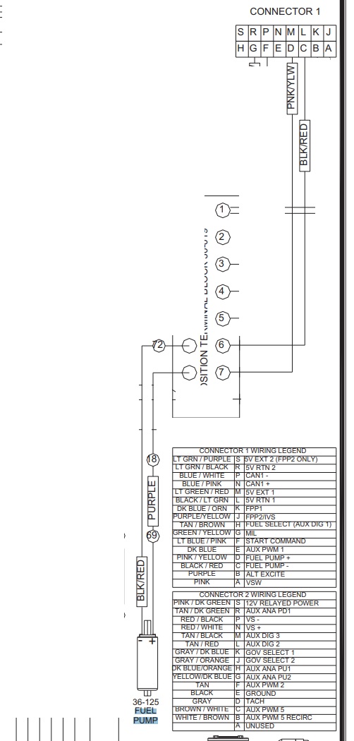

btw how is your pump wired?
14,094
The pump just has two wires +and-

It has a manifold before the rail with a fuel pressure sensor/map on it. That sends a signal to the ecu which controls the fuel pressure by modulating the fuel pump ground/-. **
Edit: this is why I asked about the fuel pump wiring thinking maybe somebody rewired it where it doesn't get controlled by the ecm....but like I said I don't understand how that would cause the drop
Thermalwave fuel pump wiring
