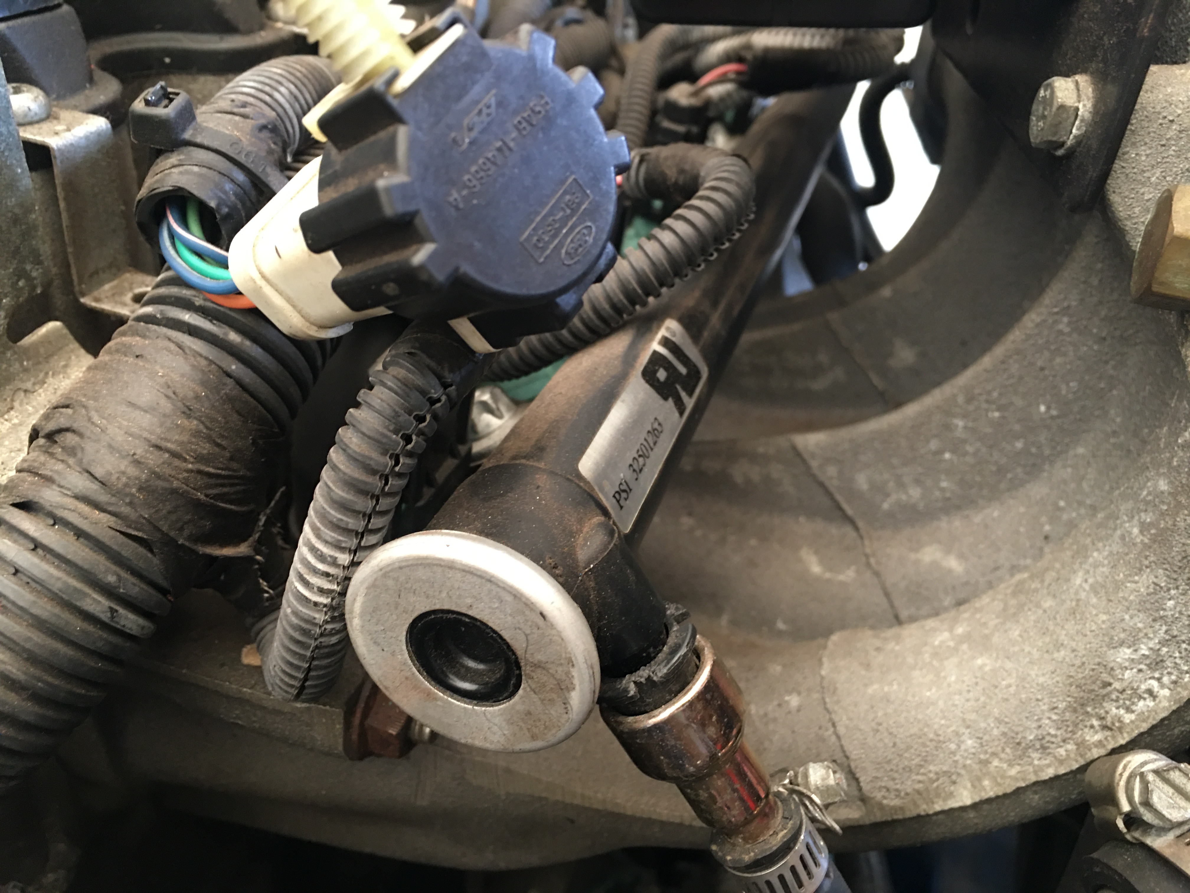

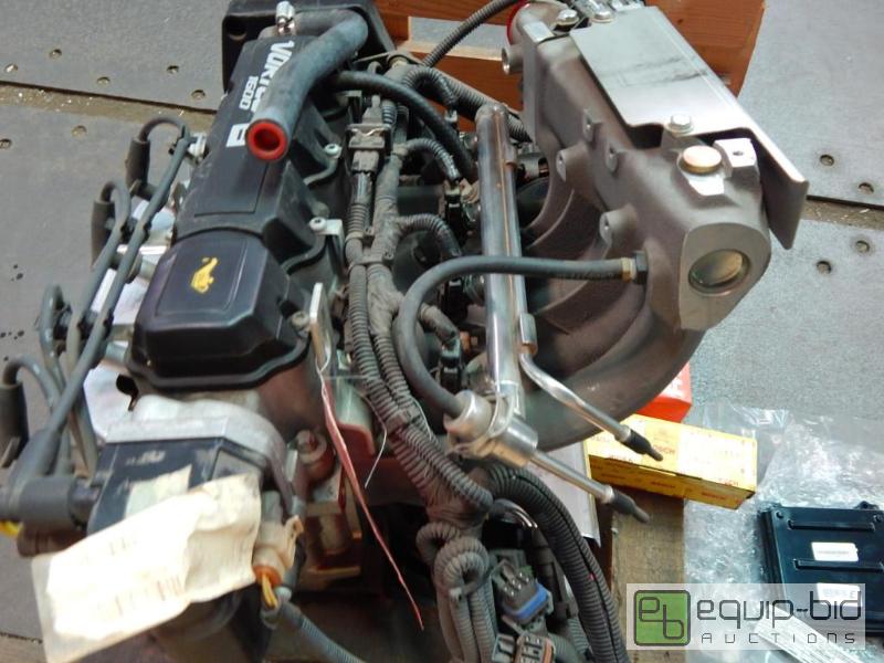

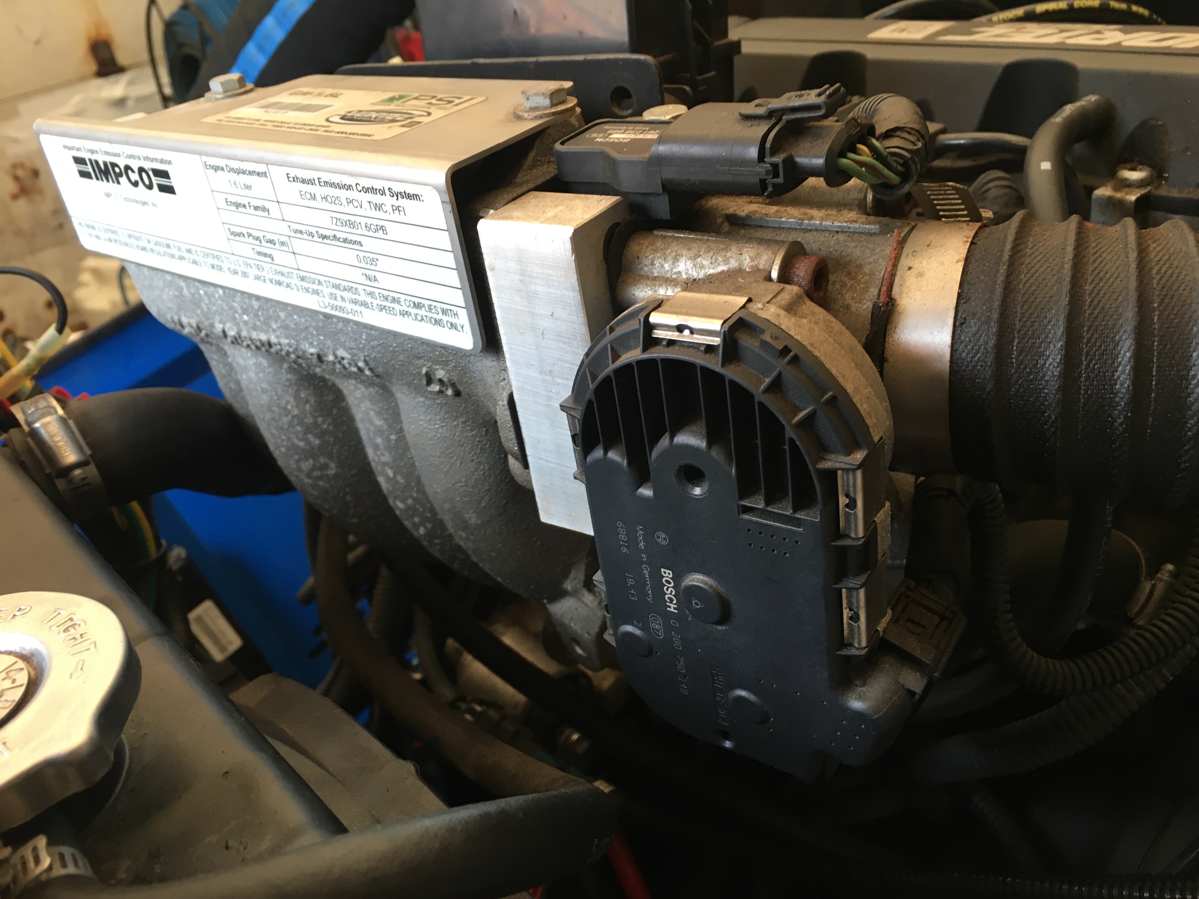

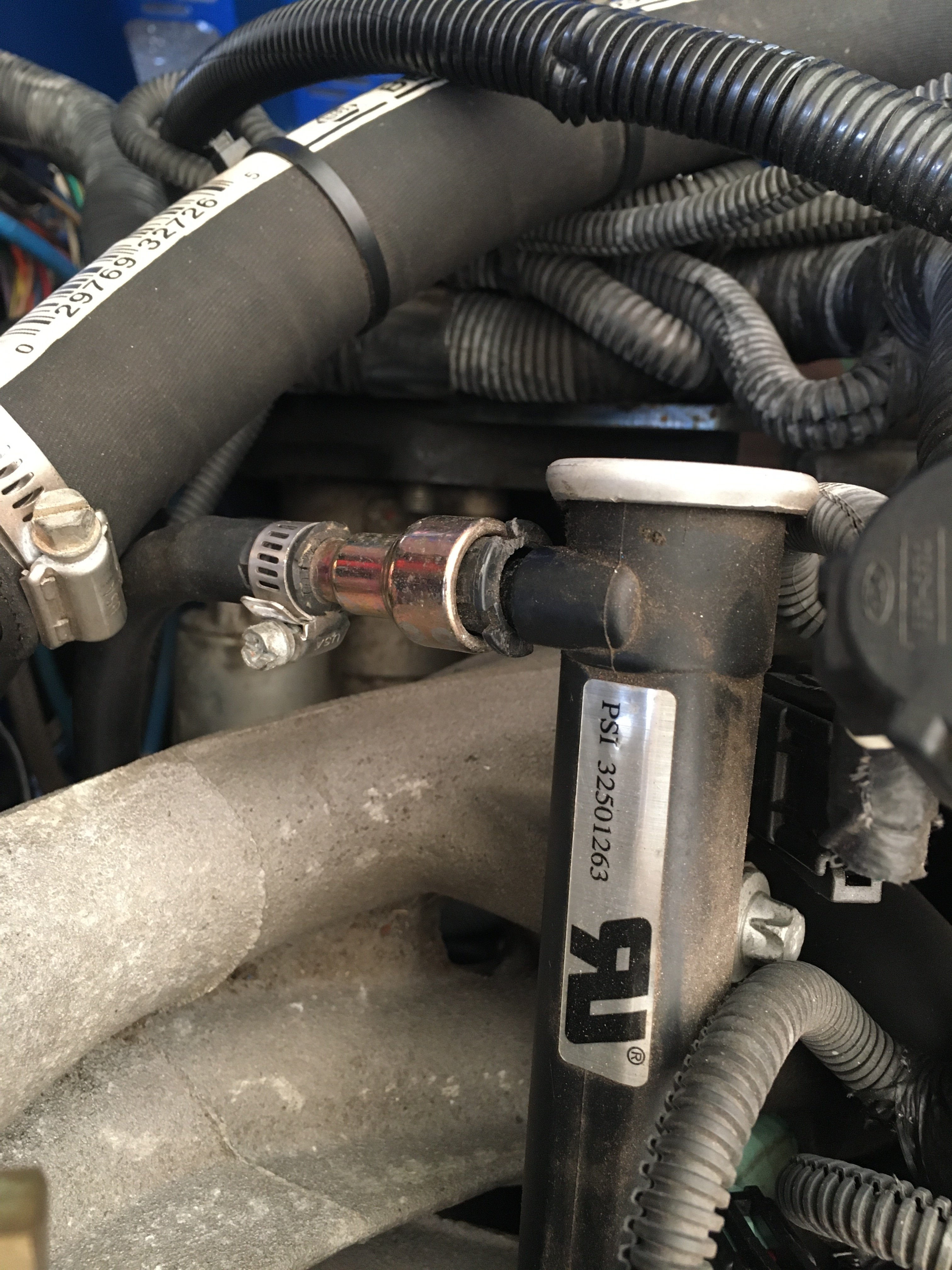

That connector close to the floor is where I’m reading 35psi right before the injectors.
Justin told me 55. And the chevy Aveo engine has the same pressure of 55ish also

is the regulator is built into the rail.

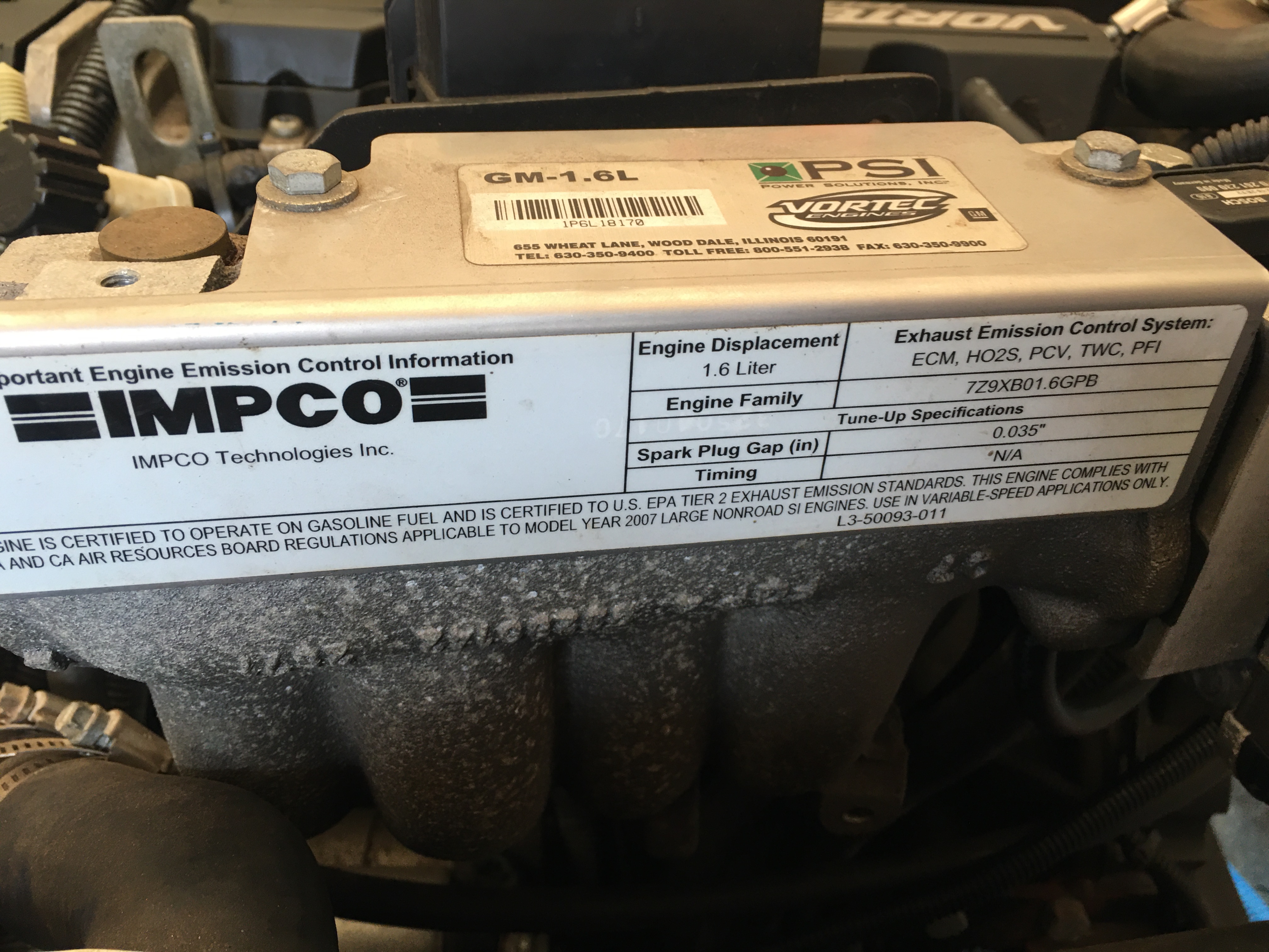

and from a gm 1.6 manual
The Engine Control Module (ECM) receives information from various engine sensors in order to control the operation of the fuel injectors. The electric fuel pump, prevents fuel flow unless the engine is cranking or running. During key on, electric fuel pump receives a two (2) second prime pulse from the ECM which allows Gasoline to flow from the tank through fuel filter and fuel lines to the fuel rails where the pressure is regulated. With Ignition “ON” and fuel pump running pressure should be 284- 325 kPa (41-47 psi). When the engine is idling, manifold pressure is low (high vacuum) and is applied to the pressure regulator diaphragm. Vacuum will offset the spring pressure and result in very low fuel pressure. Fuel pressures at idle will vary somewhat depending on barometric pressure but, should be less then pump pressure.

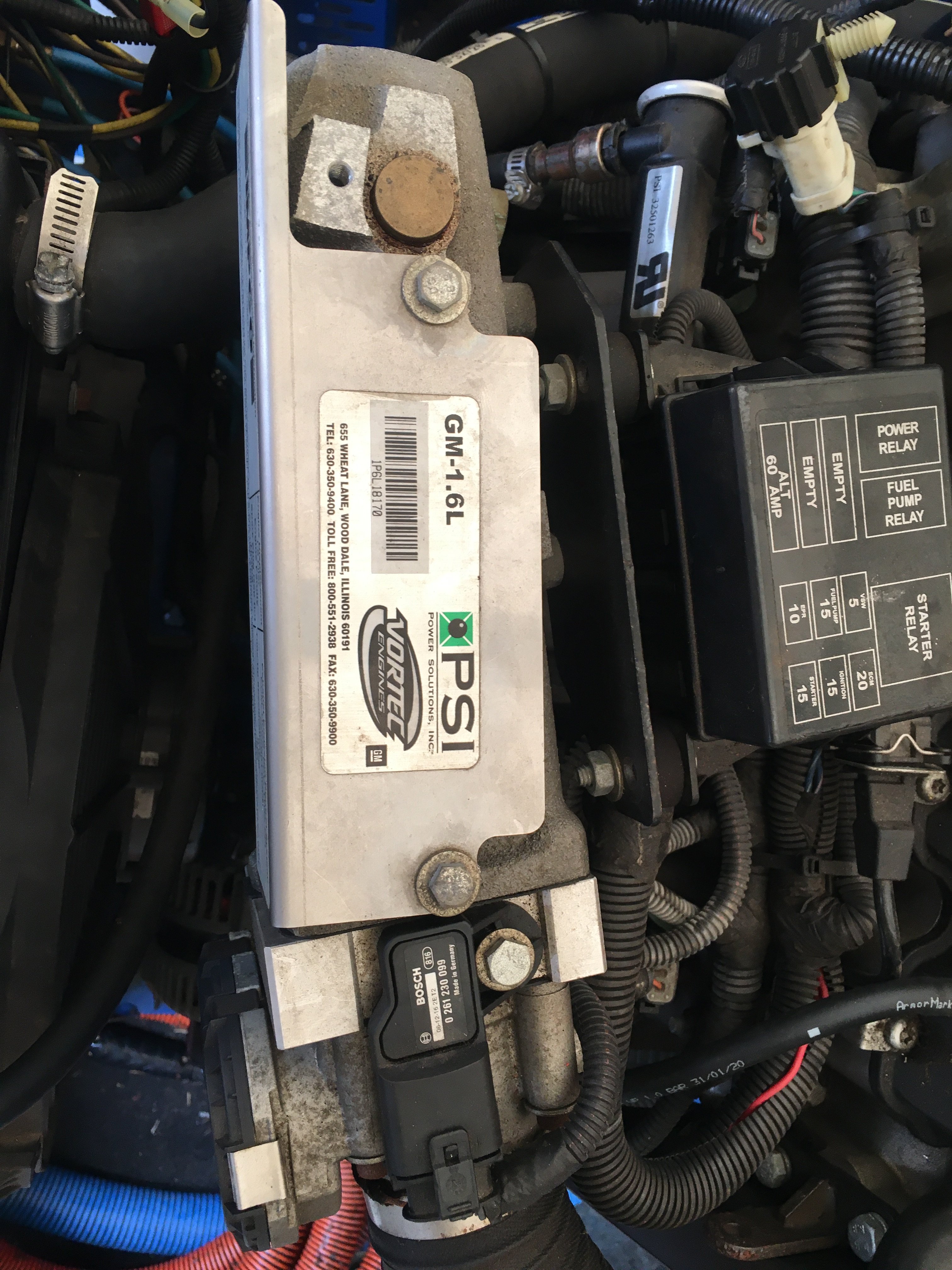

It’s the MAP sensor I replaced yesterday. It’s called a FPR in the manual but is a MAP at the auto parts store.

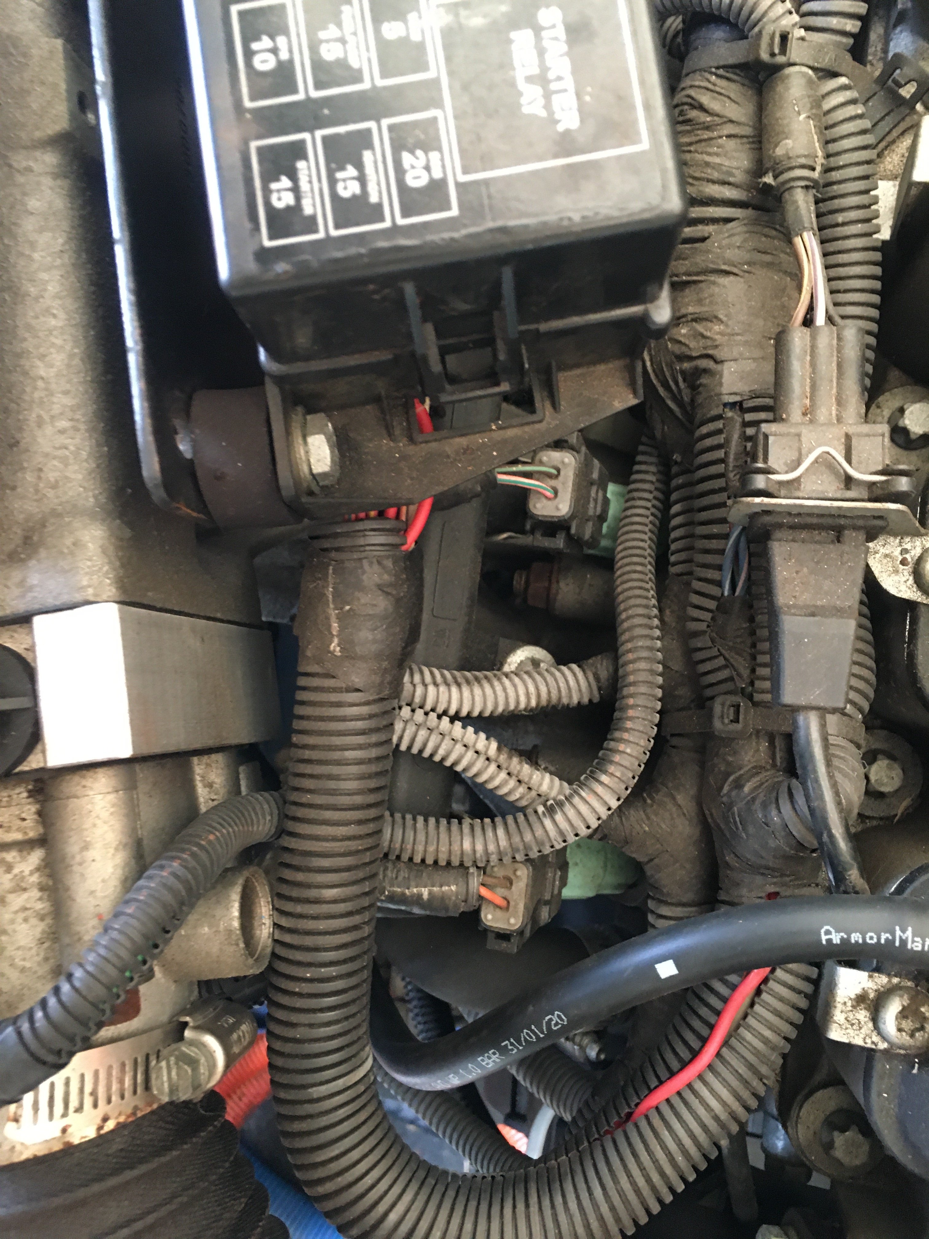

The voltage readings came out normal on the sensor on the fuel rail. I don’t see a regulator on the injectors.
And there is no Shrader on the fuel rail assembly
Reactions: FB19087

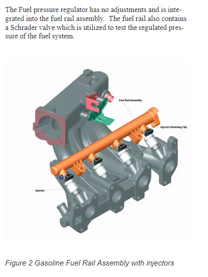

but that may be talking about the type where the FPR is on a tubing rail and not applicable here
like so
14,094
have you tried calling PSI
like so

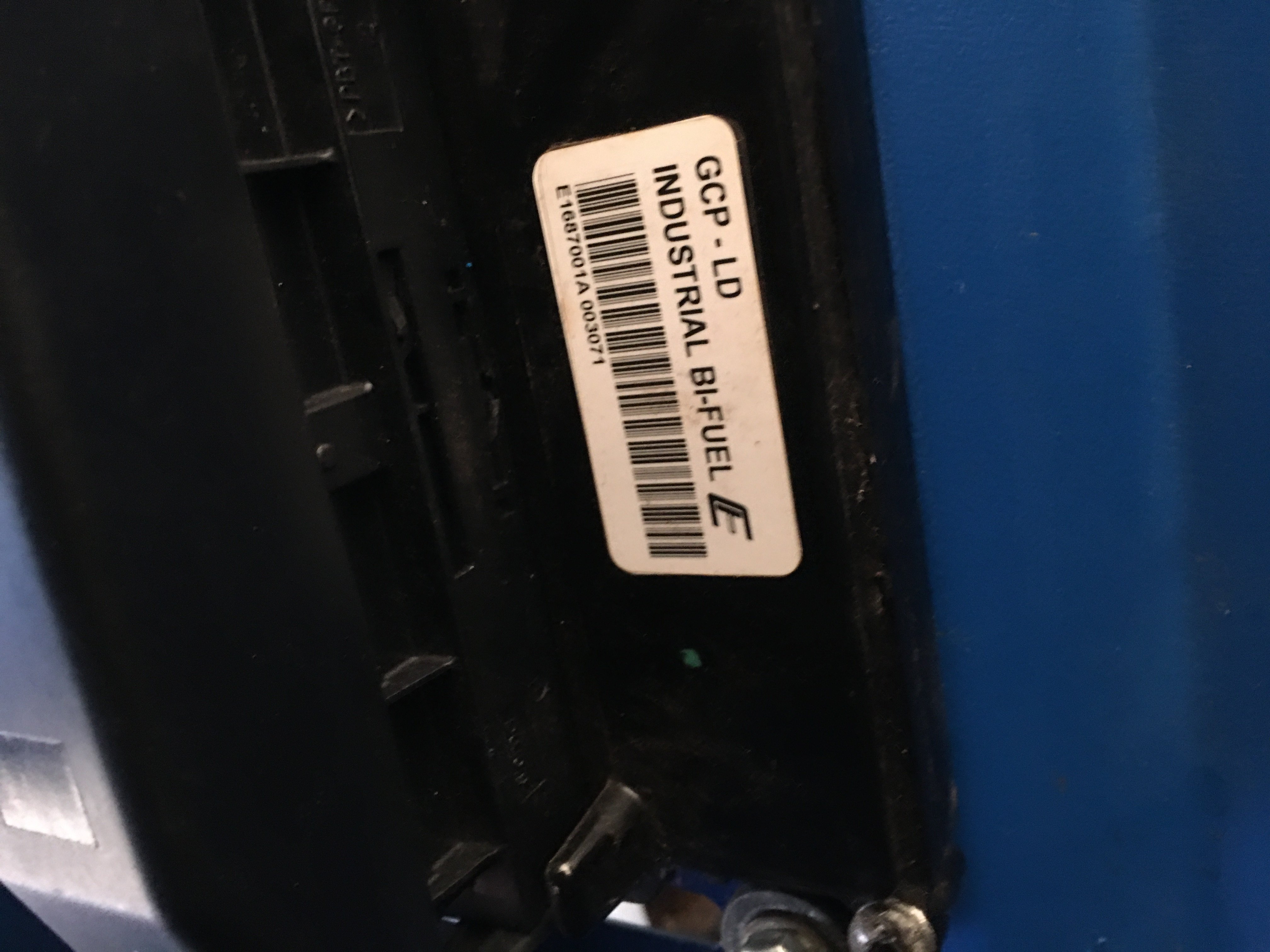

Yeah it probably is, but it doesn’t apply to mine. I’m just gonna gamble on it and hope this ECU fixes it. It runs rough on the hot days anyway so I was thinking the ecu is damaged from where it was located for 2k hrs before I relocated it
