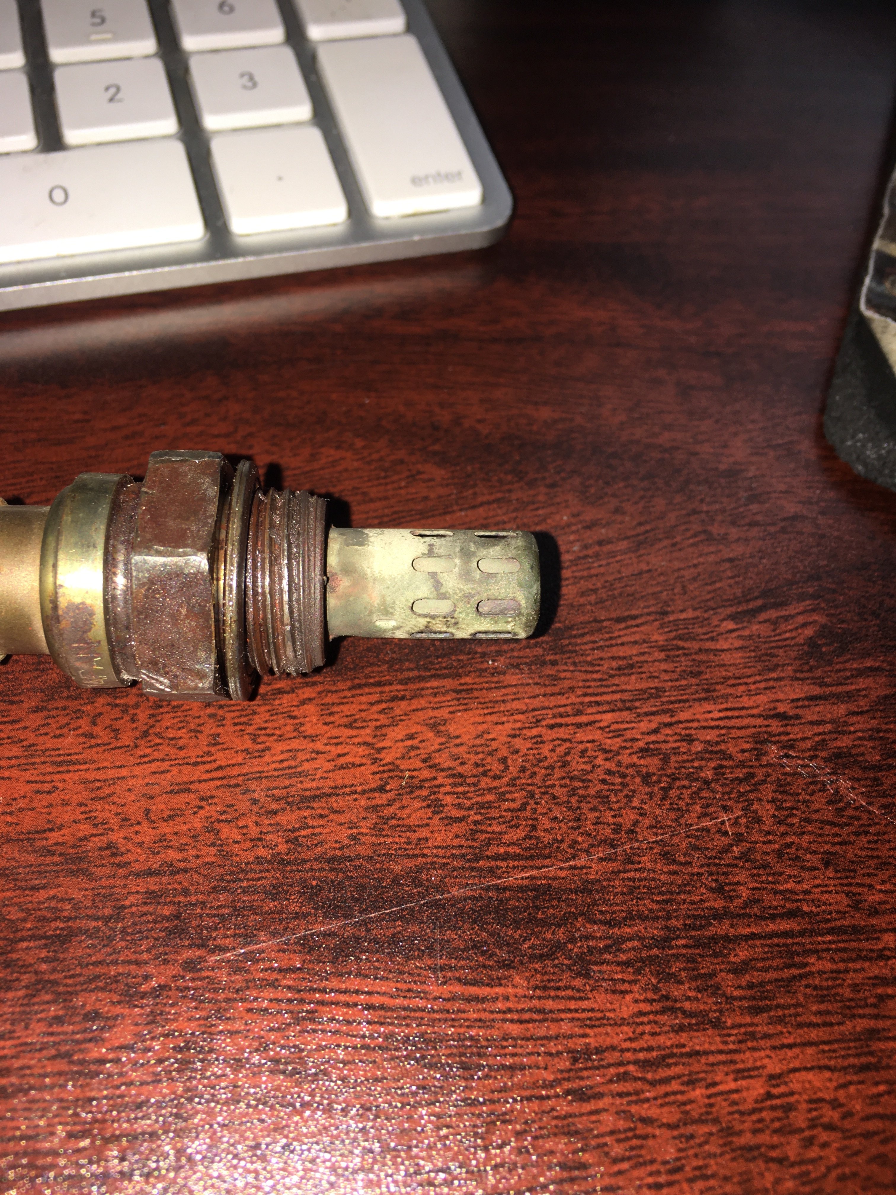

that o2 sensor, at least from the pic, looks like coolant has been entering the combustion chamber....
head gasket is probably the best-case scenario for that. I guess it could have been replaced before and the O2 sensor not
