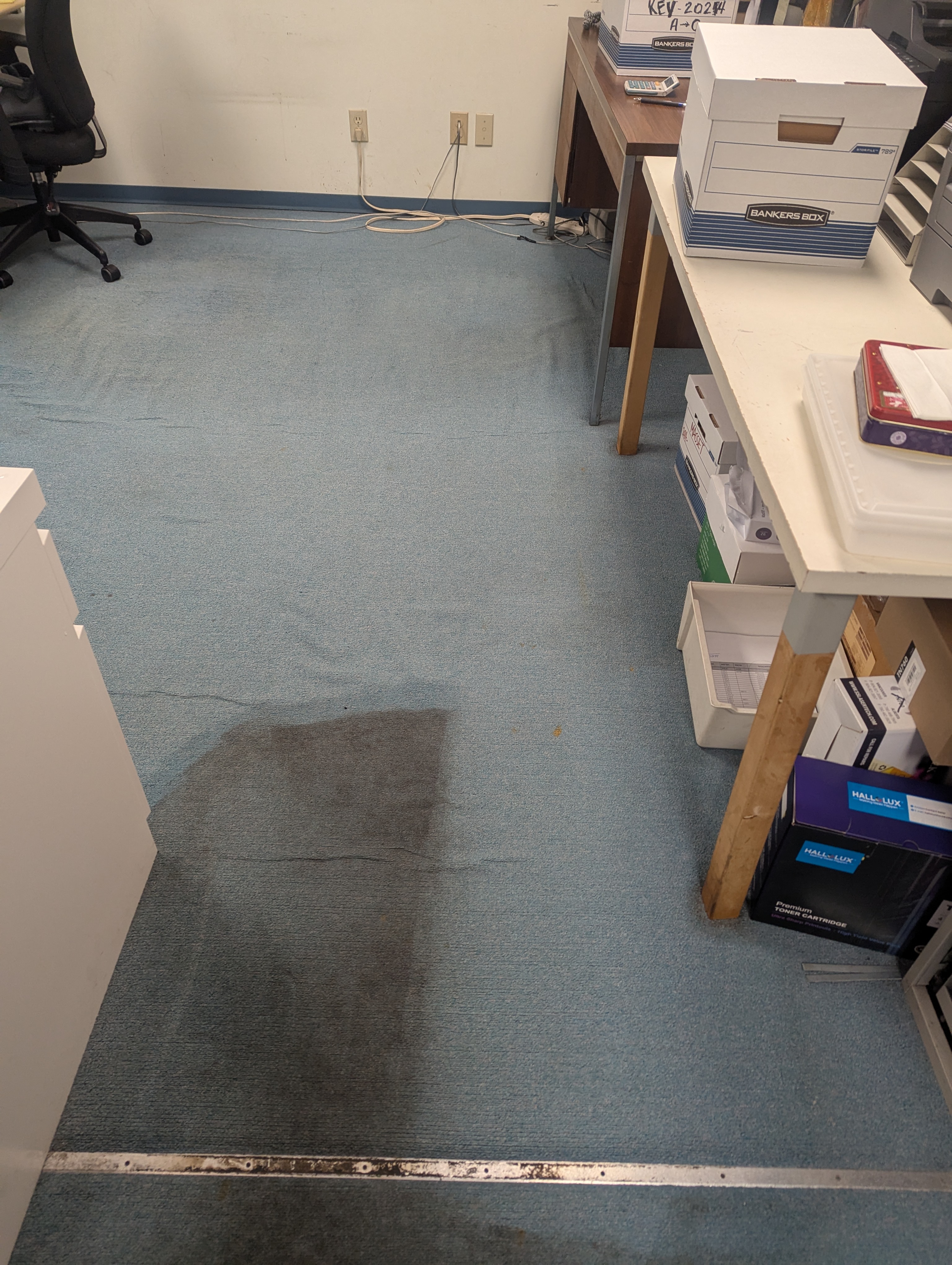

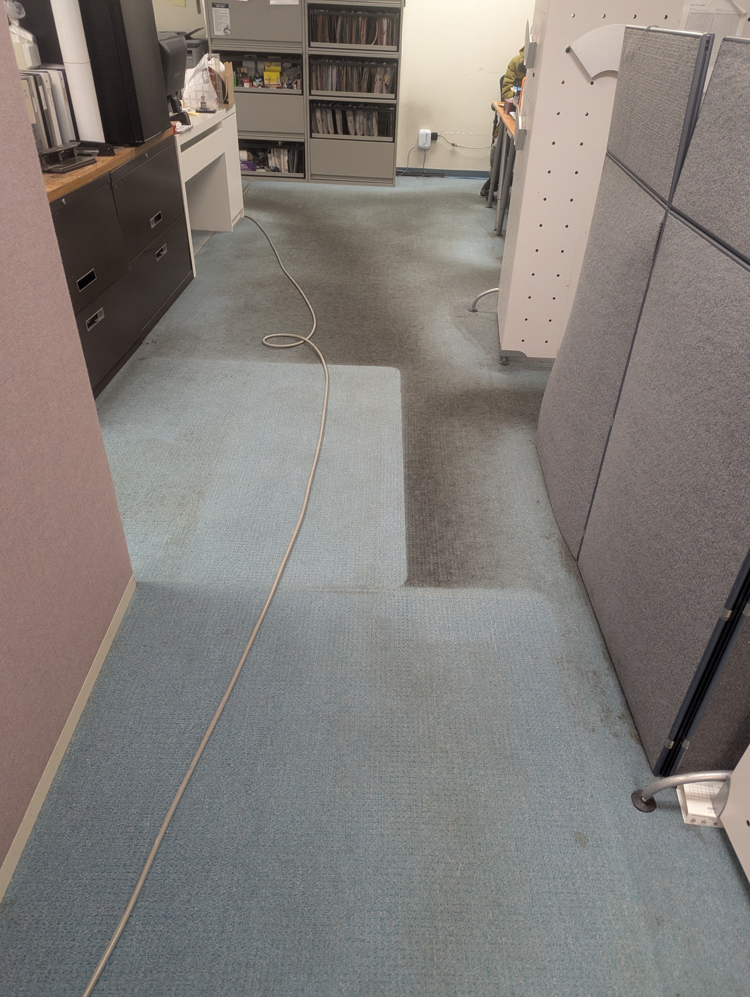

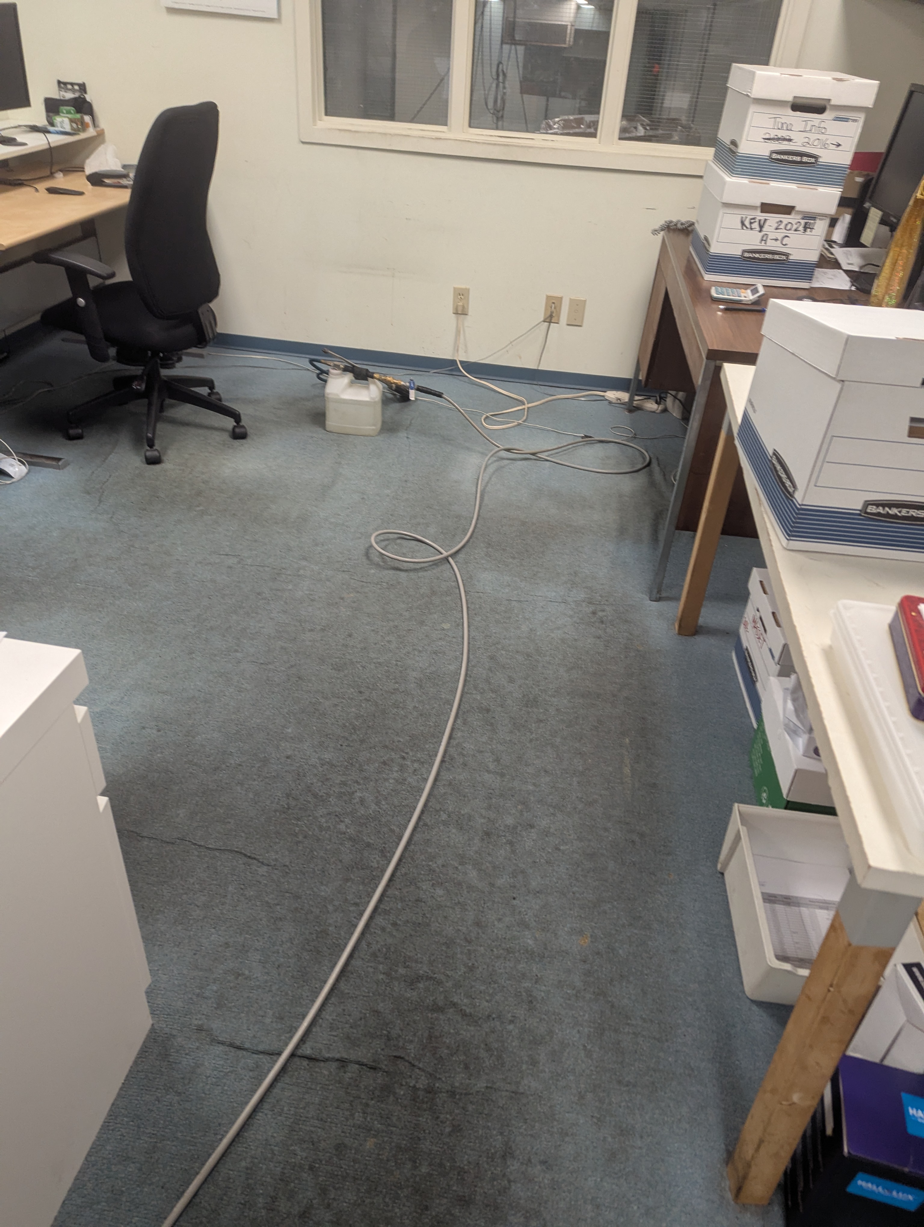

Here is the job I mentioned. Didn't have any hope of really improving it and let them know the carpet needed replacement rather than cleaning. Used Harvard's Citra-zov spraying with a 4-1 in-line sprayer and rinsing with Procyon plus powder. Prochem Apex. Had 5 Chinese ladies oohing and aahing over how well it came up.
PXL_20241230_164158490.jpg PXL_20241230_164205356.jpg PXL_20241230_165706919.jpg PXL_20241230_171316689.jpg
