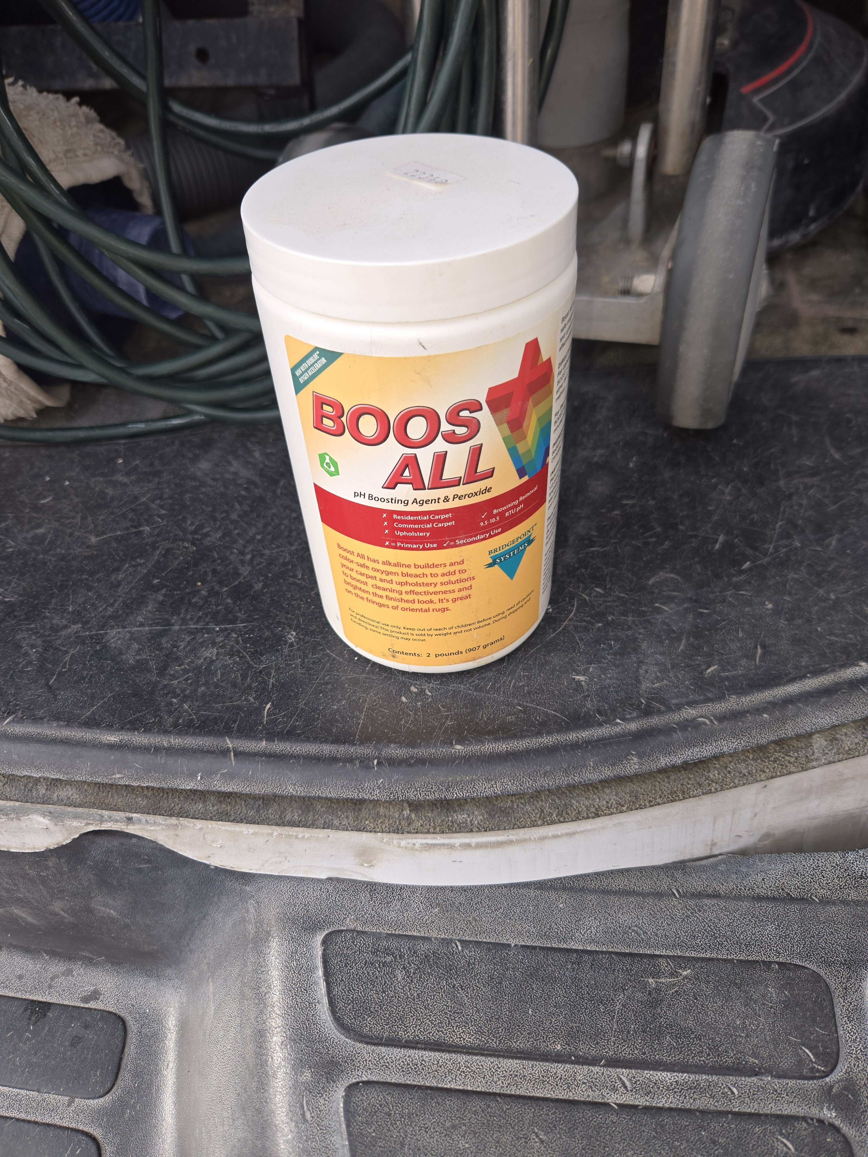

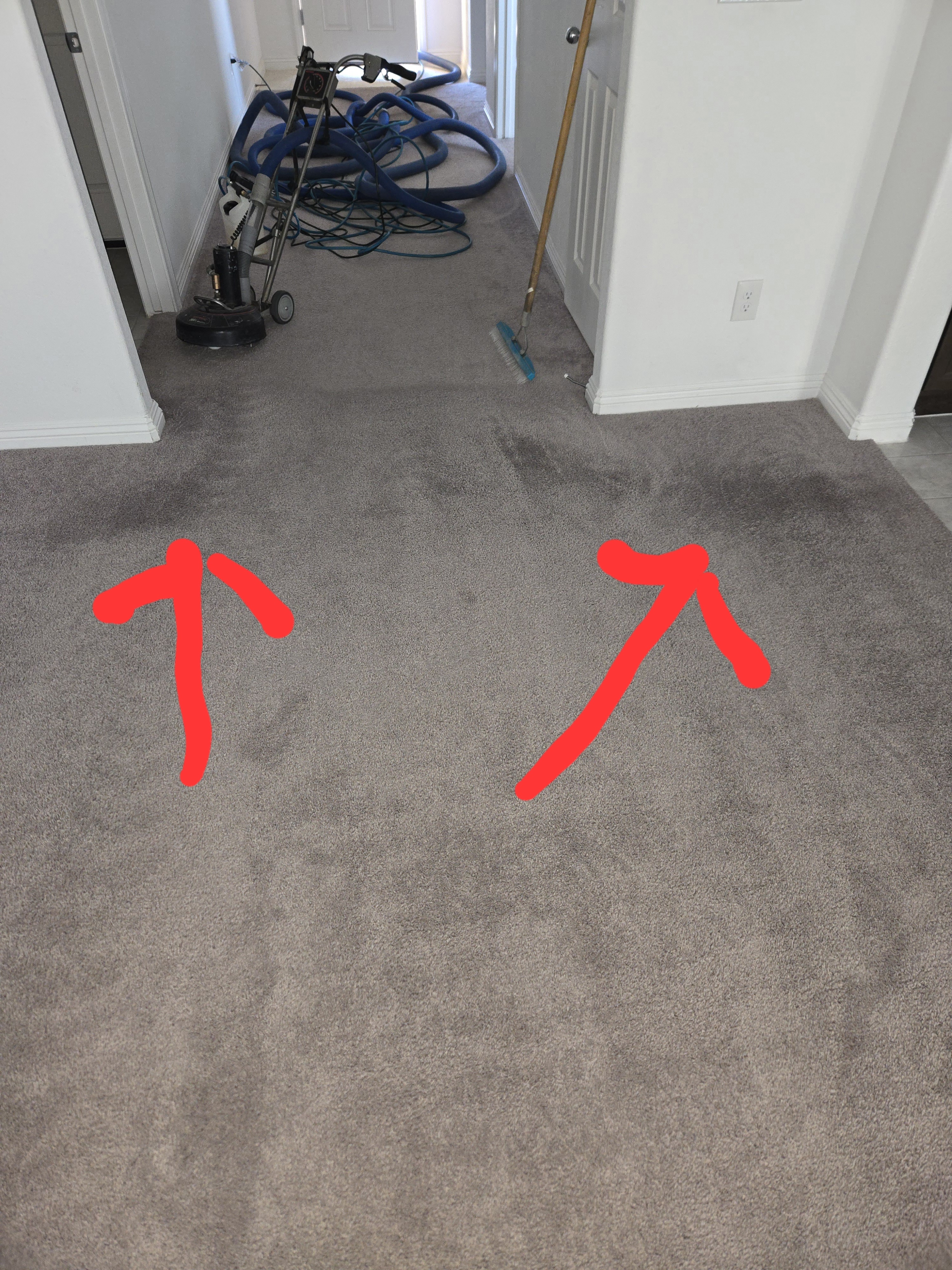

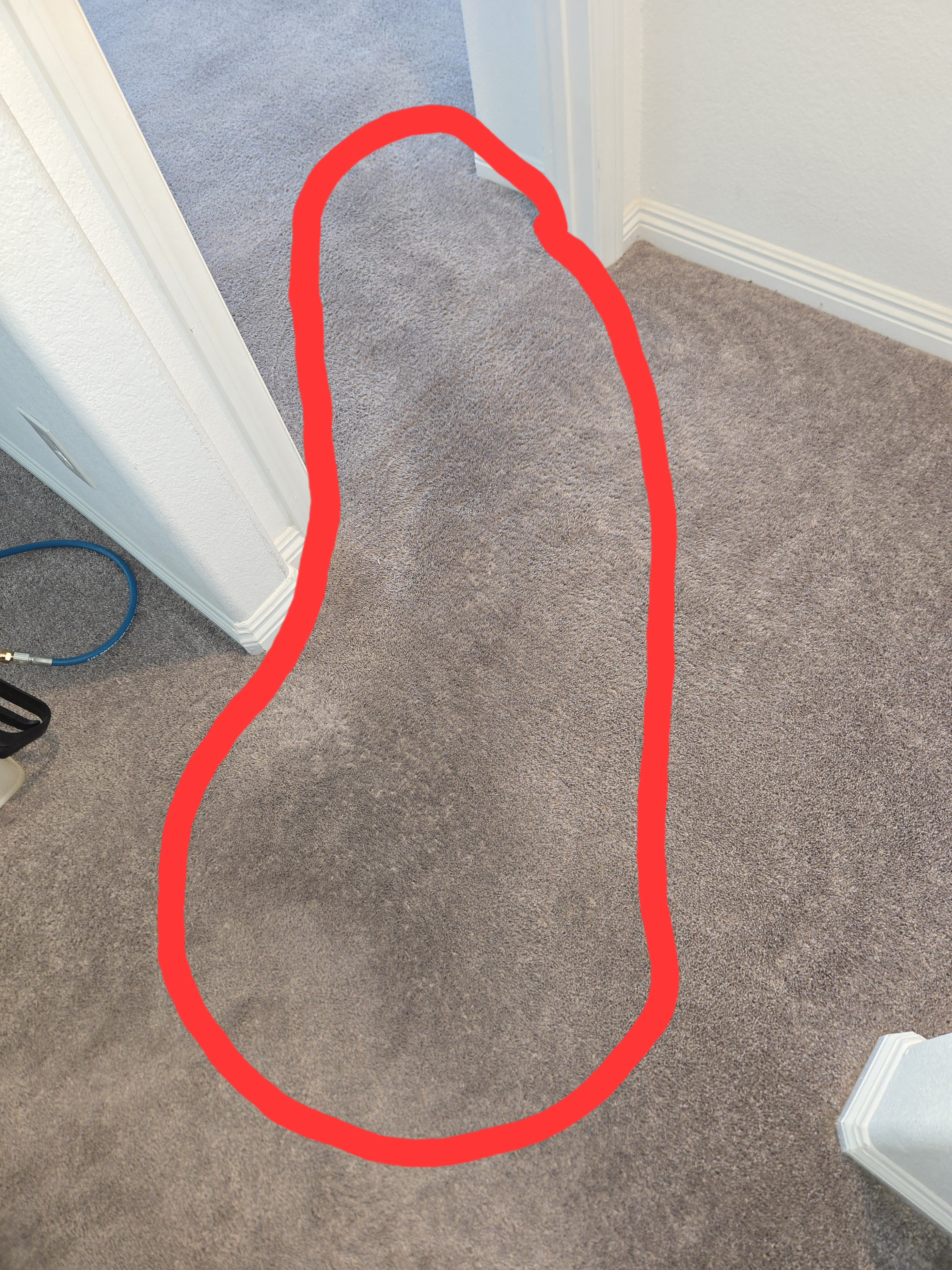

This looks like crap, all these housing tracks in my town have this crappy polyester carpet, a customer showed me a carpet upgrade and it was just a thicker polyester. 🙄 Has anyone used "Boost All"? My former Aramsco rep. told me to use it? I haven't yet...(I think it's just wearing and shading different.)

I would say about 10 years? Usually works great for me, I use a little Prochem Power Solvent for tough spots, but normally Flex, RotoVac 360i standard 3 jet head, brush head if it's really soiled, 400-500 psi, and full heat on the Prochem Apex...it's just these 2 housing tracks with polyester that I'm unable to get these dark pathways to blend? Nothing I try on it does anything? Thinking the fiber is just breaking down and I'm seeing wear shading? 🤷‍♂️ Just frustrating because it looks like I left it dirty....

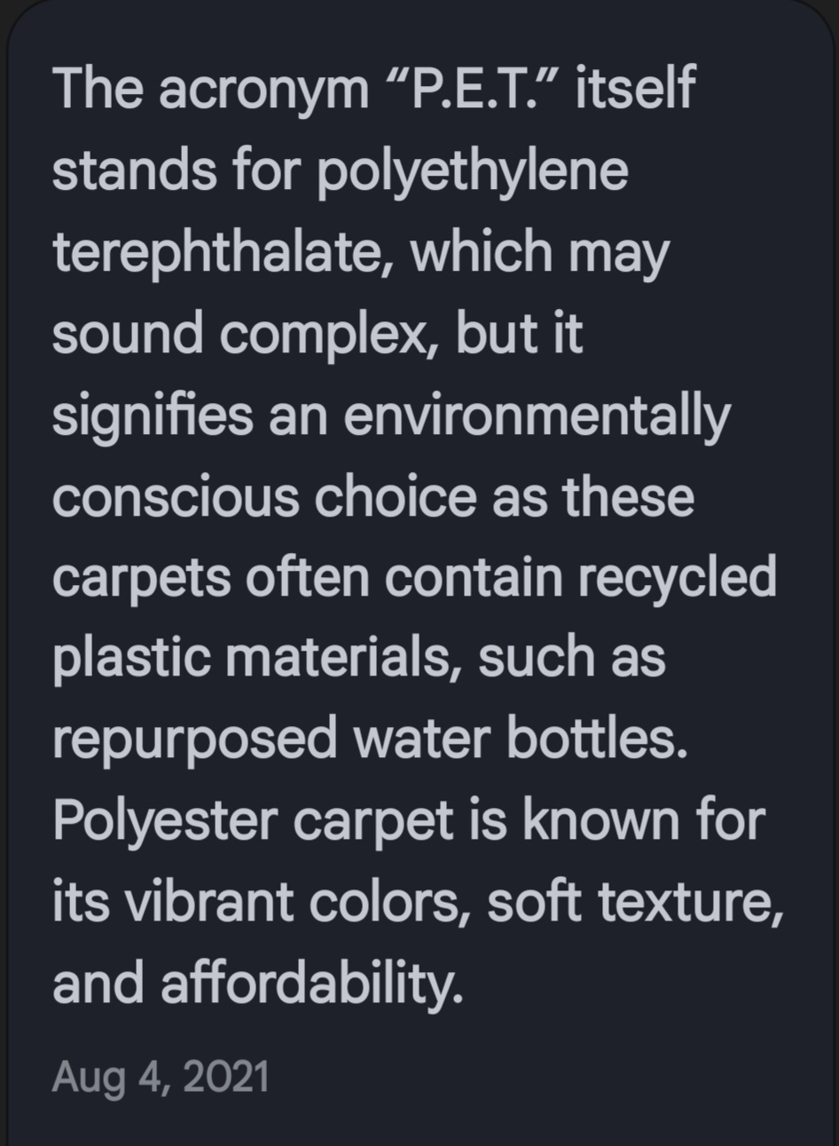

This polyester carpet is a good option for the homebuilder, as it's cheaper in price, but since the carpet is made from recycled plastic, it's not holding up very well. I remember my teacher at my IICRC class telling us not to purchase "Green Products". I'd say don't purchase green, recycled carpet either....

Most likey, it’s not a prespray issue. There’s a thousand good prespray products and he’s probably already using one. In my experience, if a Rotovac with a brush head doesn’t solve the issue, then it’s time to replace the carpet.

To your question about Boost All
It will help a bit, as will similar Sodium Percarbonate products.
The biggest problem you have there is the damage to the fibers, which no magic prespray solution (Marty/Hogjowl said it well) can change.
