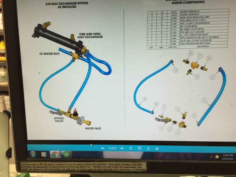

11,567
The SS unit dumps a lot, never heard that about the 650.
After they added a fix to the 570 it doesn't dump hardly at all.
I don't know if they did that with the 870 or not?

Hmm somebody was just telling me about something they recently did to the 870 to prevent it from bypassing so much but I think my brain was in overload mode as I can't remember what it was.
