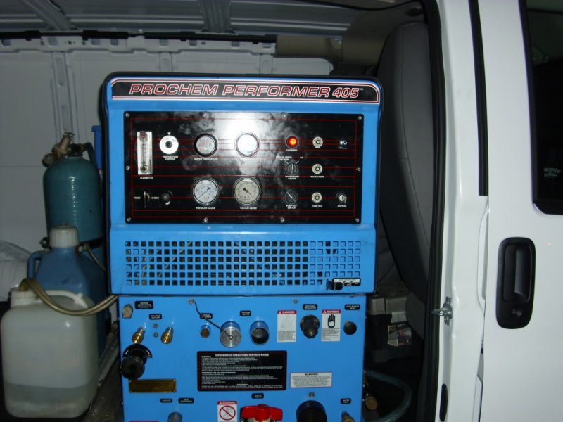

The 405 I'm getting rid of has 6700 hours on it and I got it with 650 hours.
It runs great, but that machine is probably 15-16 years old.
I got it in 2011 and it was beast.

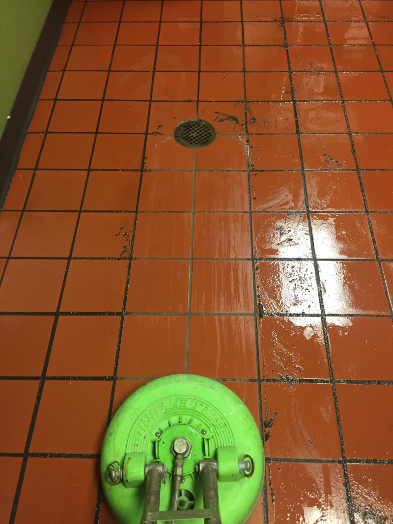

So I use the 870 for hard surface a ton. IF you do a high percentage of hard surface cleaning ,you will love the extra psi of hot water. But if you do primary residential T&G, 1000 is all you ever need. I only use the higher psi (above 1500) on nasty kitchen tile and sidewalks.
With employees it's kinda scary that with a couple of cranks on the regulator they could be blasting grout out with ease at 2500 psi.
I don't think the 870 is a replacement for even the smaller of the fuel fired pressure washing units. Honestly when ived cleaned sidewalks or other pressure washing jobs I make really lame money. But when it comes to those absolutely destroyed kitchen tile jobs. It is amazing. IF you charge enough.

View attachment 70272 So I use the 870 for hard surface a ton. IF you do a high percentage of hard surface cleaning ,you will love the extra psi of hot water. But if you do primary residential T&G, 1000 is all you ever need. I only use the higher psi (above 1500) on nasty kitchen tile and sidewalks.
