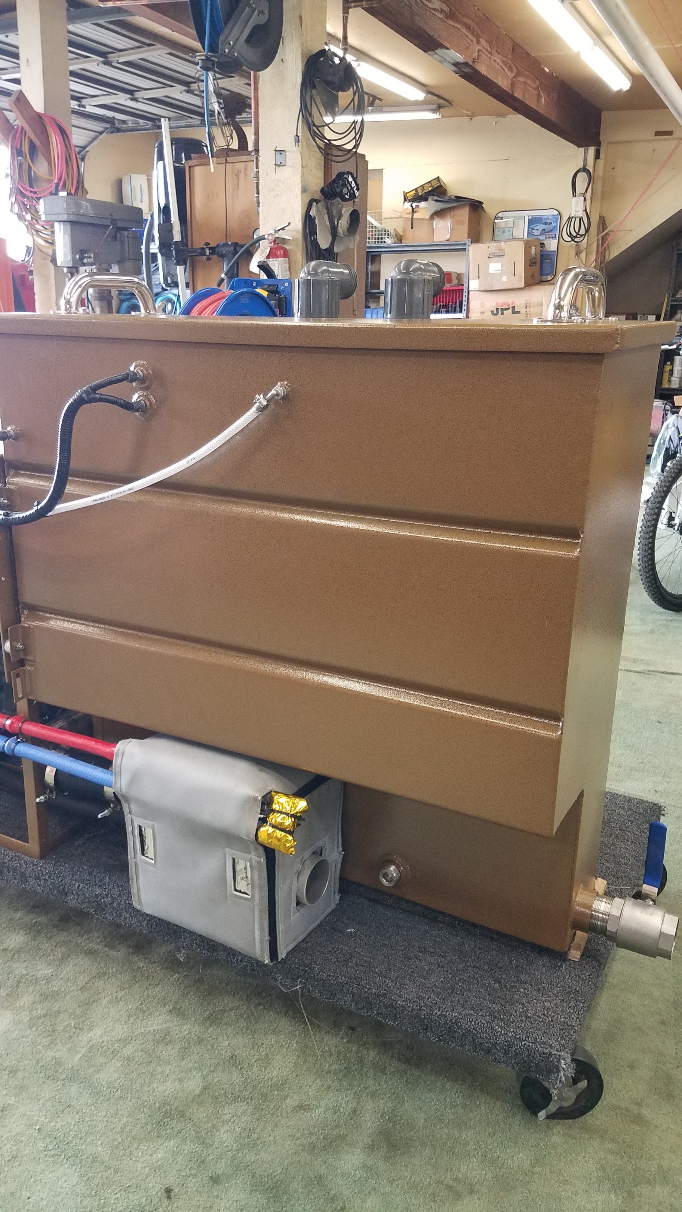

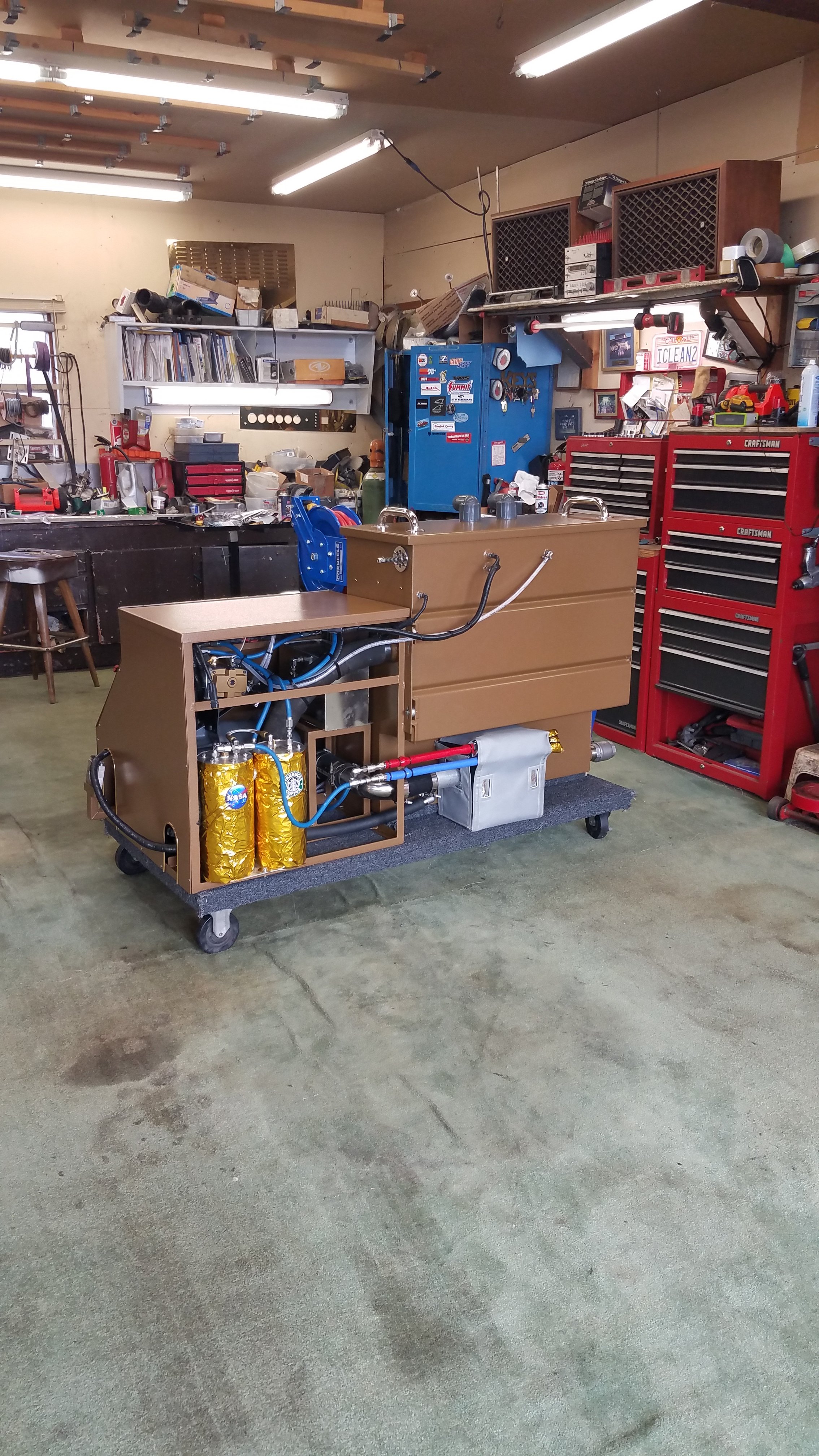

I’m taking it to the forklift later this week to move it. Rubber mats underneath are getting pulled up.
The waste tank was behind it but I think I’m gonna move it to the left side of the machine for better mounting space and ease of access to the rear and right side of the machine.
The van needs a power steering fluid reservoir, a tuneup, and a new rear door
As for the tm, the water pump needs tlc, and the 185f thermal relief valve needs replaced. 🤞. Once I get it completed, we’ll see what other issues it might have

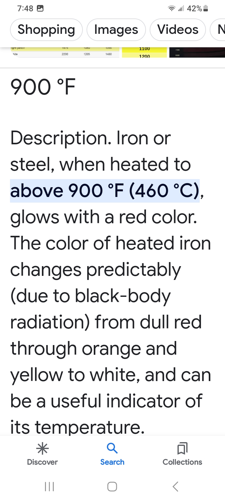

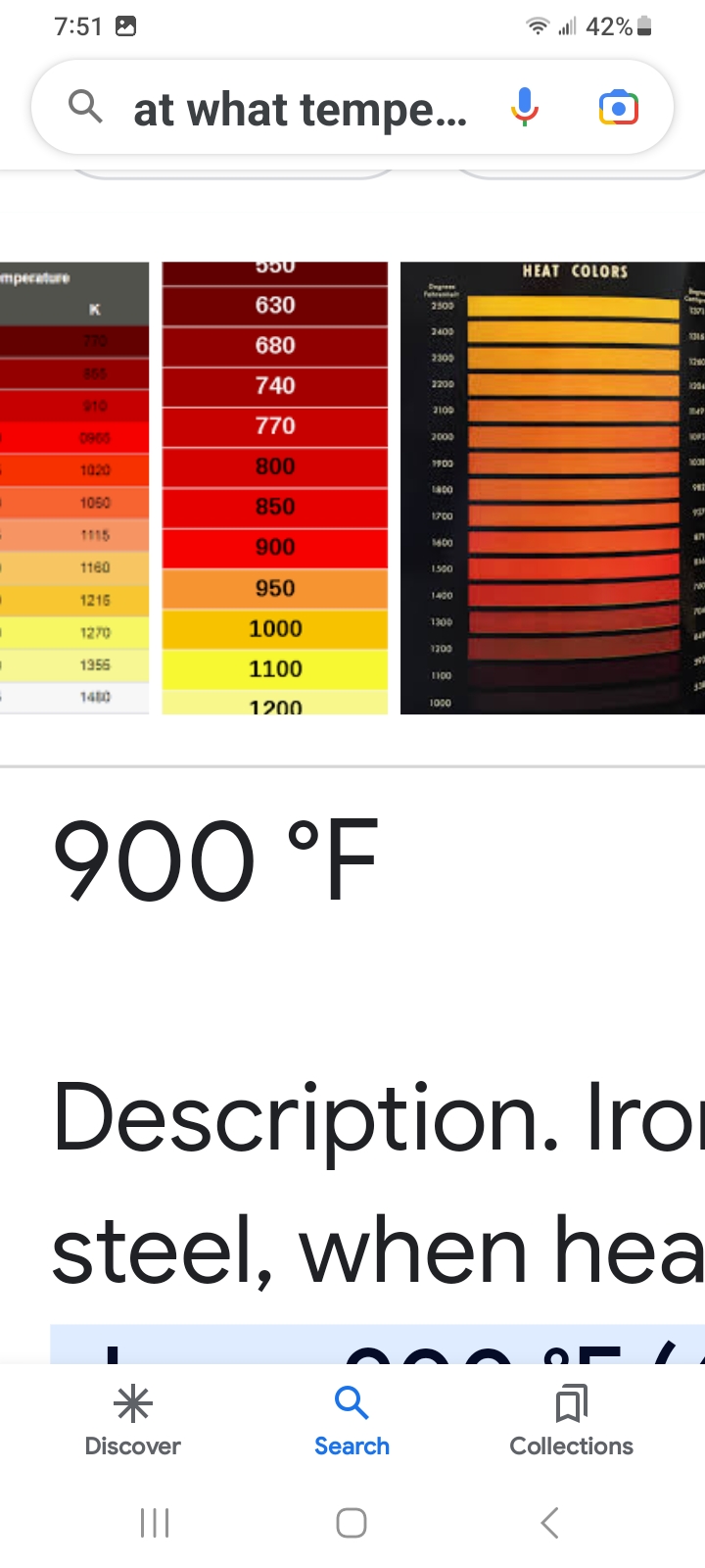

I only saw the mustangs headers when it was under load on a dino and the vans exhaust manifolds glowed when i accelerated hard, so under load also .

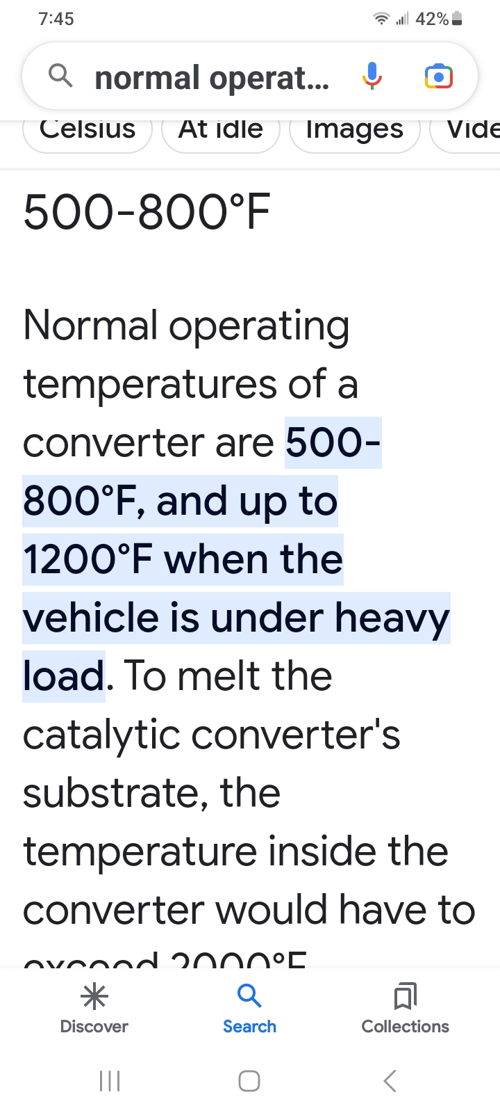

I don't know anything about these carpet cleaner engines i just assumed that under load they would glow also. I just googled normal operating temperatures for catalytic converter
