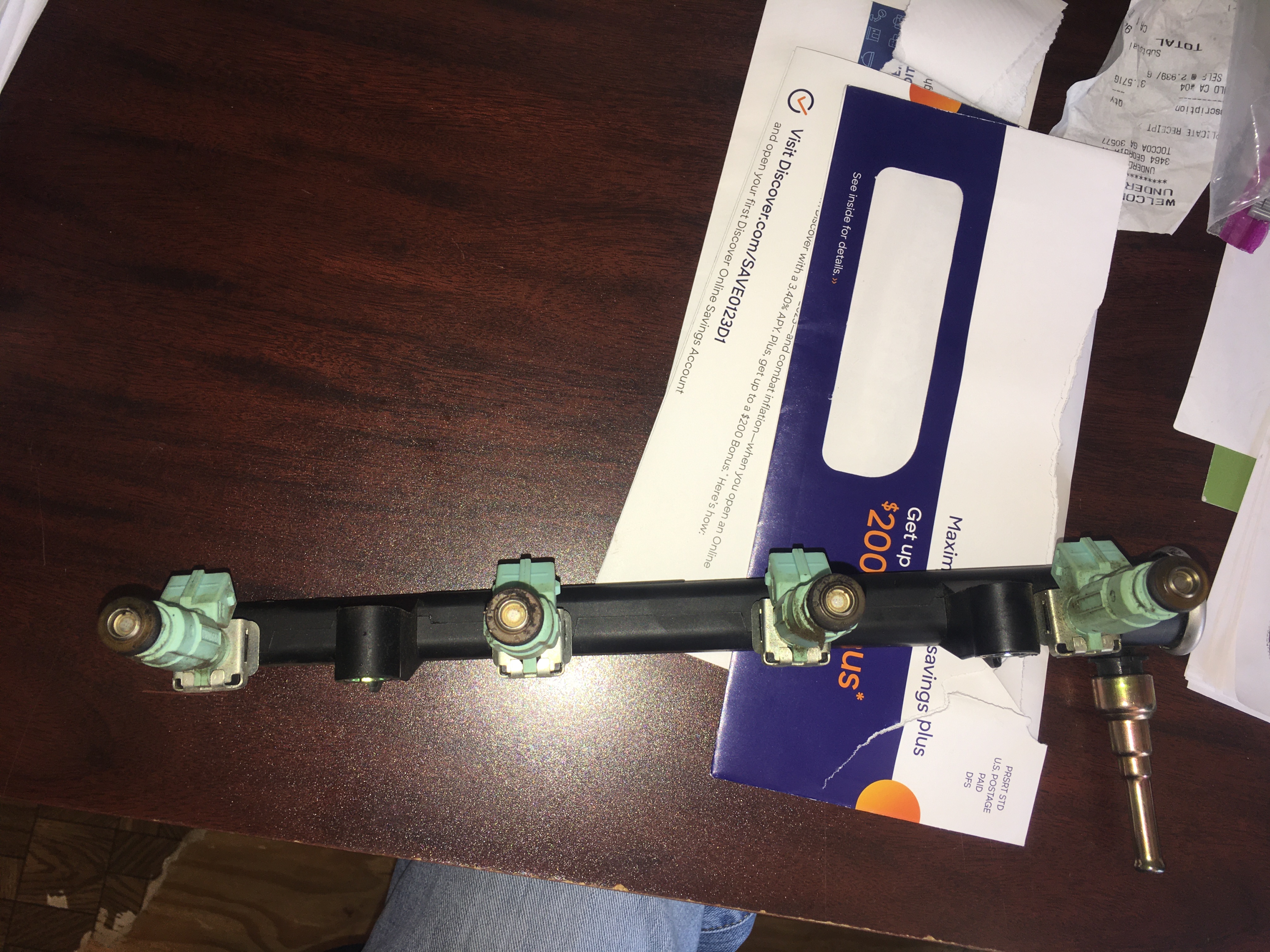

Does this look dirty to you guys? I wasn’t able to test it where it’s located at

Do you know anyone that owns one of theses injector testers? The rubber o'rings look like they should be replaced.
Wtf do you have the fuel rail off now? Did you at least volt/ohm test them? Listen to see if one was acting up?
What’s another 500 I guess

I'm just reading anything that might cause the glow if it's lean fuel burning. I picked up another set for $75. Amazon product
I pulled one out of the fuel rail and noticed some debris inside the rail where it plugs in.

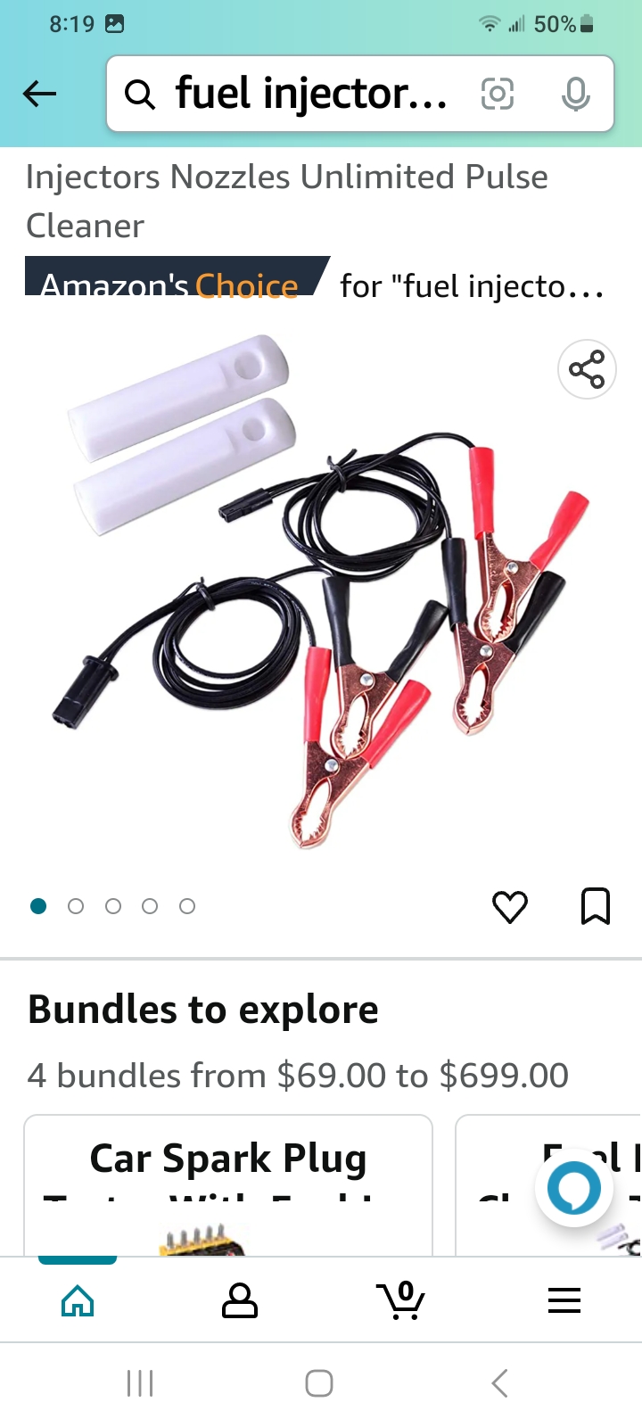

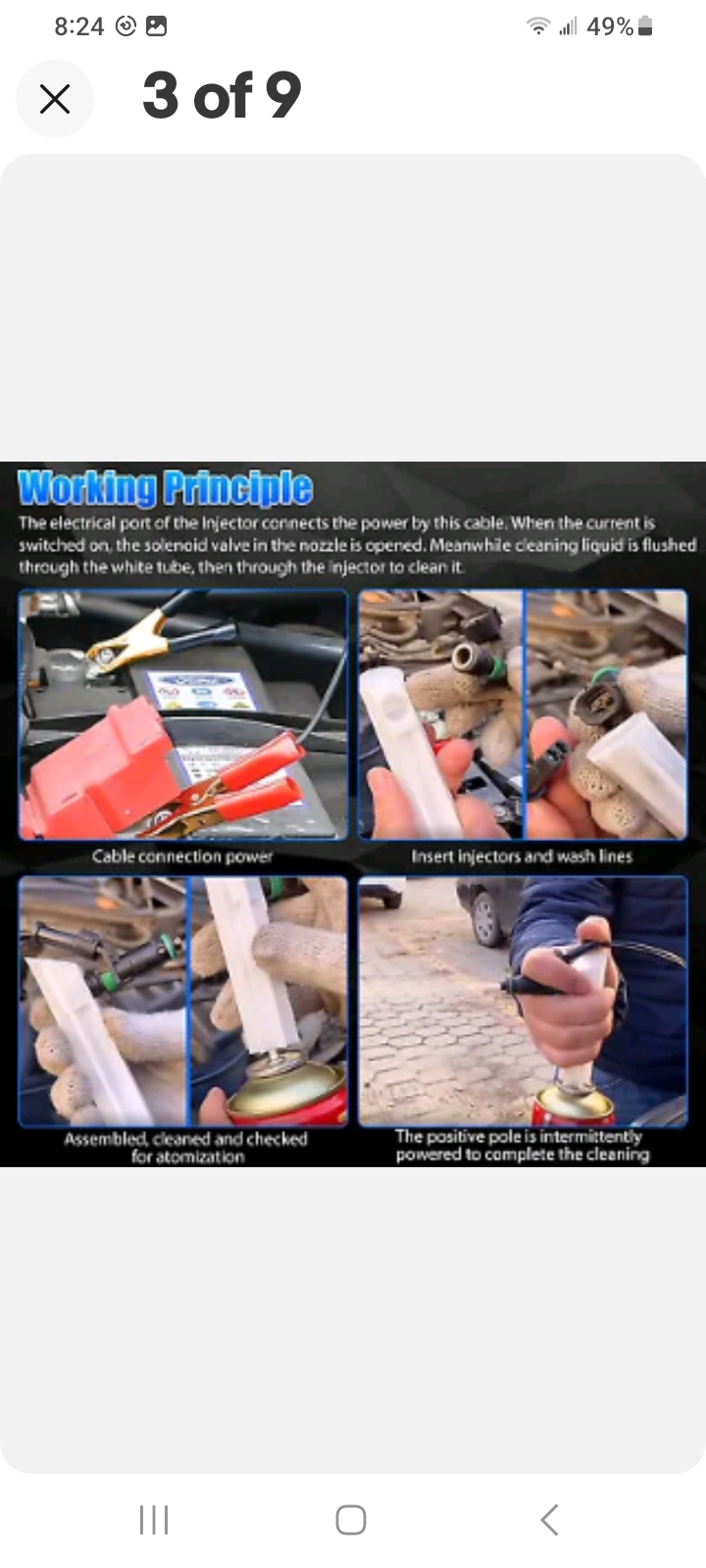

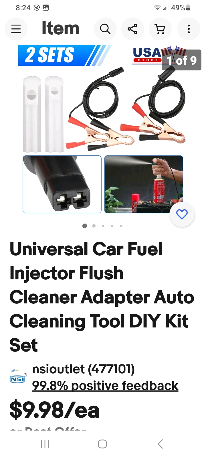

I use this to clean and check spray on injectors. I bought mine on ebay for 10.00 but you can find um on Amazon too
Screenshot_20230305_201938_Amazon Shopping.jpg Screenshot_20230305_202414_eBay.jpg Screenshot_20230305_202427_eBay.jpg
