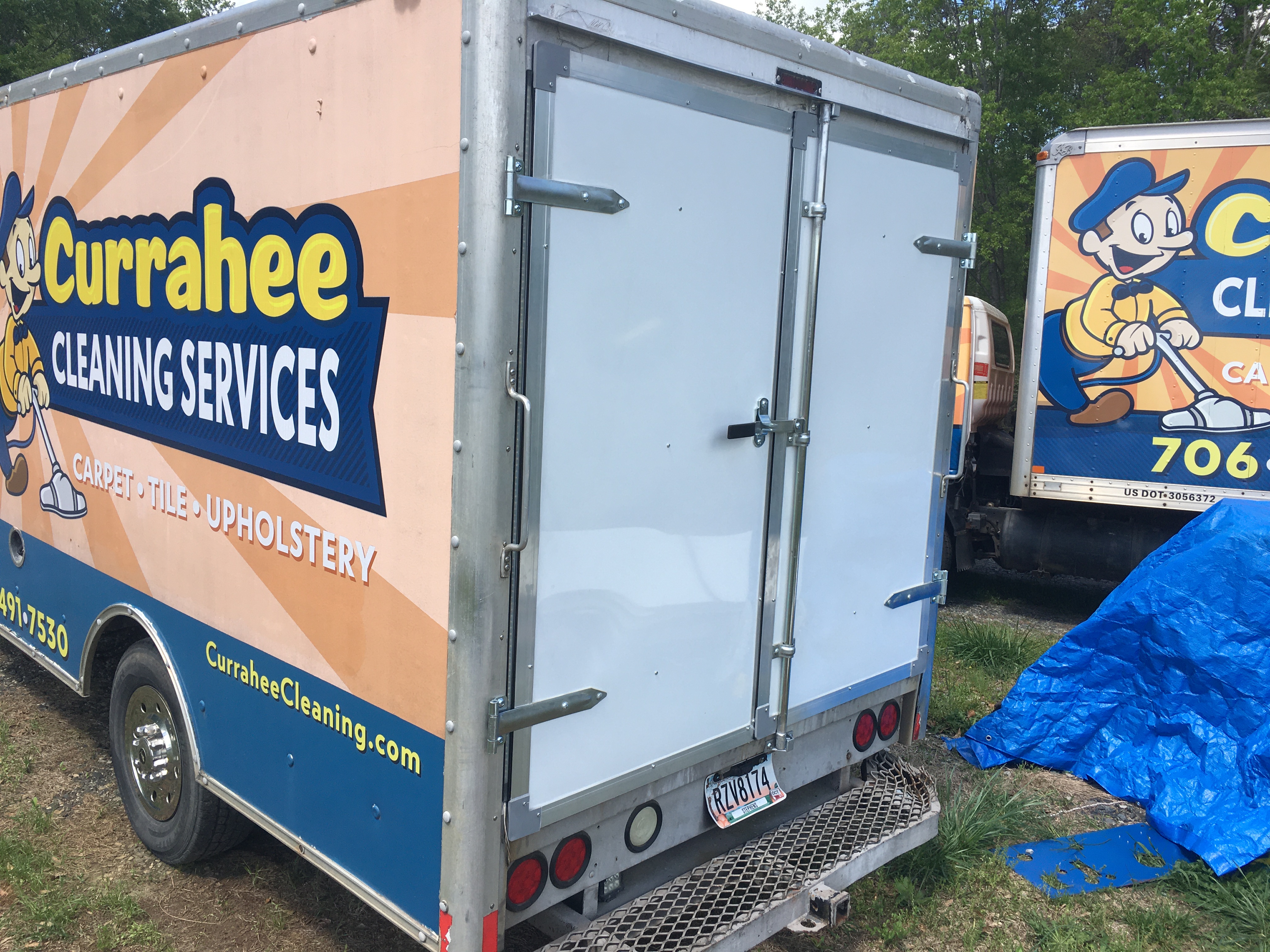

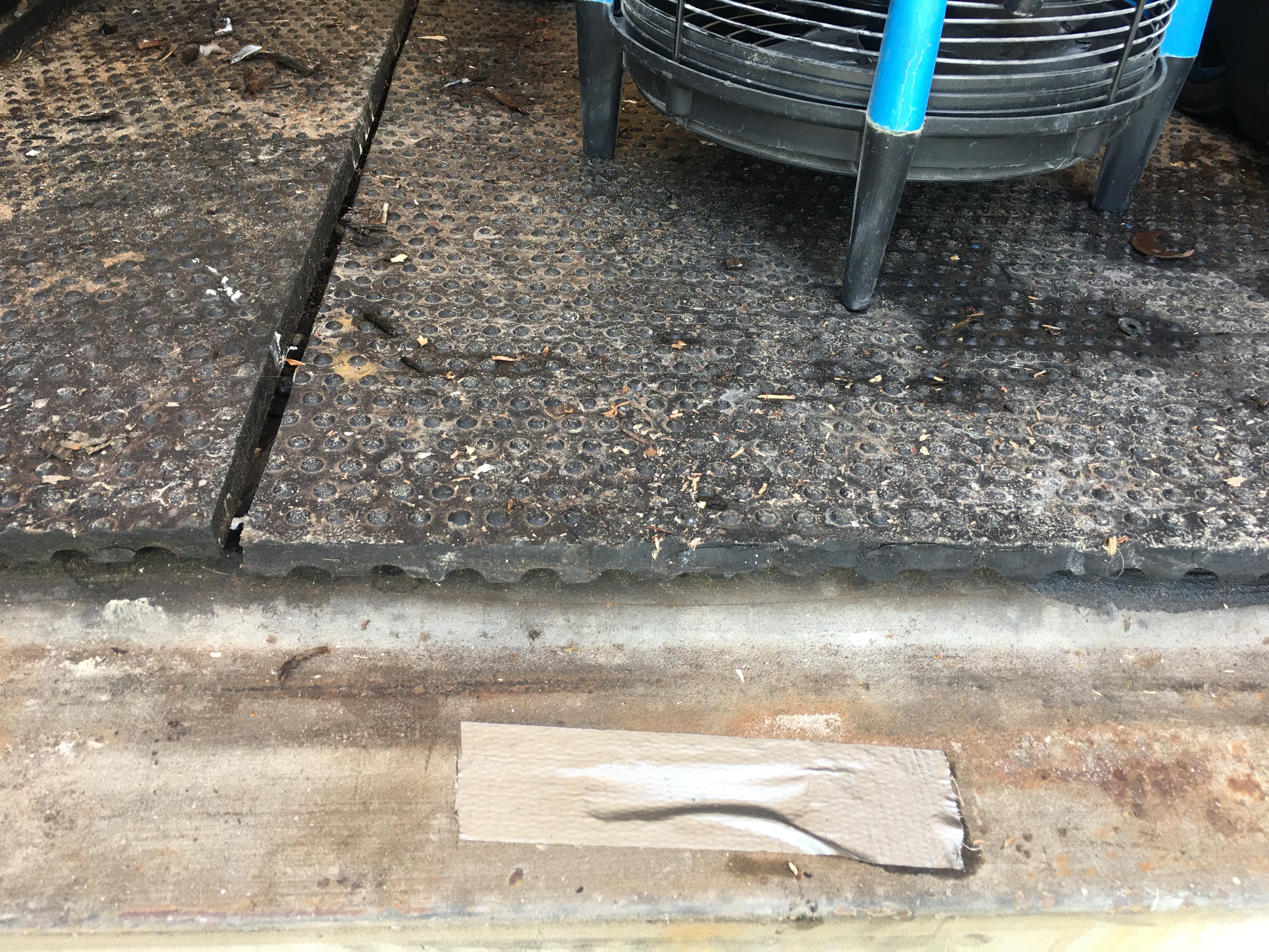

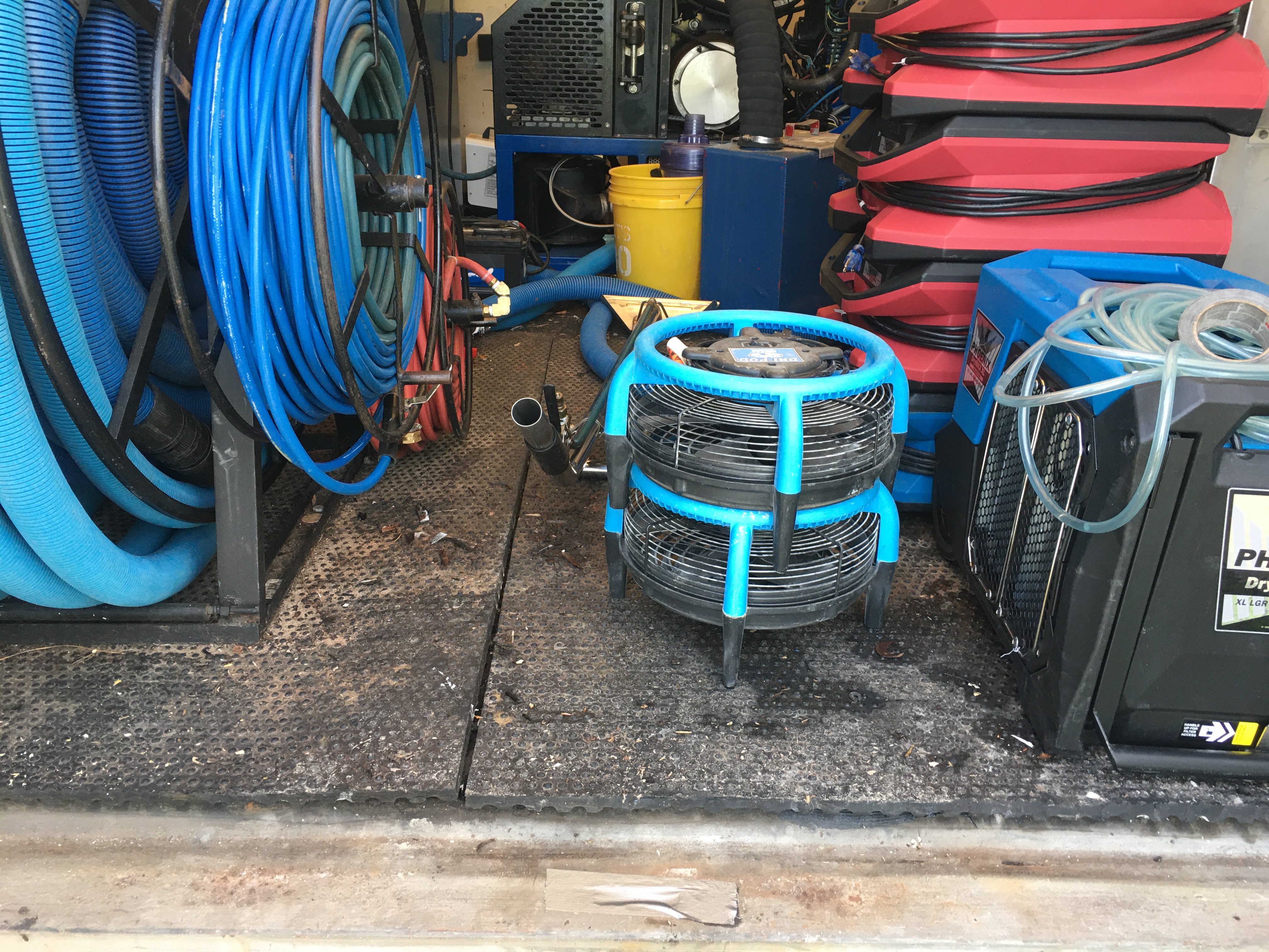

I think I found the cause of the fumes coming in the truck.
Got a new set of doors to replace the rotten roll up door 🤓🥳 on this project.
Next is replacing valve cover gaskets on the van engine.
those doors did help stop the chimney effect from sucking in the exhaust fumes. But I forgot to cover that hole that the door latch for the old roll up doors on the floor. After using some duct tape, the fumes are no longer detected.

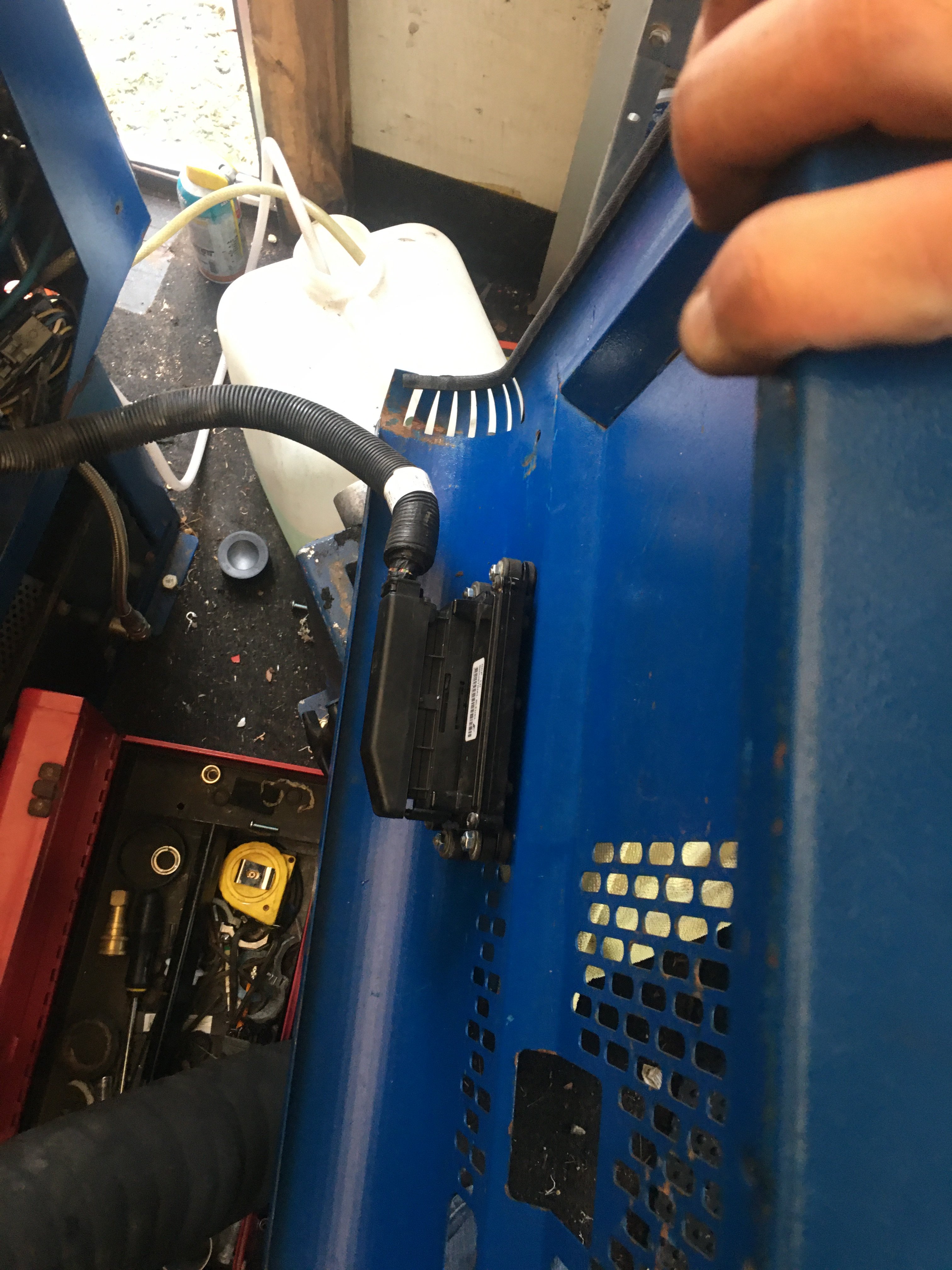

Yall are all some Fookin idiots 😂😂.

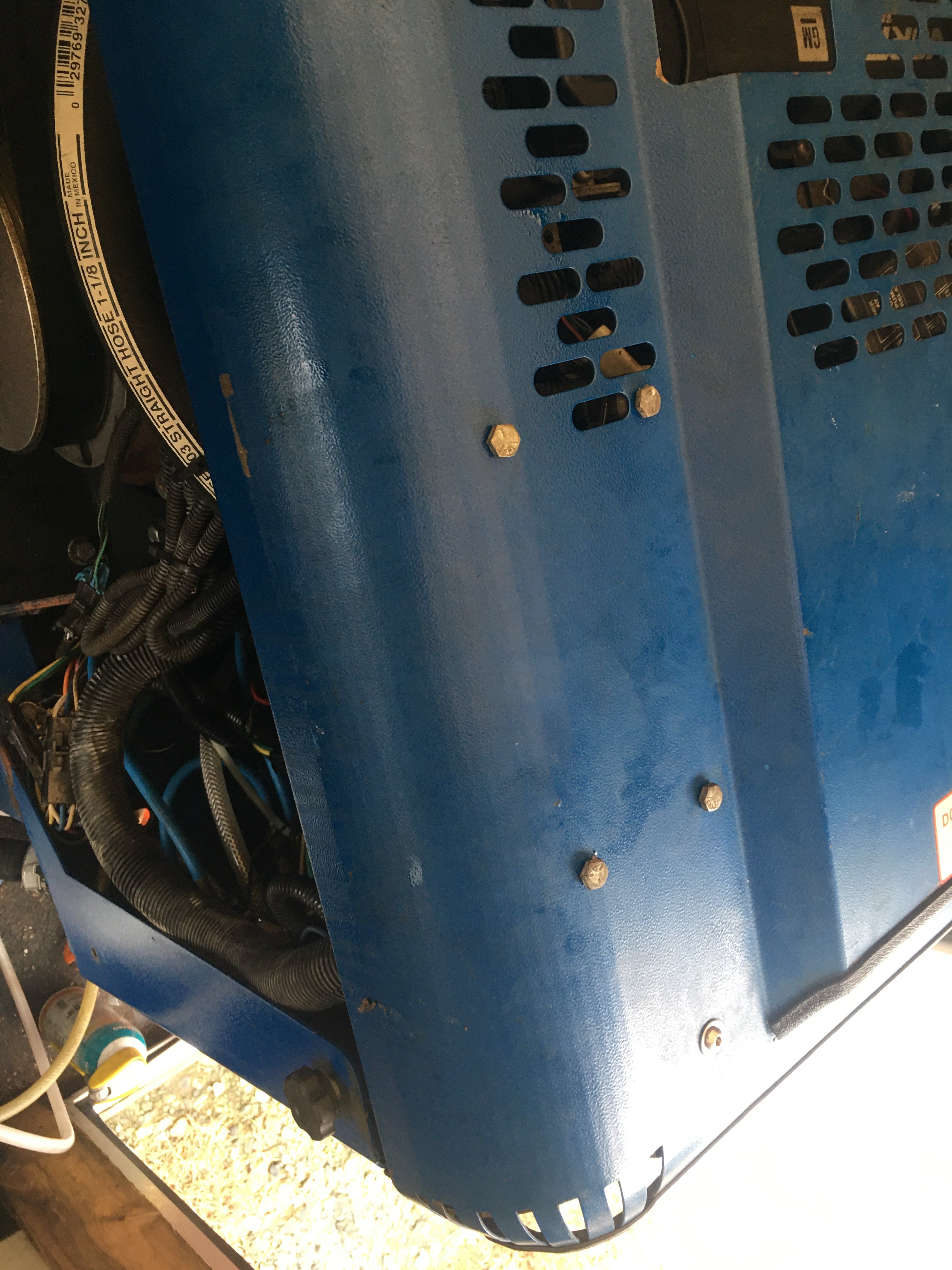

Serious question does that cover not get in the way when you're working on the machine bc the ecu cable is still attached and can't be pulled but so far out of the way? Maybe you disconnect it each time? Also mine sounds like crap at idle compared to yours currently lol
The cable isn't in the way. Just reroute it with some zip ties and you're good. But since your model is over 7k hrs, you shouldn't need to relocate it since it held up that long.
I don't think it needs to be relocated anyway, because the problems of what I think were the cause got fixed
