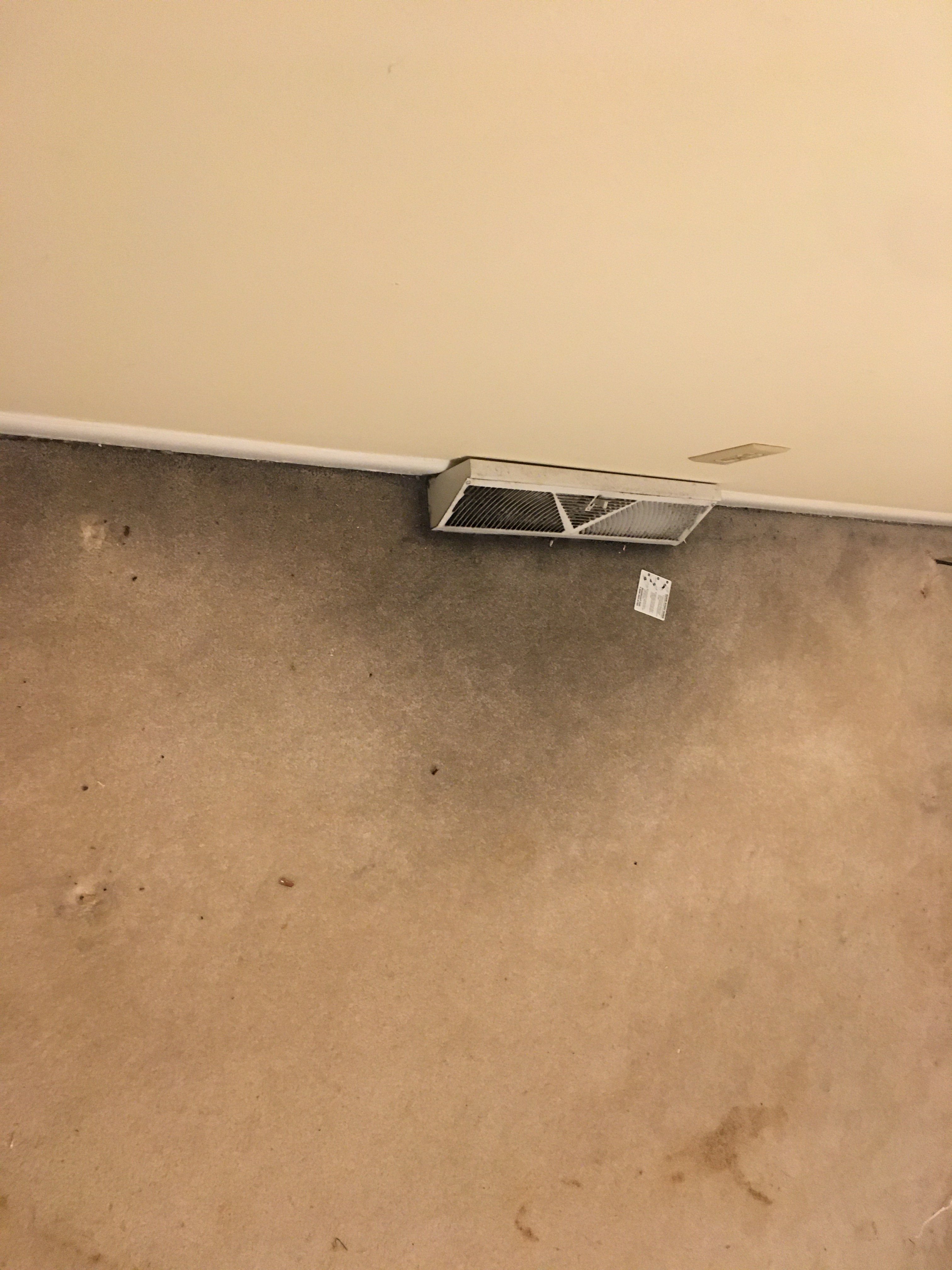

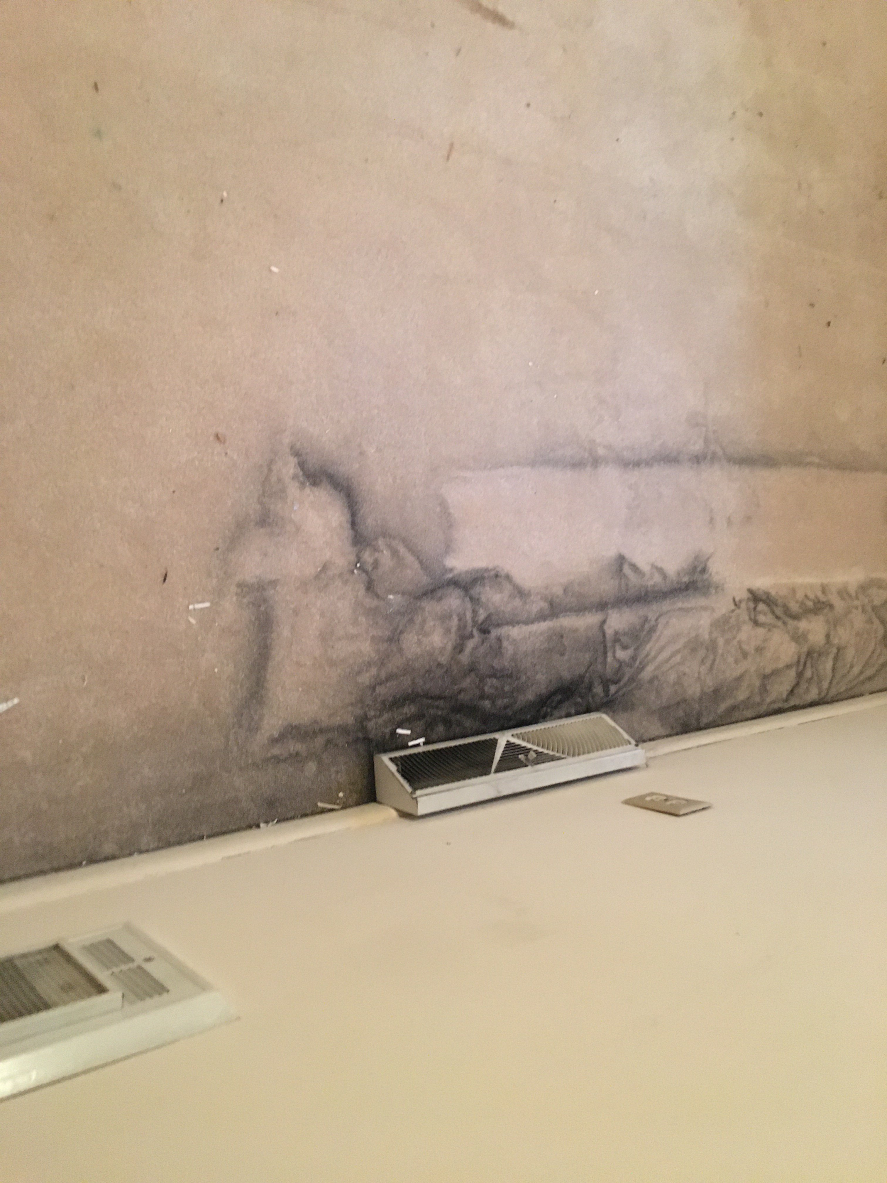

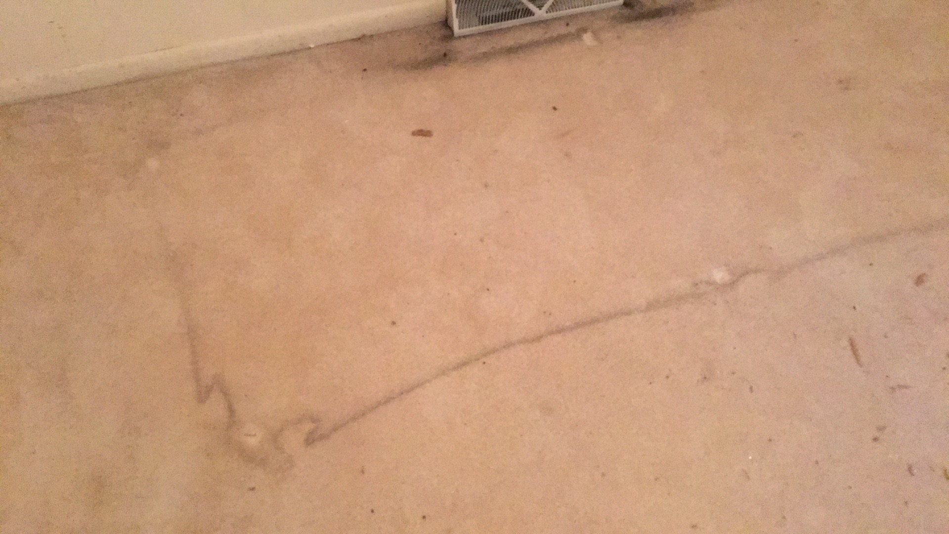

Worst air filtration I’ve seen yet
14,646
What should I attack it with?

Anyone on here ever used this on my type of situation?
The renovate is a powerful solution and should help. It needs to be scrubbed in and in this case, rinsed with an alkaline rinse like dry slurry. You can always bring the ph down later with some browning treatment if that's a concern.

I've had good results with Prochem Filter Out, but on that one, I would be sure and let them know to not expect a miracle. I screwed myself this summer by not letting the customer know that it ain't all coming out. It wasn't quite as bad as that one, but it was close.

A new utility Blade in your knife.
Cut into 2 ft wide strips so it's easier to roll up and carry outside.
Seriously I would boost whatever spray you use with citrus and scrub.
Give below the knee expectations

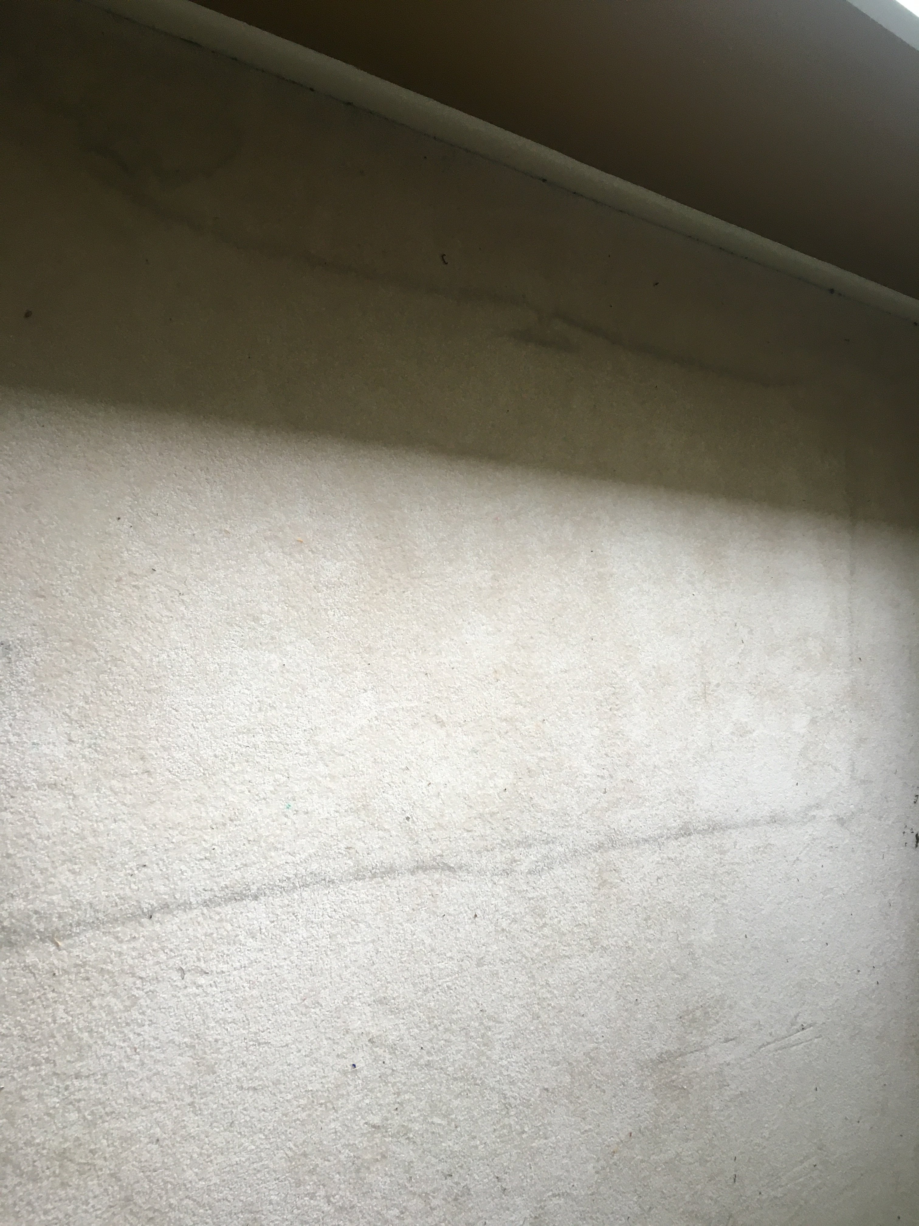

No pics , sorry.
But, One customer for whom I clean fairly often has some dandy's. High end home.
Ultra clean house. ( Bolden, underling, italic the ultra clean part.) But,
White , tufted nylon.
Terrible filtration throughout. walls, doorways , all the usual.. In the upstairs, the one time I cleaned up there( as they never go up or use it) it was awful. One chair with a skirt that hung had the perfect down to the floor had a perfect outline of the skirt when I moved it.
Anyhow, on the main level, in the living room where they never walk there are lines. Perfectly straight lines . squares , that correspond to the walls in the finished basement. Every time I go, ,I work on them. Because it bothers me that I can not improve . Have not gotten them out yet. All the usuall recommended stuff. and aggressive. Even OPed with aggressive bonnets, and various juices. after HWEing with tools.
She did say, that prior to me, she had been told all her candle burning was having an effect.
OK, I know I will get hate. telling me I am doing it wrong!!!
