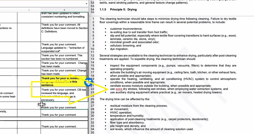

What is an "Extra Dry Stroke"?

does a Zipper or Bonzer perform two strokes?
Imo the lifting or clearing of the head/vac chamber defines each dry stroke, regardless of orifices..
28,282
I would say any pass forward or backwards without triggering solution.
How I have always done it in light to moderate soiled carpet is trigger the solution as the wand is pulled back to me, then dry stroke back up. Overlap and repeat. After the width of the area is completed, dry pass over the just cleaned area. On heavily soiled areas, I may trigger the solution in both directions then do extra dry passes to remove excess moisture.

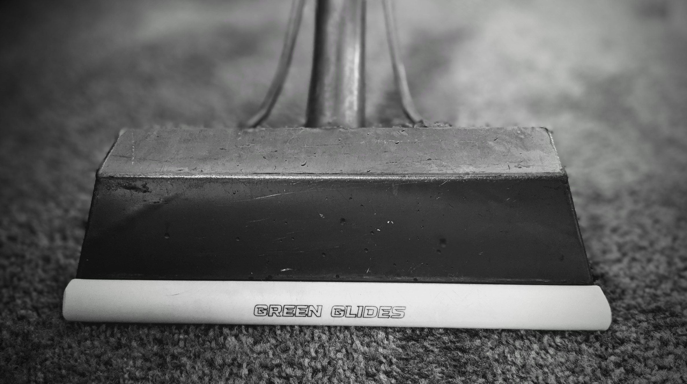

Extra dry strokes for me @ 525 cleaning passes per minute solution on, followed by 525 drying passes per minute, solution valve off.
This is how I can offer the fastest unassisted drying times available.

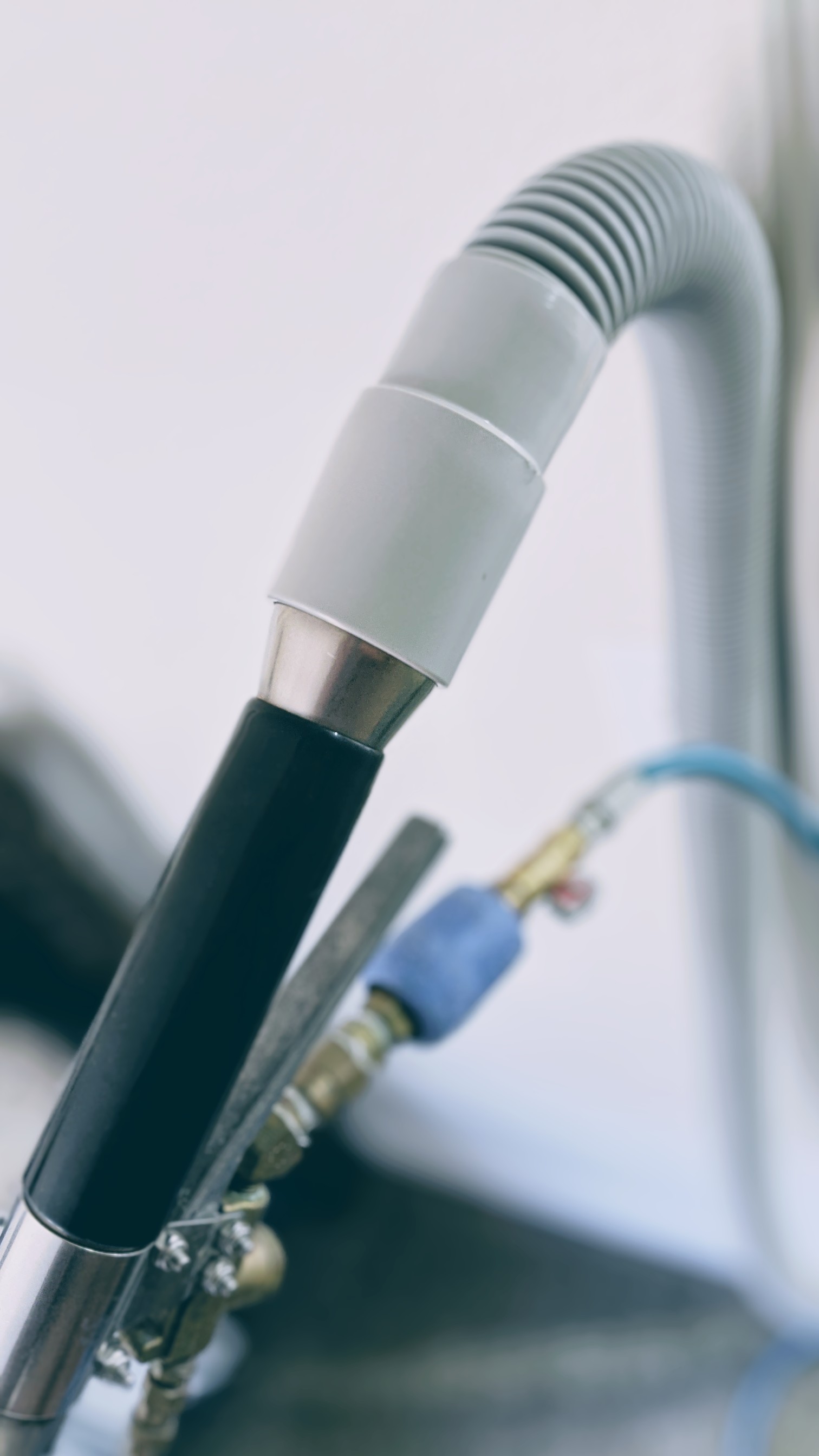

Thats a Joe Valve. Joes is going to pop a gasket when he finds out Sam Miller sent him that.

Standard is 1 wet, 2 dry
Extra dry stroke?
One wet and THREE dry...
Pretty straight forward....

Not nitpicking the wording, but consider this:
What we call "dry strokes" are actually passes of the wand that extract more water/soil/detergent. The carpet dries more quickly as a result of extra extraction passes, but it also is cleaner, with less detergent residue, and less chance of wicking and post cleaning bacterial odors.
There is yet to be a system invented that removes the dirty water and only leaves clean water in the carpet yarns.
Wet carpet is undercleaned carpet.
