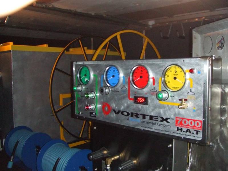

How many Older model Vs do we have in the forum? Wanted to know if any of you would like to upfit or "remodel" and revive your V with new more accuarate gauges and sensors, complete "updo" the bow of your V with cosmetic and mechenical upgrades that will make your V run, perform and look new. I am almost finished with mine and wanted to know if anyone was interested in a "how to" accompanied by a full step by step list of what and how to do it. I will include a list of suppliers and manufacturers of where to find all parts and even come up with an apoximate price on parts and equipment.
I ask this because i would like to guage you all interest and find out if anyone is actually looking into upgrading thier V without the $90,000.00 price tag.
Please list your Year and model V and what ideas you might have on what you would like to do.
Here are some pics of mine about 70-80 done please chime in on what you all think.

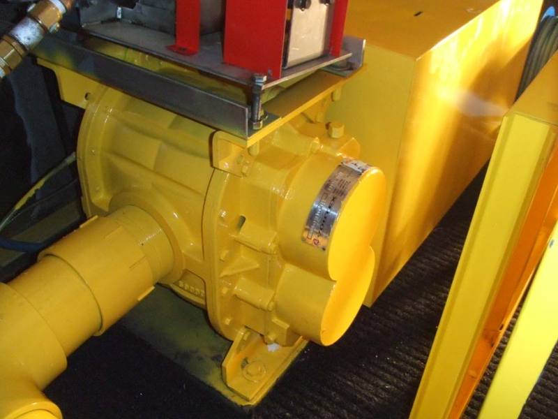

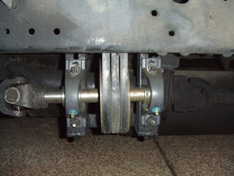

new pto drive shaft with new pillow blocks and and new u joints and belts.

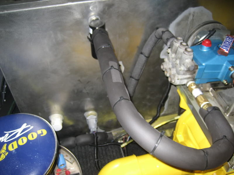

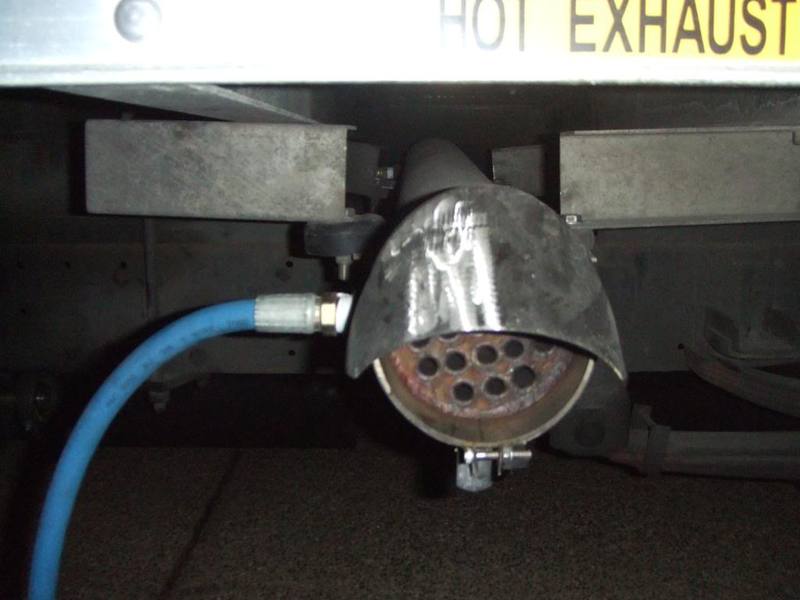

this is my new exhaust to water HX no oil! very similiar to aerotechs.

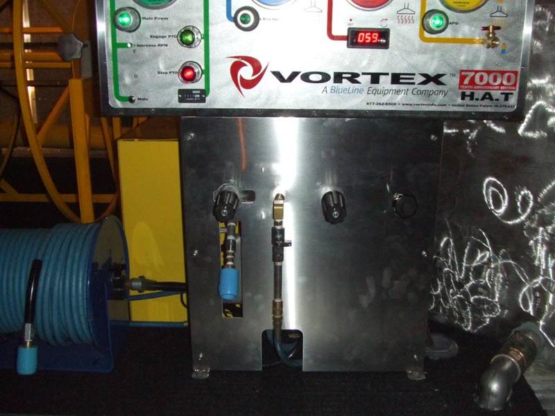

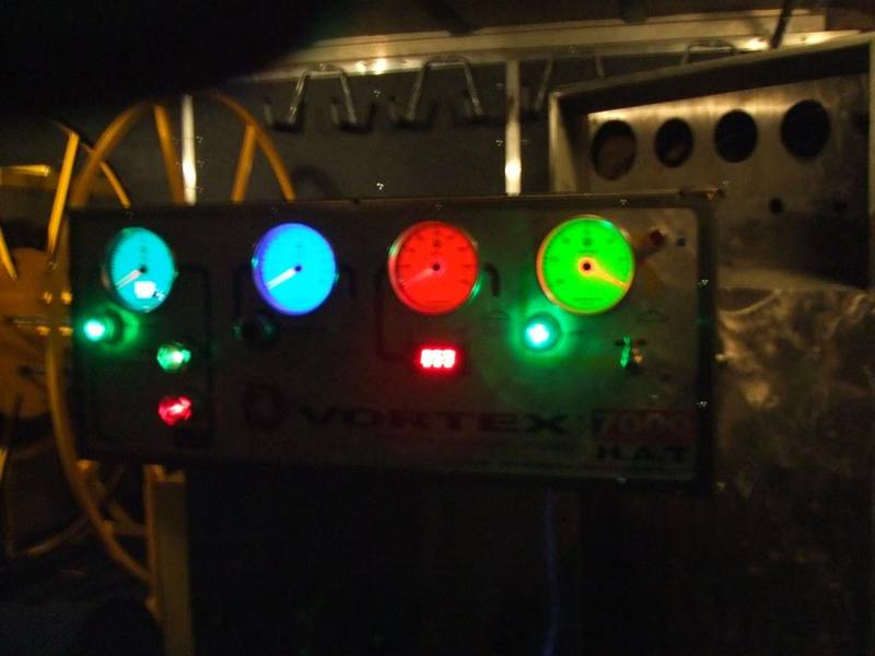

This a my new panel same as a 700hat but with updated gauges and new sensors and all new wiring.

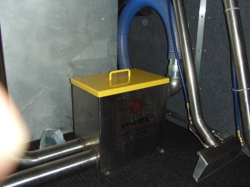

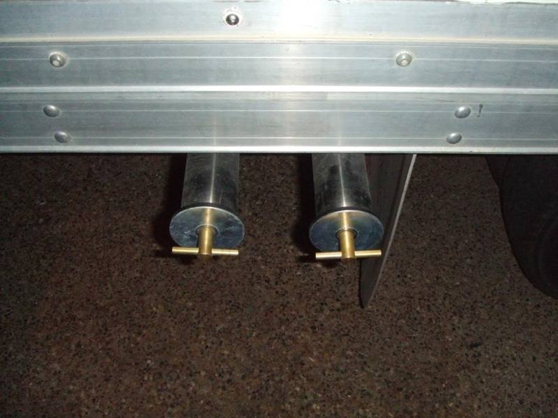

Quick disconnects for in line vac filter box

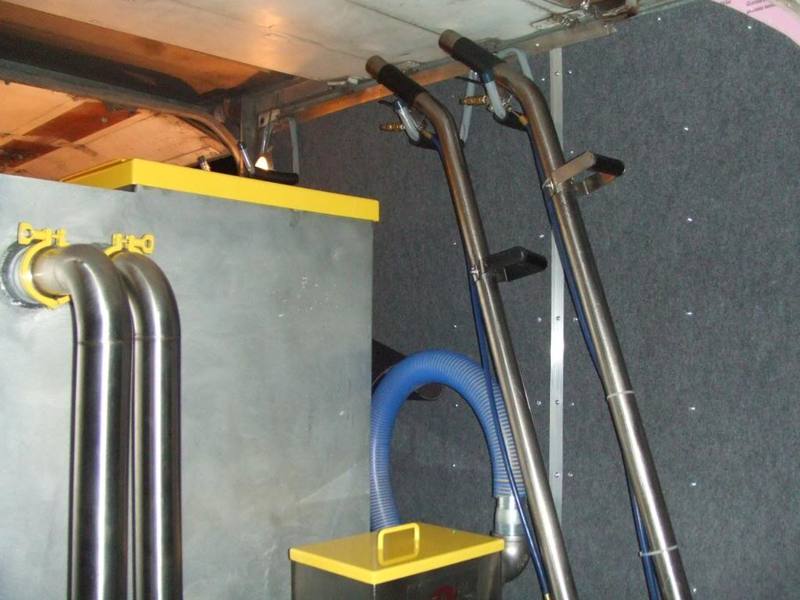

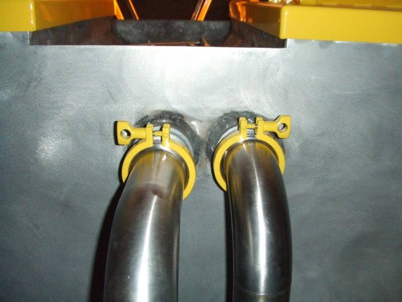

New all SS filter box with 2 3" lines in and to 2.5" out

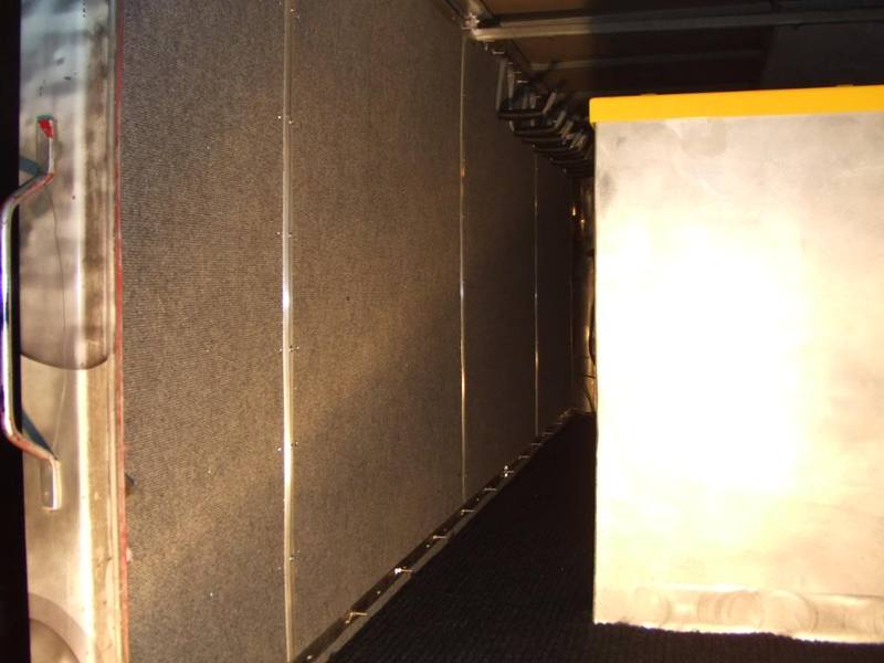

Installed carpet and insulation and some hooks for storage.
Night View of panel
Night View of panel
