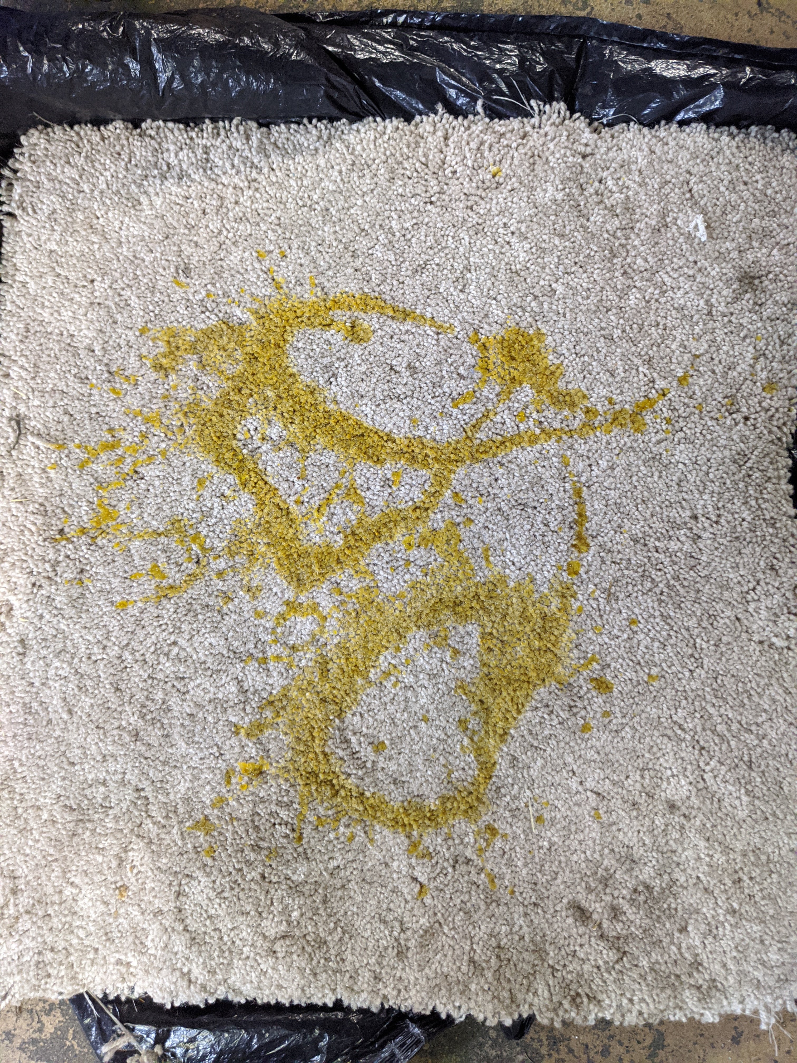

Here is a photo of a carpet sample that I stained today with tumeric and water. Will be practicing my stain removal techniques in preparation for the real thing next week. After rinsing, I will be using a peroxide/ammonia solution (vanish) along with a steamer. Any other suggestions that have achieved good results for you?

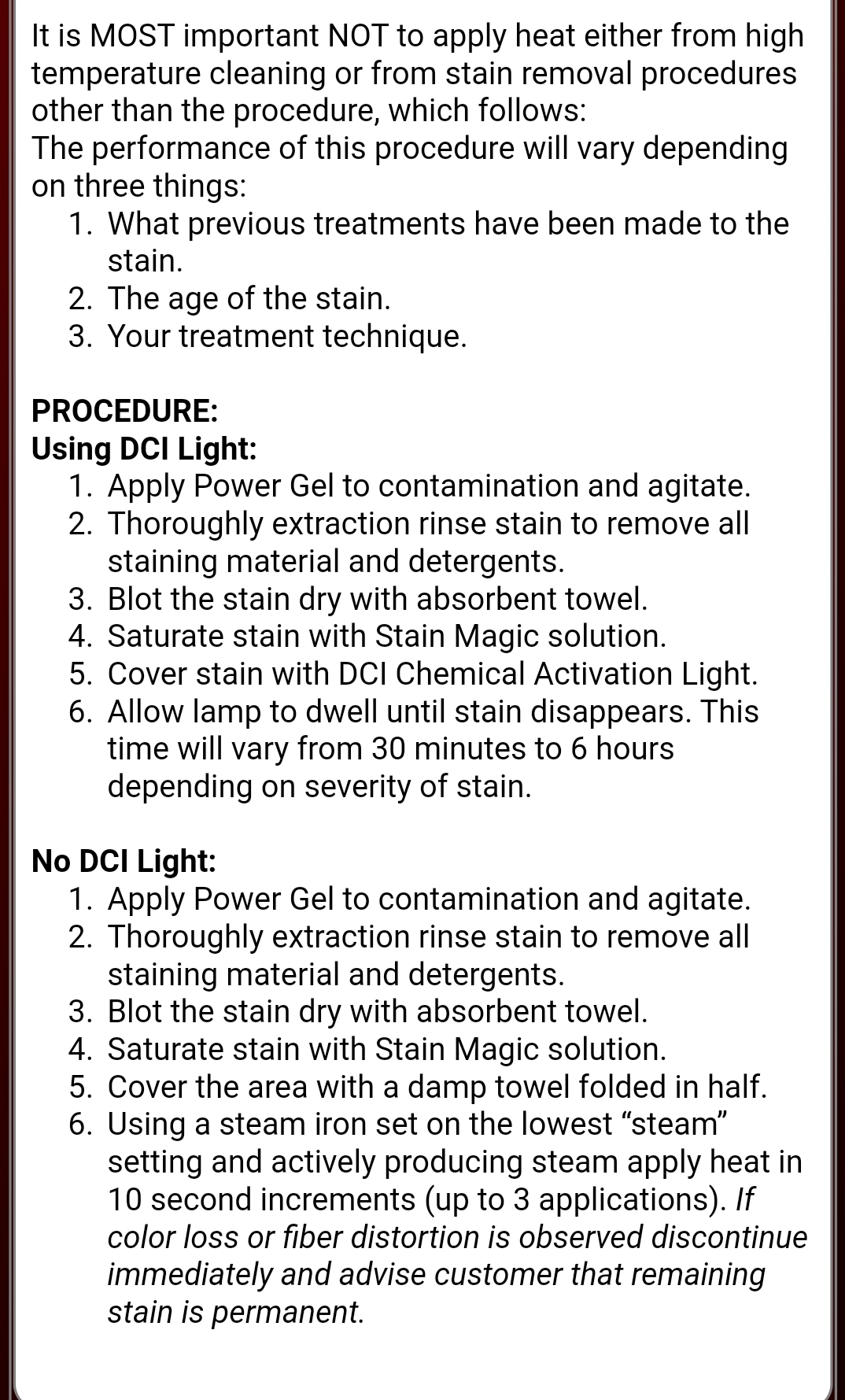

Bridge point has a curry/tumeric stain removal guide. I followed it to a T, and was successful....
Yes, there are multiple steps, yes, UV light was involved....

Yes, yes, but, what does the client prefer????
Customer prefers not to cut and repair. I have had success in the past but all depends on the product spilled and cleaning attempts. I don't have a UV light so I will use heat instead. I have already told the customer it's about a 50/50 chance of complete removal and they have to pay me regardless.

Use your prespray and wash and rinse many times, when there is no longer any improvement--
Now--'Use pro's choice Stain 1, dwell as long a possible. Rinse, repeat several time. Spray again with Stain 1 and leave it. I should disappear in a week or 2.

The 2 part stain magic works better. Still need heat or UV light.
I agree sorta-- heat can set the stain.
I forgot that I also used the UV light. Its been a very long time since I've had to deal with that type of stain. Very rewarding when successful.
