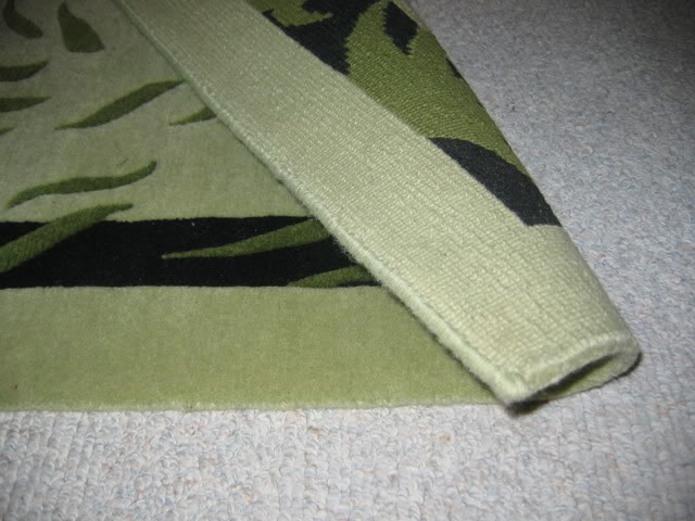

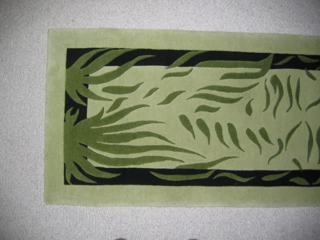

I really enjoy rugs, don't see very many nice ones so I always like the photos.
Here is one,
Any comments?

lol, good thing that map had North marked on it, I was starting to get confused.
Thanks Randy, I was just wondering if anyone had comments on it. I bought it a couple of months ago. Funny thing I wasn't even shopping for a rug, I was buying a Sigg water bottle from a guy selling bottles in his rug cleaning plant store front. As soon as I saw it I knew I would buy it (impulsive or what?).
It's a Pumori, I think the wool in it is from New Zealand. Seems to me the salesman said the more vibrant colored wools were from New Zealand. They had a replica of the loom it was made on, some kind of a gizmo with a rod that the strands are tied around, then the strands are cut in half after the rod is full.
The designer is from Hawaii and he won't let them post pictures of his rugs on their website, he's concerned someone will use his artwork.

People rip off rug designs all the time sometimes before they even get to market.
in fact this one is kind of a rip off from an older Odeguard Tibetan rug which is a rip-off of old Tibetan tiger stripe rugs. It’s an alright rug the wool is most likely domestic from Nepal. Why would the colors be more vibrant from New Zealand can’t Nepalese dye vibrant colors?
