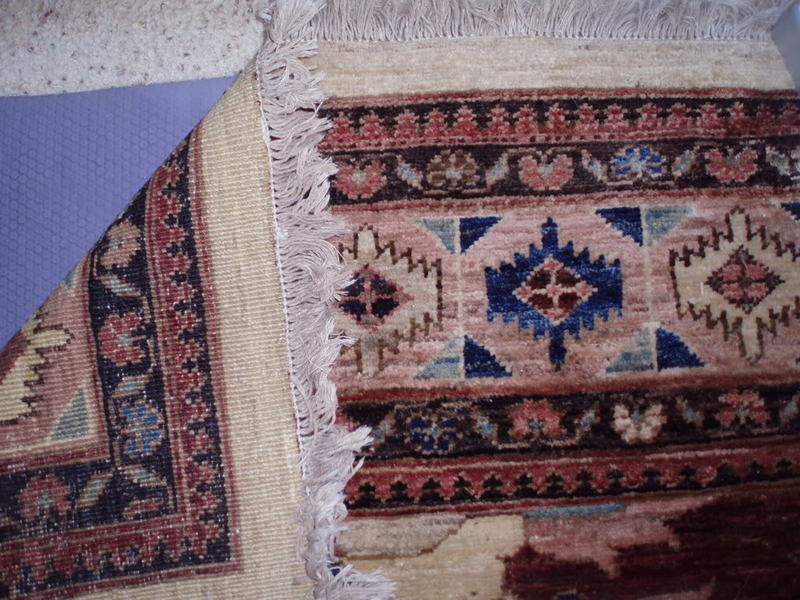

1. Probably Pakistan but much of the new stuff is being made in Afghanistan…. it looks like an a rug made by art resource. Colors, design, heavy chemical wash wet a corner it should feel slimy and smell like chemicals or vomit. These can be problem bleeders and a weird slurry of shit usually comes out of these in a wash

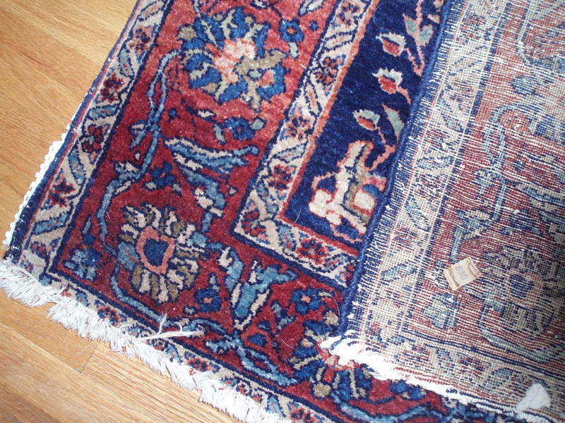

2. Sarouk is the quick answer although some are not actually Sarouk. Colors weave, design. Should wash fine dry rot is sometimes an issue be very careful when handling wet

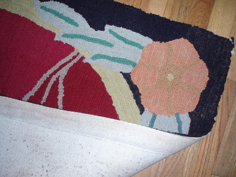

3. Hooked rug. If the binding on the side is a glued on separate piece of material it’s Indian. Cinese if folded over usually hand sewn sometimes glued One way to tell a tufted rug is from China or India.

Hooked rug. If the binding on the side is a glued on separate piece of material it’s Indian. Chinese if folded over usually hand sewn sometimes glued One way to tell a tufted rug is from China or India.
I sort of put that hooked up as a joke but damn if I didn't learn something to impress Mrs Piftleton.
