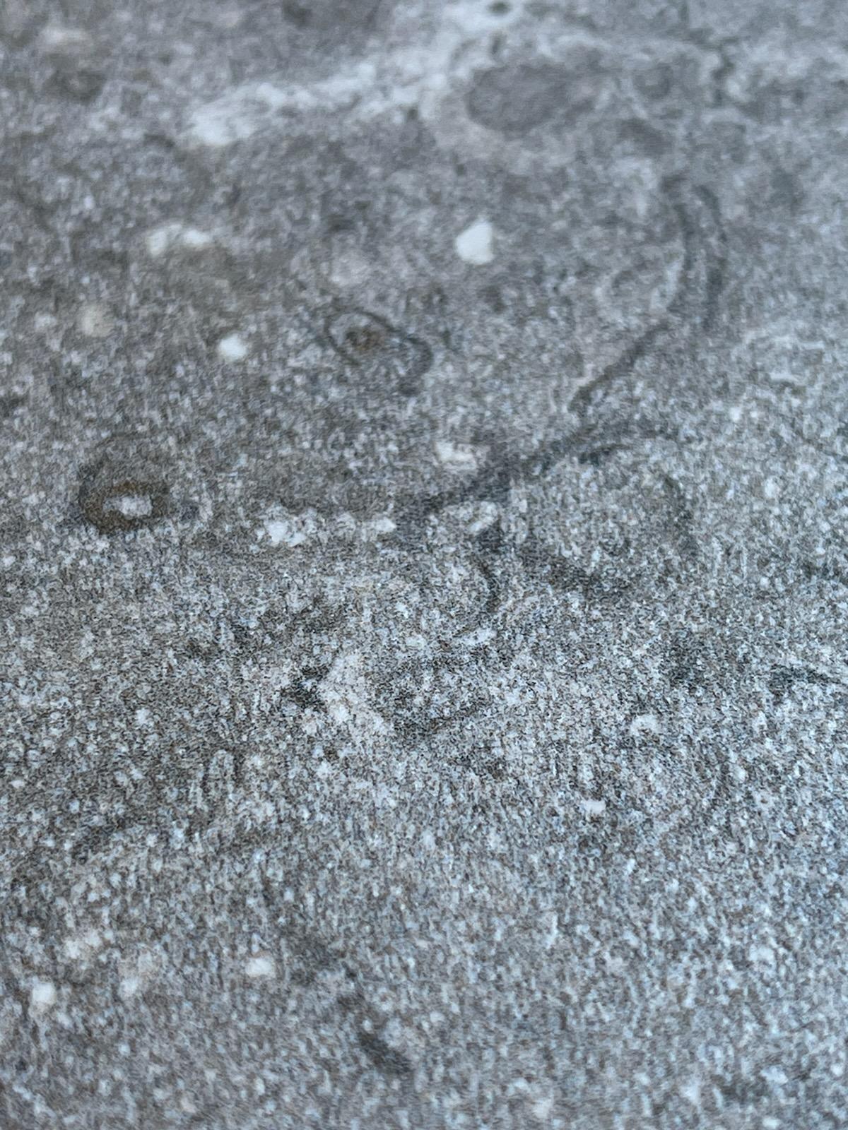

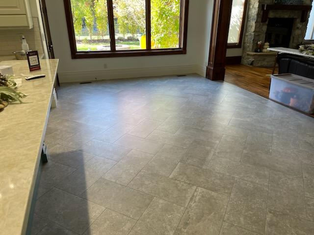

Yet another issue, this time with unglazed Porcelain..
It was a new floor that got sealed with Interlinks Viper Prestige water based sealer.
The cleaner used one of those blue wiffle ball bat applicators and didn't mop up or buff out the excess... IMG_20211016_134704.jpg
He tried cleaning it off with a spinner with no luck..
Sealing the whole floor ended up being the fixIMG_20211016_134729.jpgIMG_20211016_134736.jpg
A sponge for a floor, lovely.

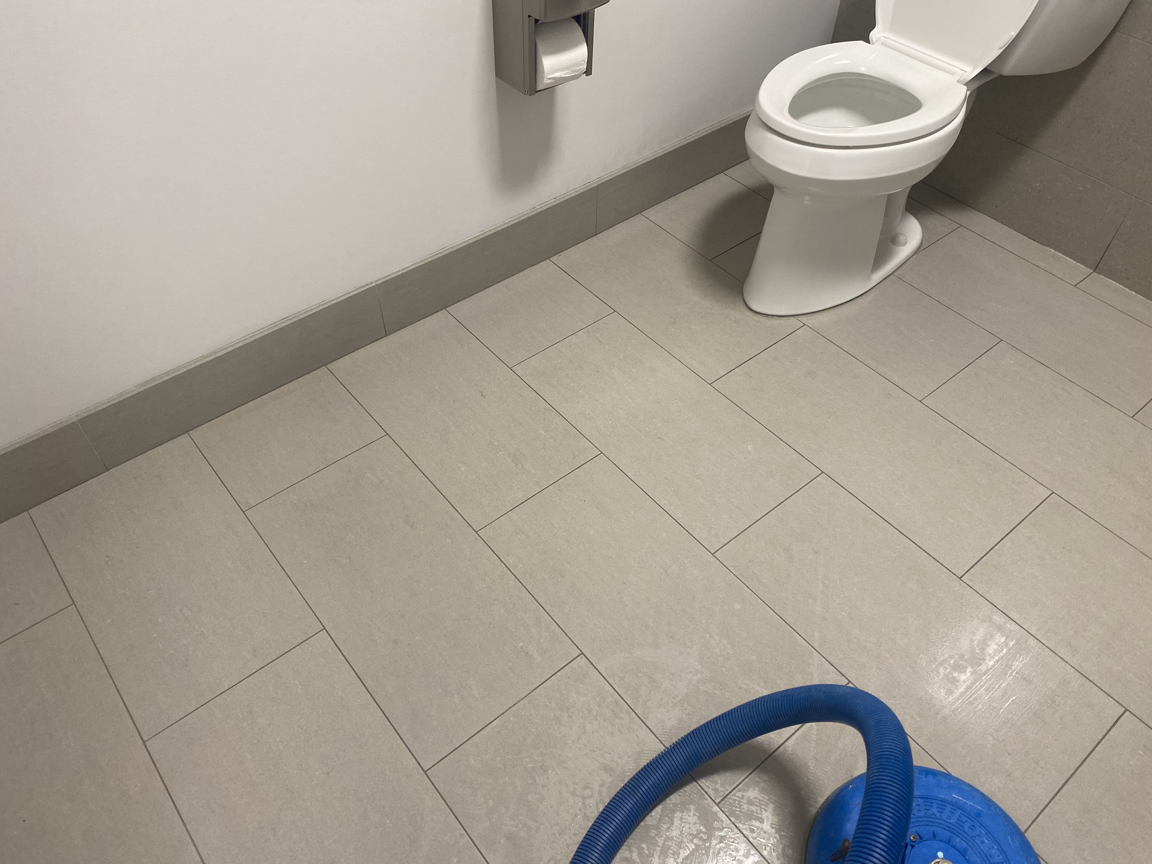

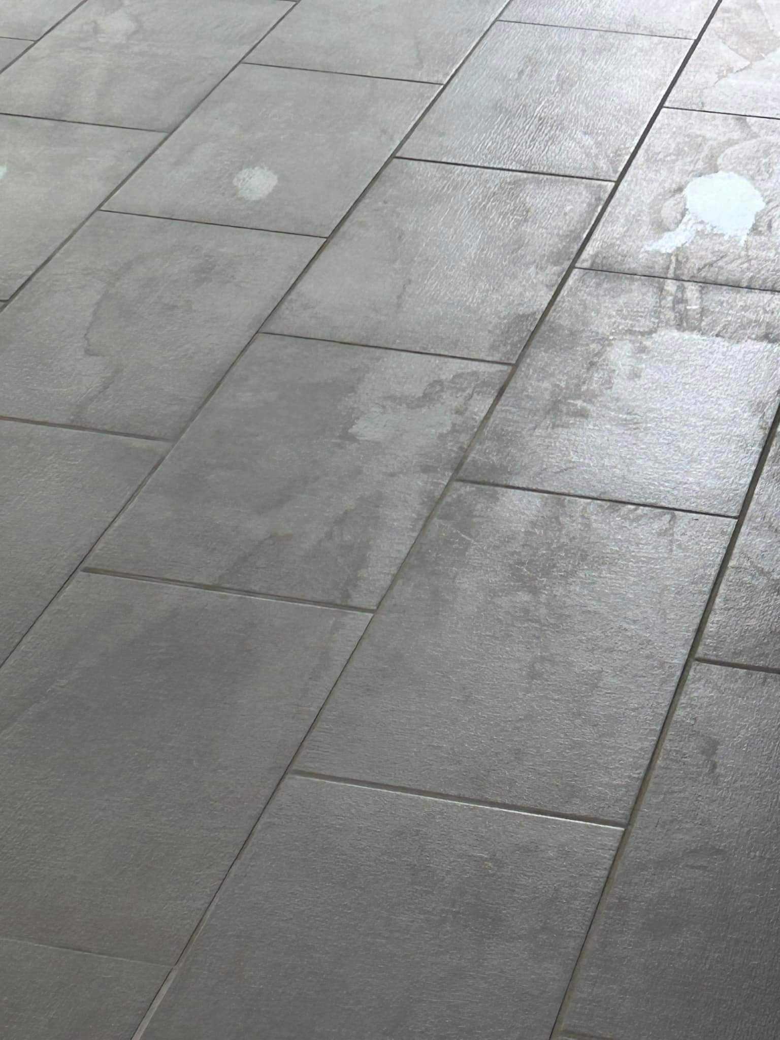

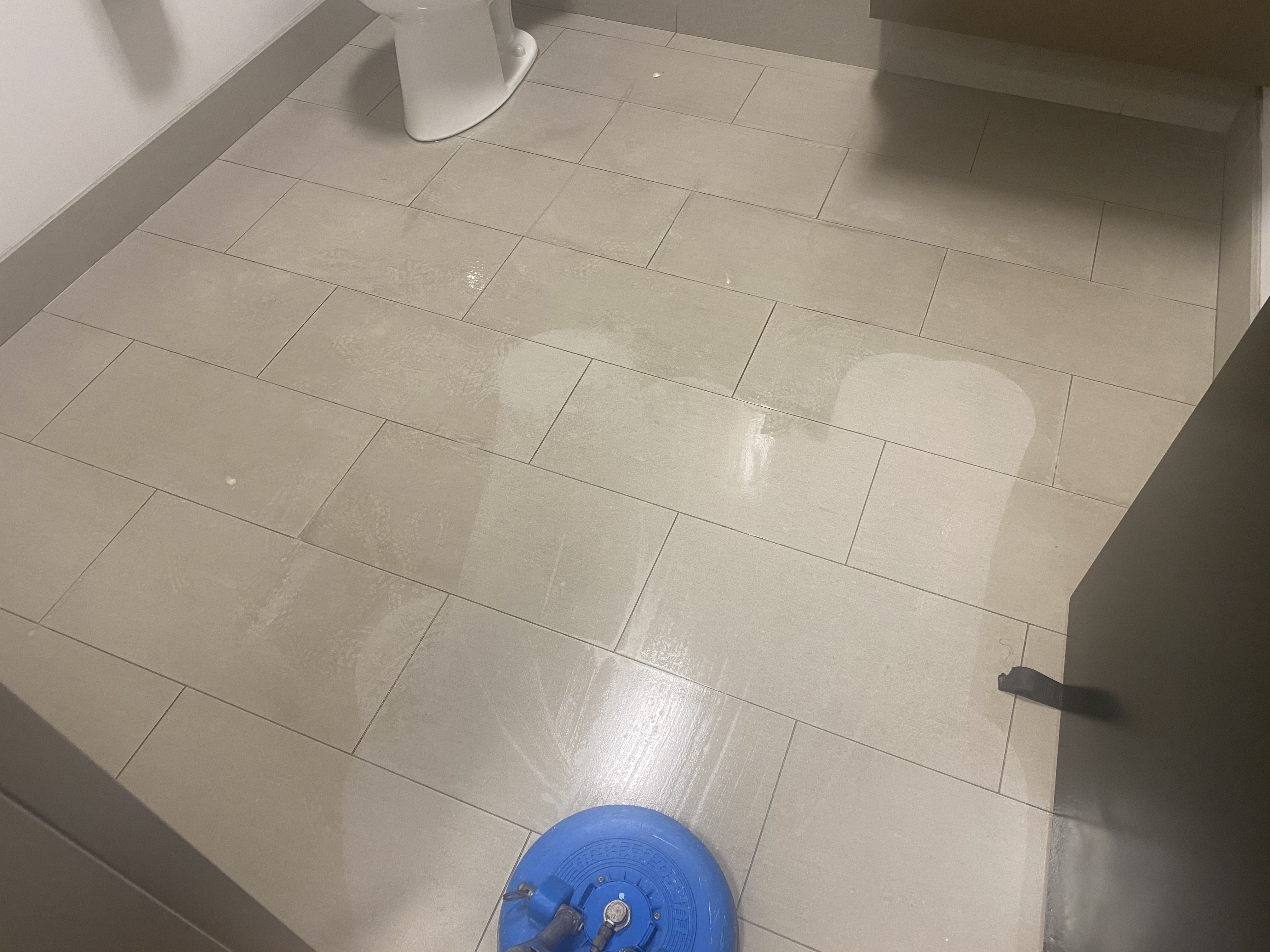

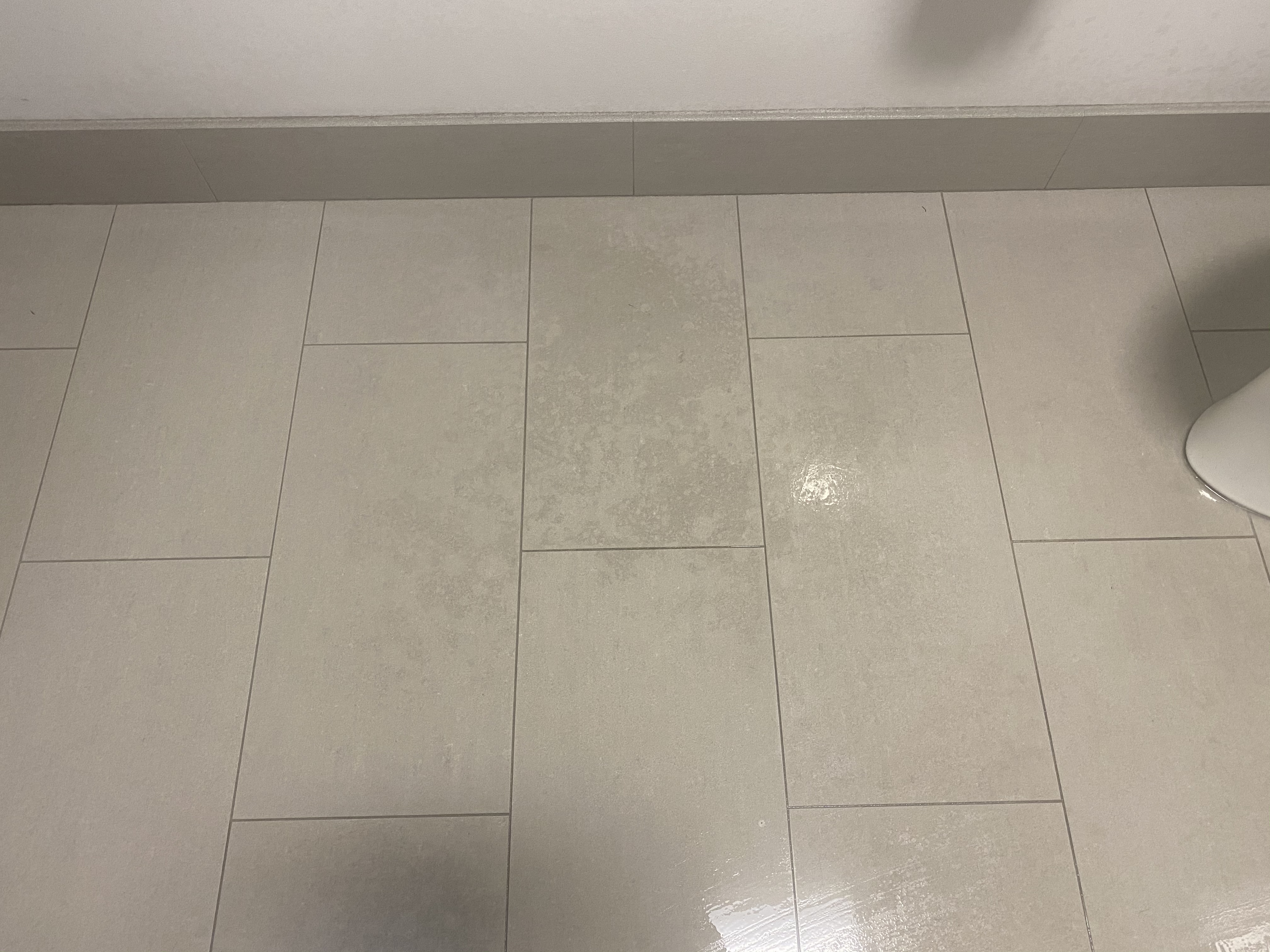

This was a commercial office with the same issue. The cleaning crew used something to clean and left spots all over. As you can see the cleaning was turning out great until I noticed the spots. I tested a portion with a neutral cleaner and it lifted up. You can see it most by the toilet.
7E2D09E3-1EB0-4891-ACD9-9639FB25787B.jpeg 5F299486-D0EF-4A8D-ACC1-6057123C8883.jpeg 0D7FFAB0-BE60-49AD-BB97-45DCAA4125F4.jpeg
