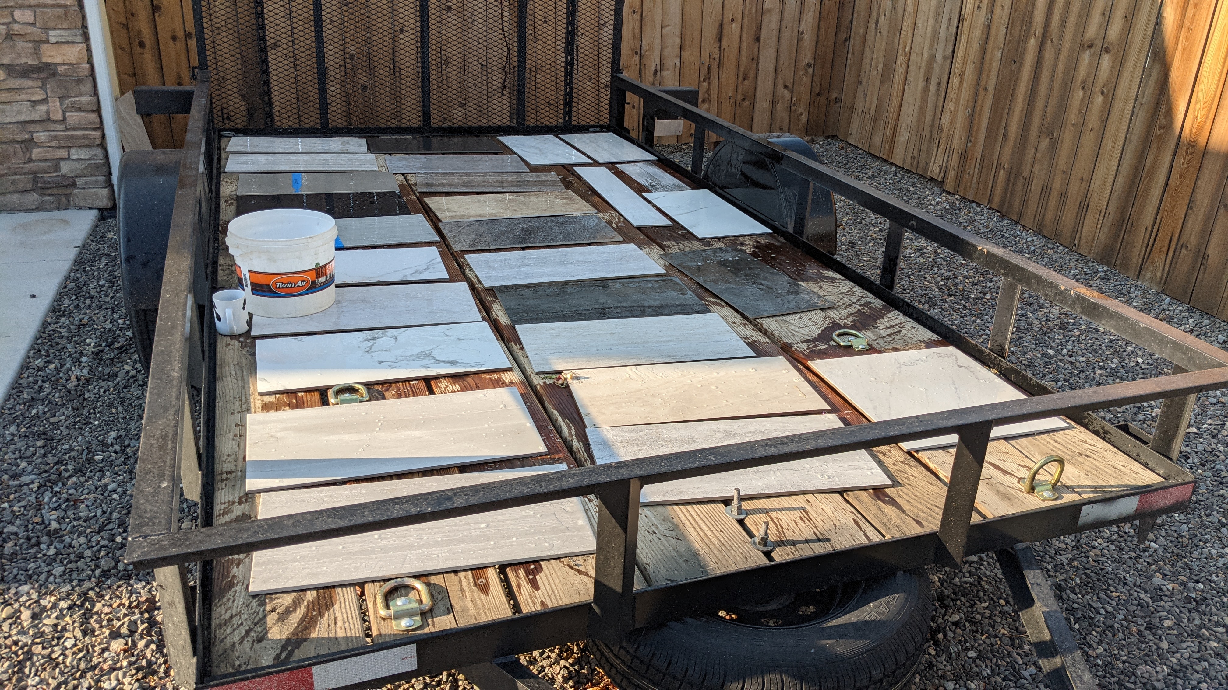

So I messed around in the garage today taking a different approach to five more pH burned tiles.
Using the same Italian cream that I had used mechanically before, this time I used a 3-in hog's hair punch out and spent about 1 minute per 9-in by 9-in section.
I didn't let the cream dry out and didn't put much weight into it and guess what, this worked beautifully.
I can now safely assume that a typical 90 lb 175 and maybe even a quality white pad would do the same thing very quickly.
I realize now that we were working too hard and too fast in Phoenix and ended up over polishing and in one case removing some of the glaze by sitting on the tiles too long working the cream from wet the dry.
Stu Rosen is still not sure he wants this to be the product that he recommends to carpet cleaners so we are waiting on something else to come in from Italy that may also have some protective qualities to it.
And speaking of protective qualities, I'm finding that this creme make the tiles much more resistant to pH burn.

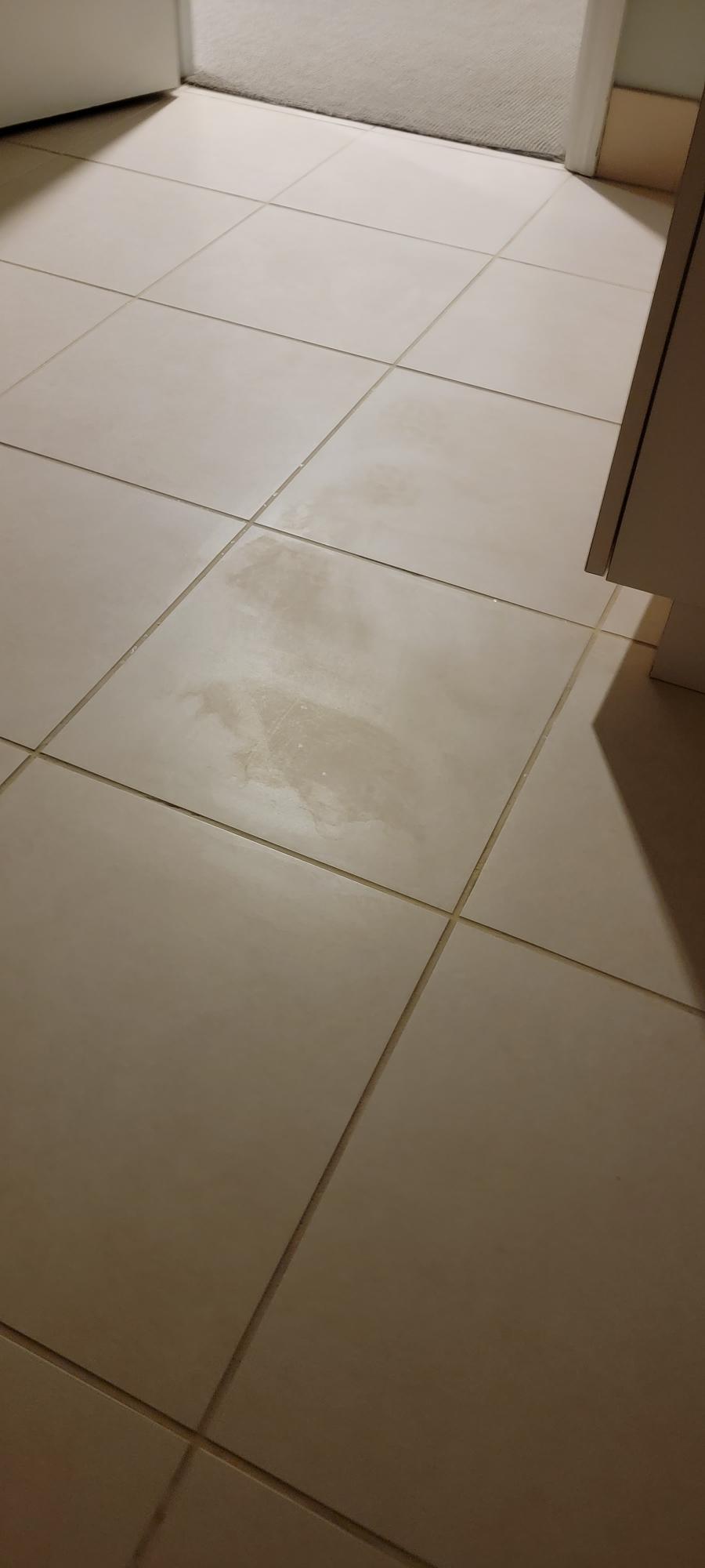

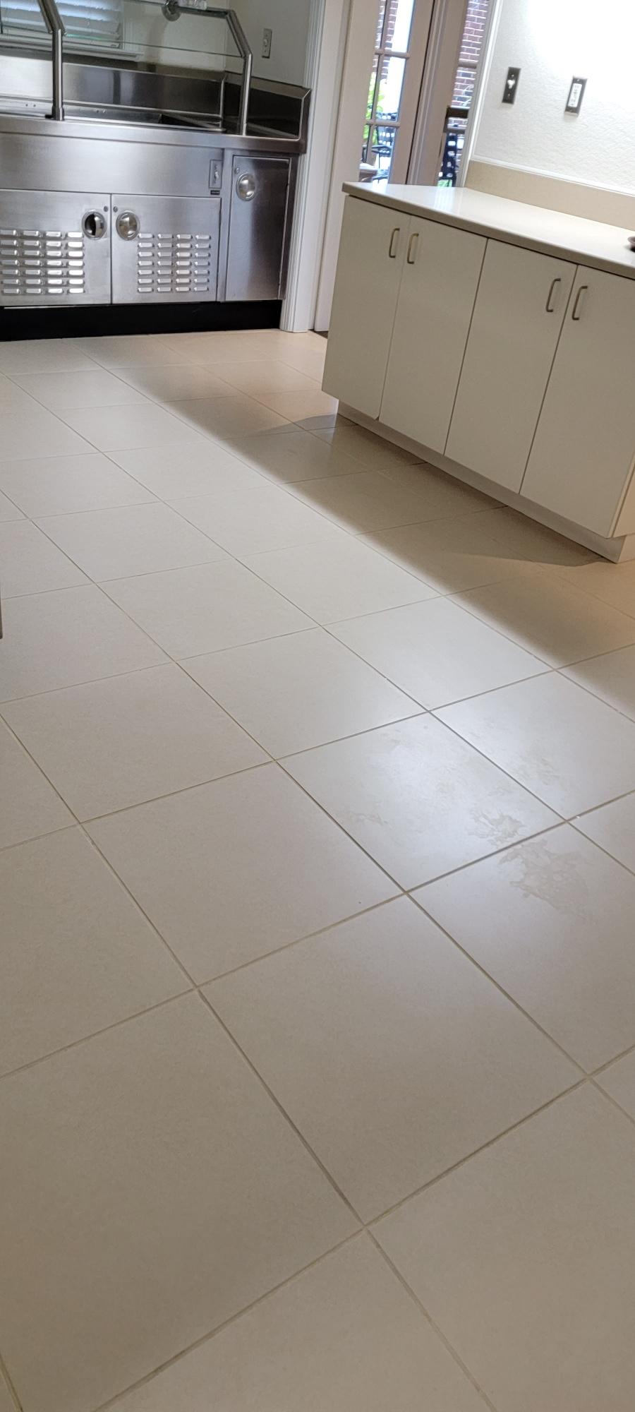

And another..
2006, college sorority house kitchen..
"Powder burns"...
Acid rinsing and buffing would not fix so it's time to try the restoration cream
