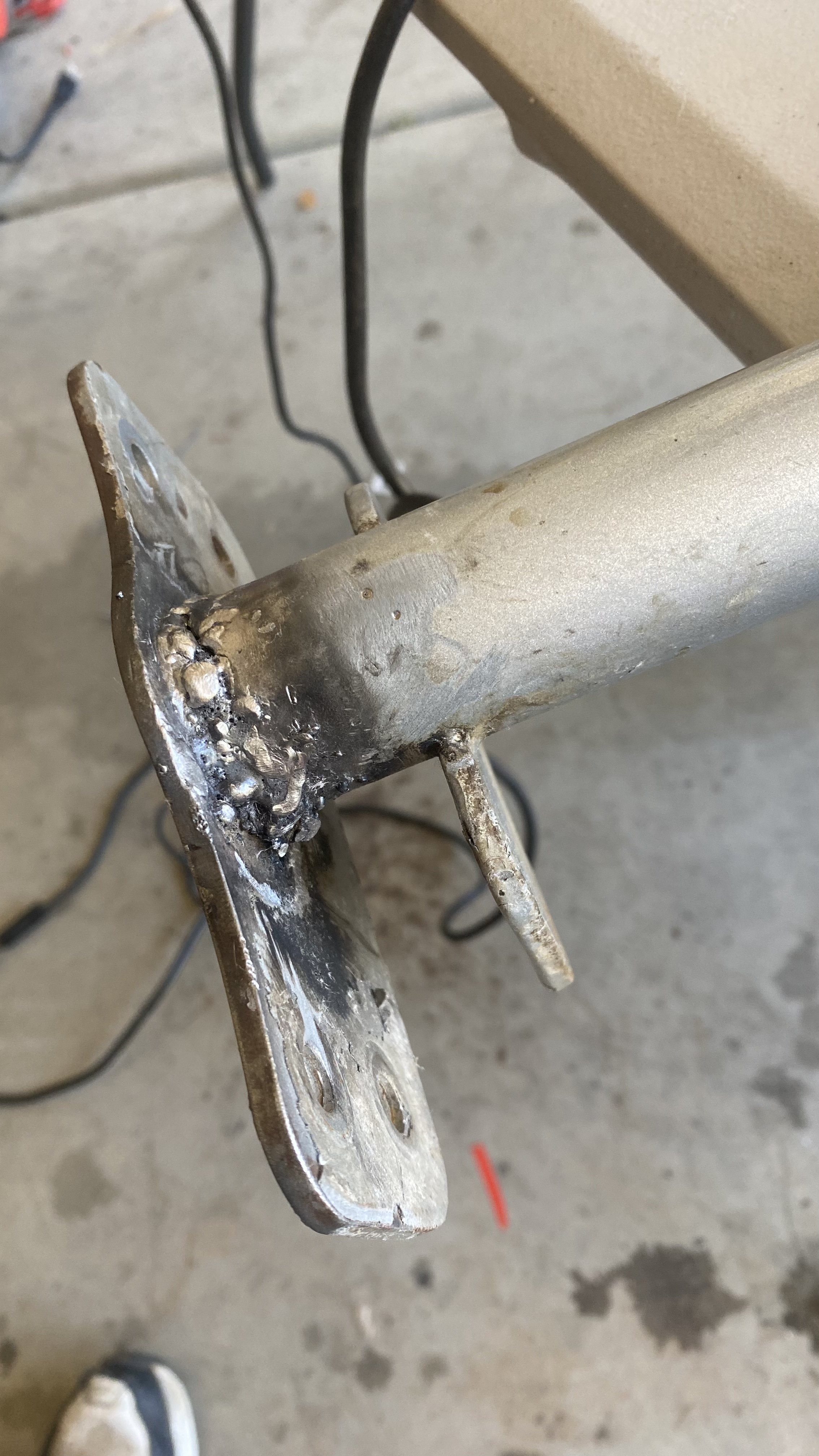

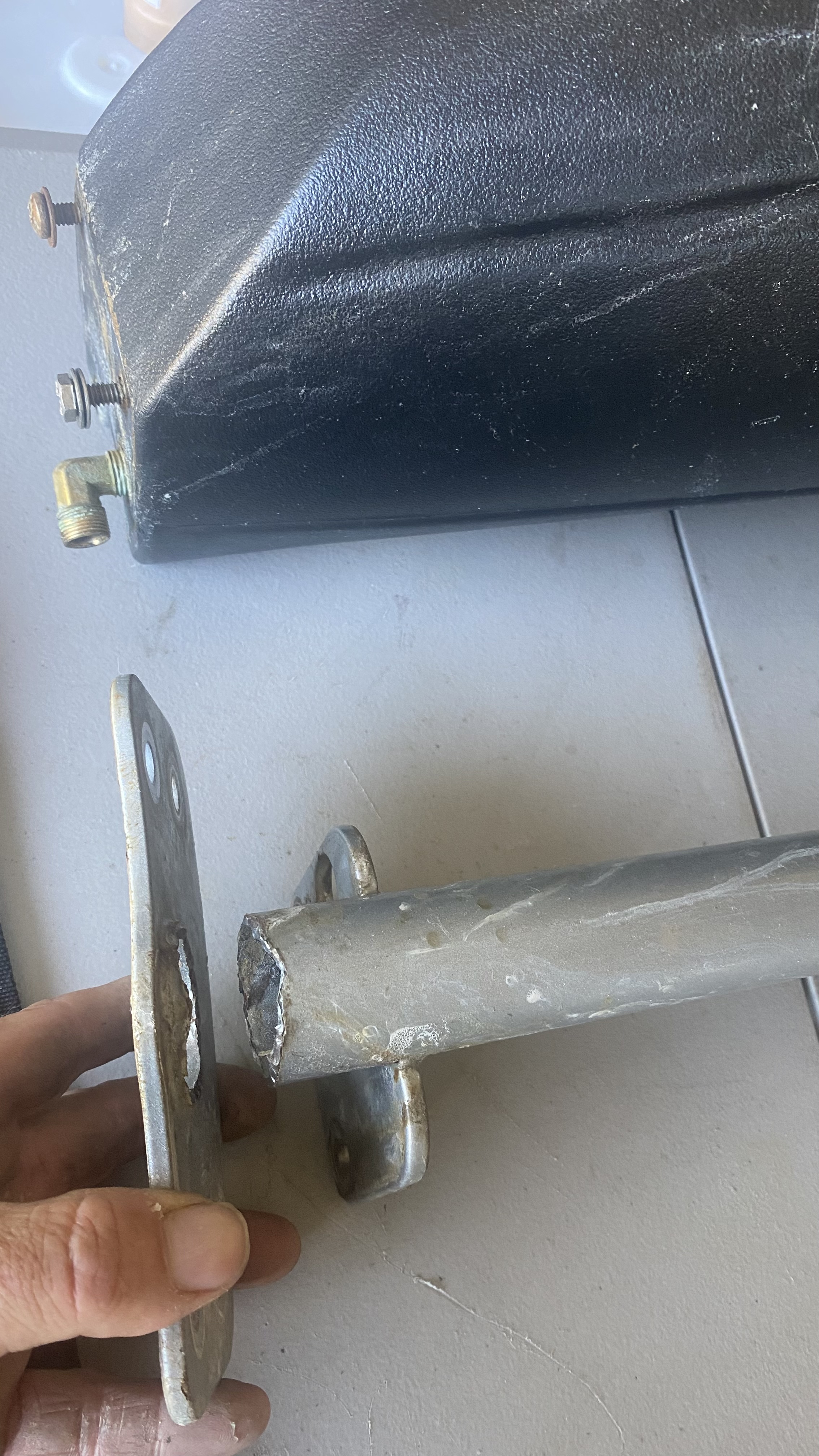

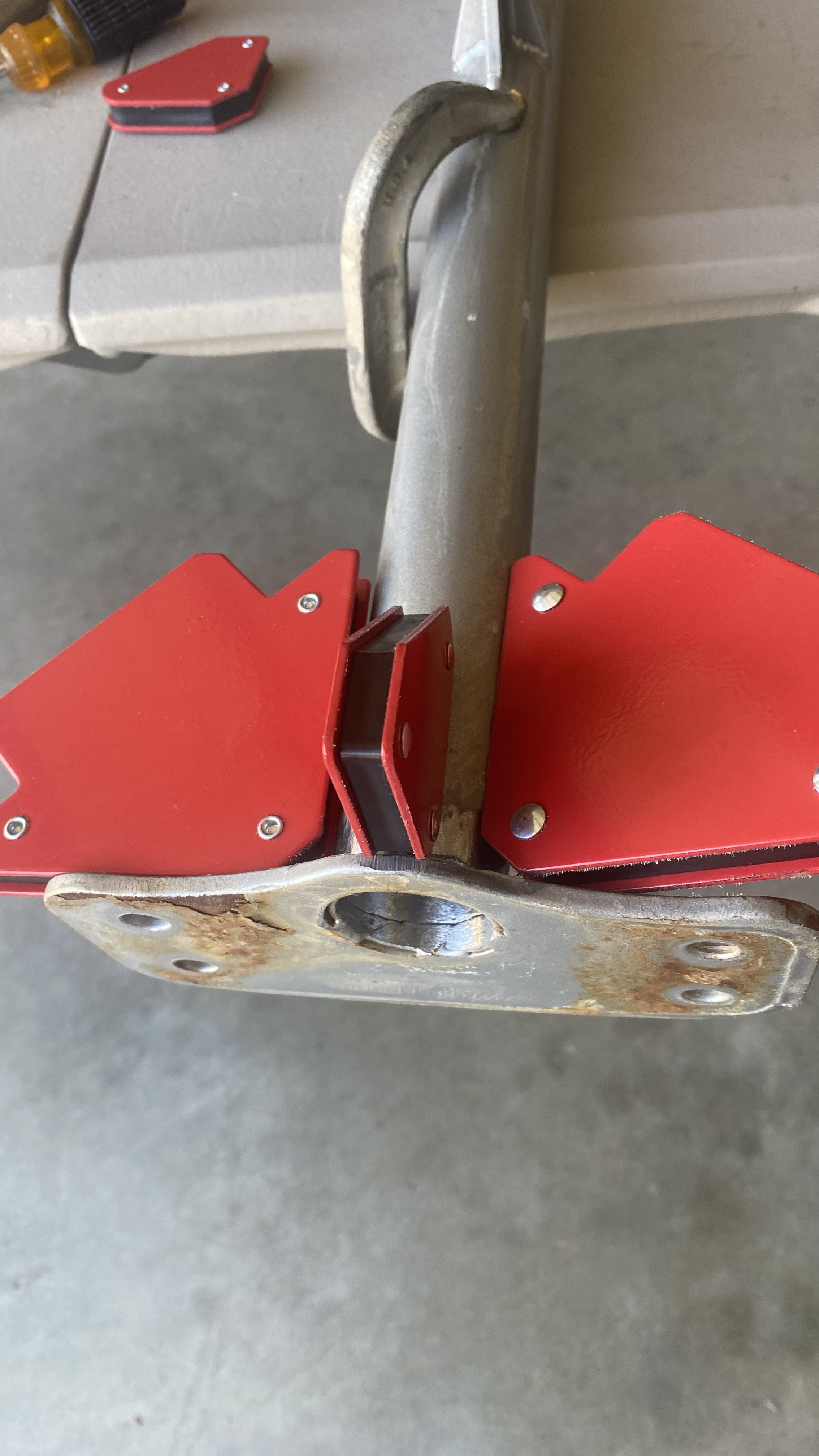

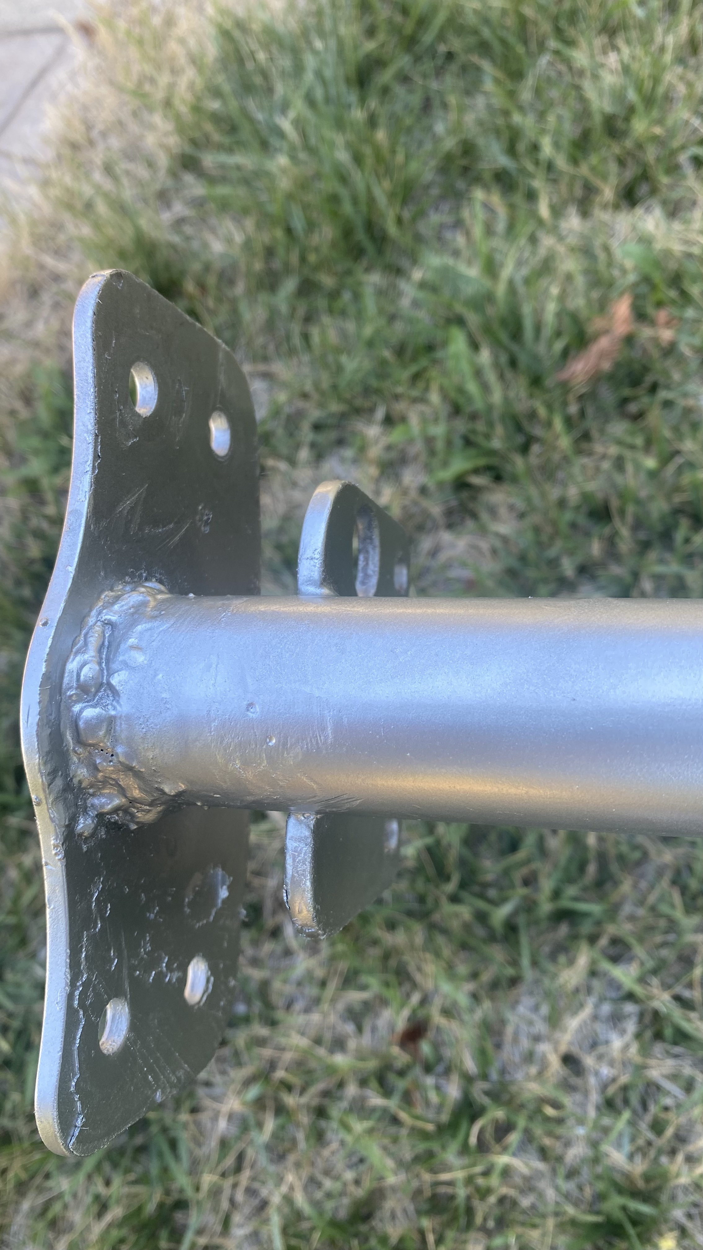

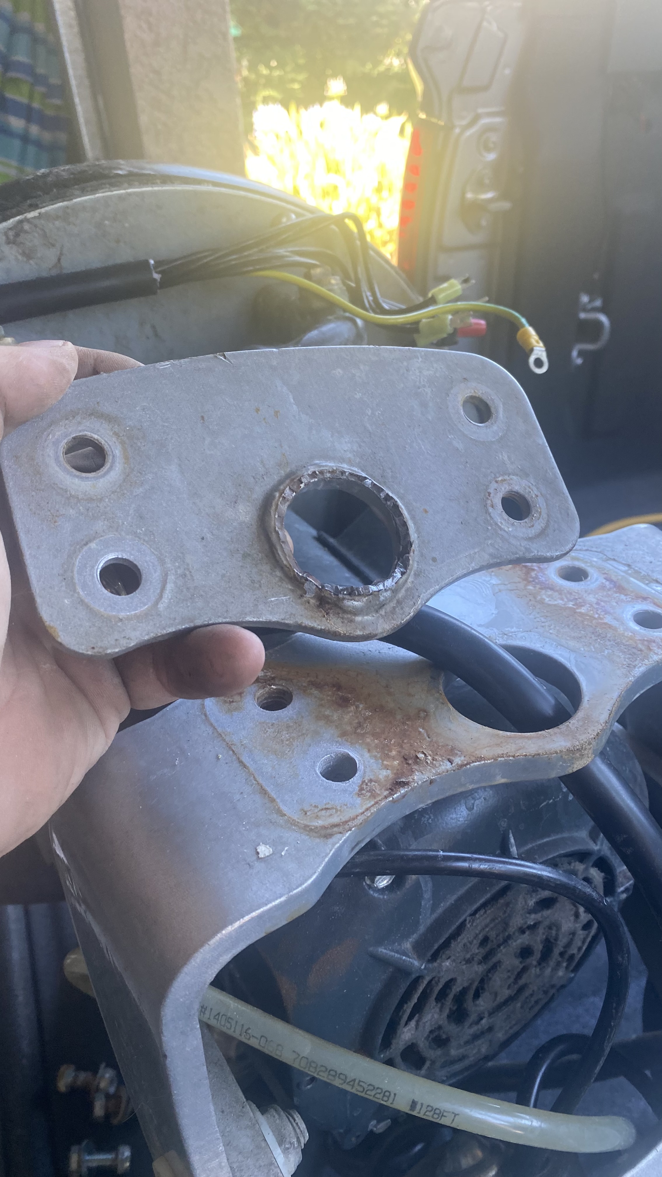

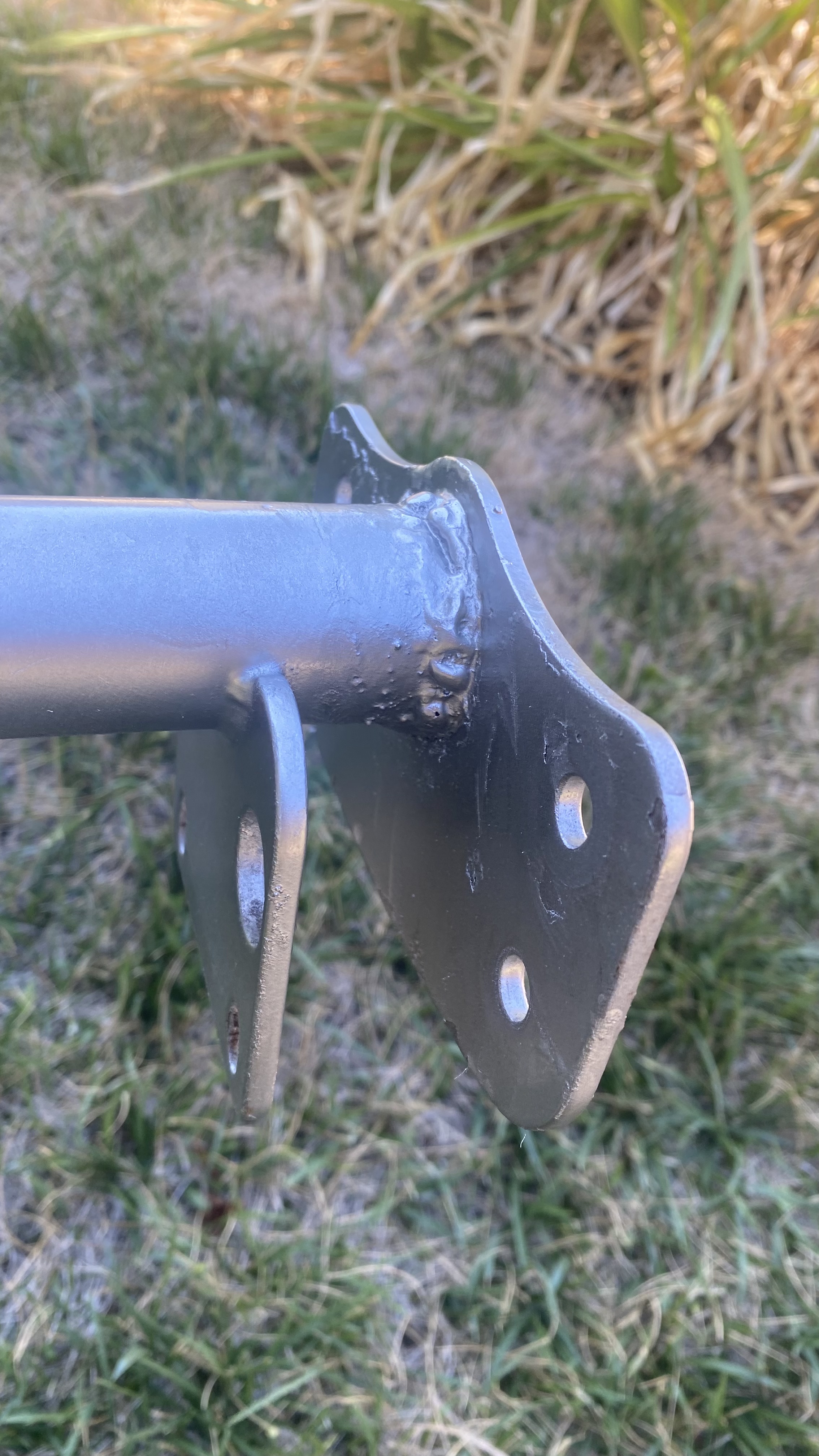

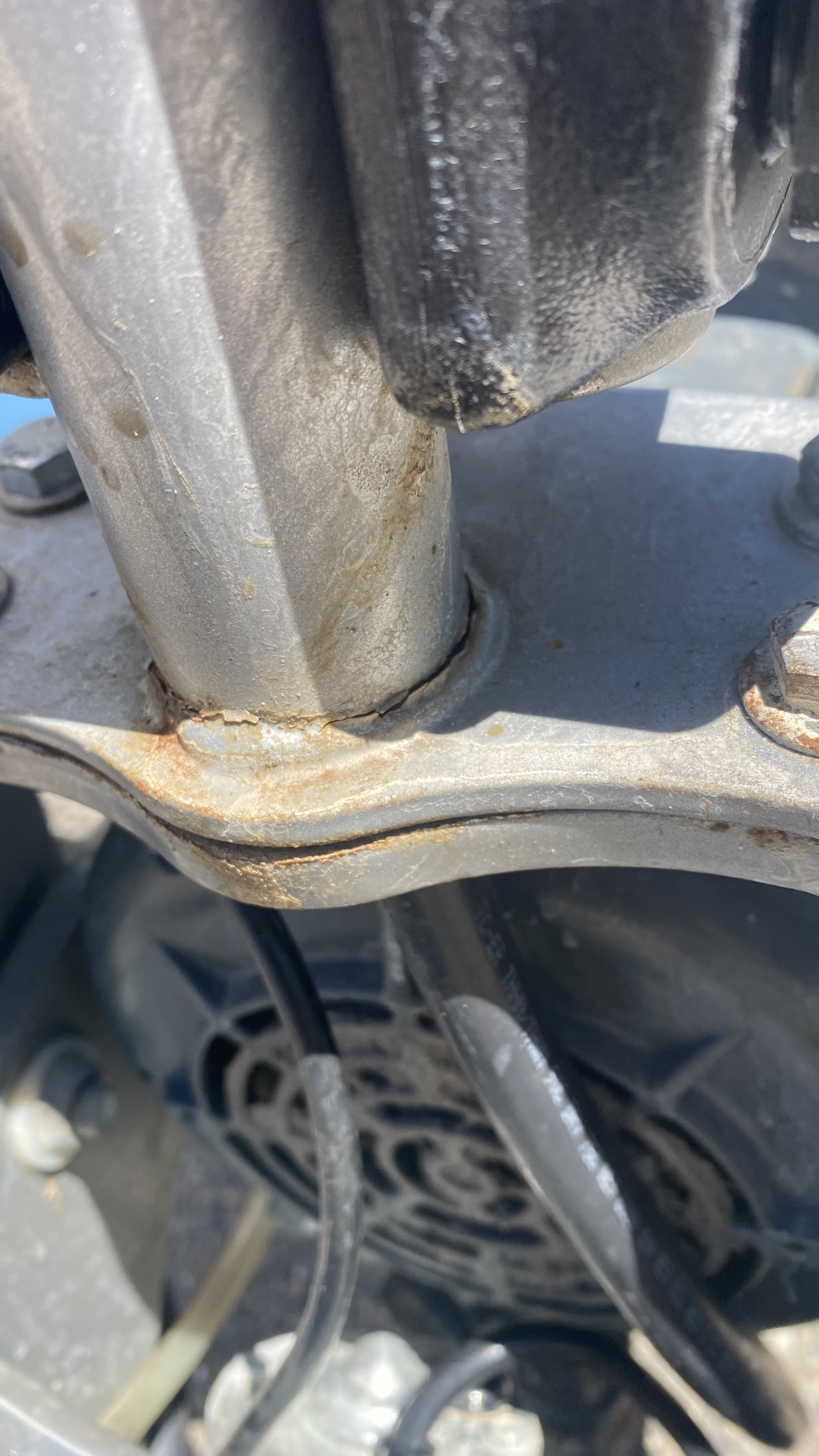

Last week the handle broke on my Vibe. It just snapped off in the middle of a job and was flopping around like a rag doll. I guess the years of riding around in my van jumping speed bumps took its toll.
Today I pulled her apart and welded her back together. It’s not pretty but it will work.

And Holy bird sh!t welds…..You sure you got penetration in the metal?!?
You’re a better man than me, trusting your own welds.. I don’t trust mines, I make my friends weld it.. :lol:
The welds are good. It took me a while to get the arc welder set on the right power setting. Just ugly as sin.
Is it? Did you forget to turn on the Co2? Or is it Flux core?
