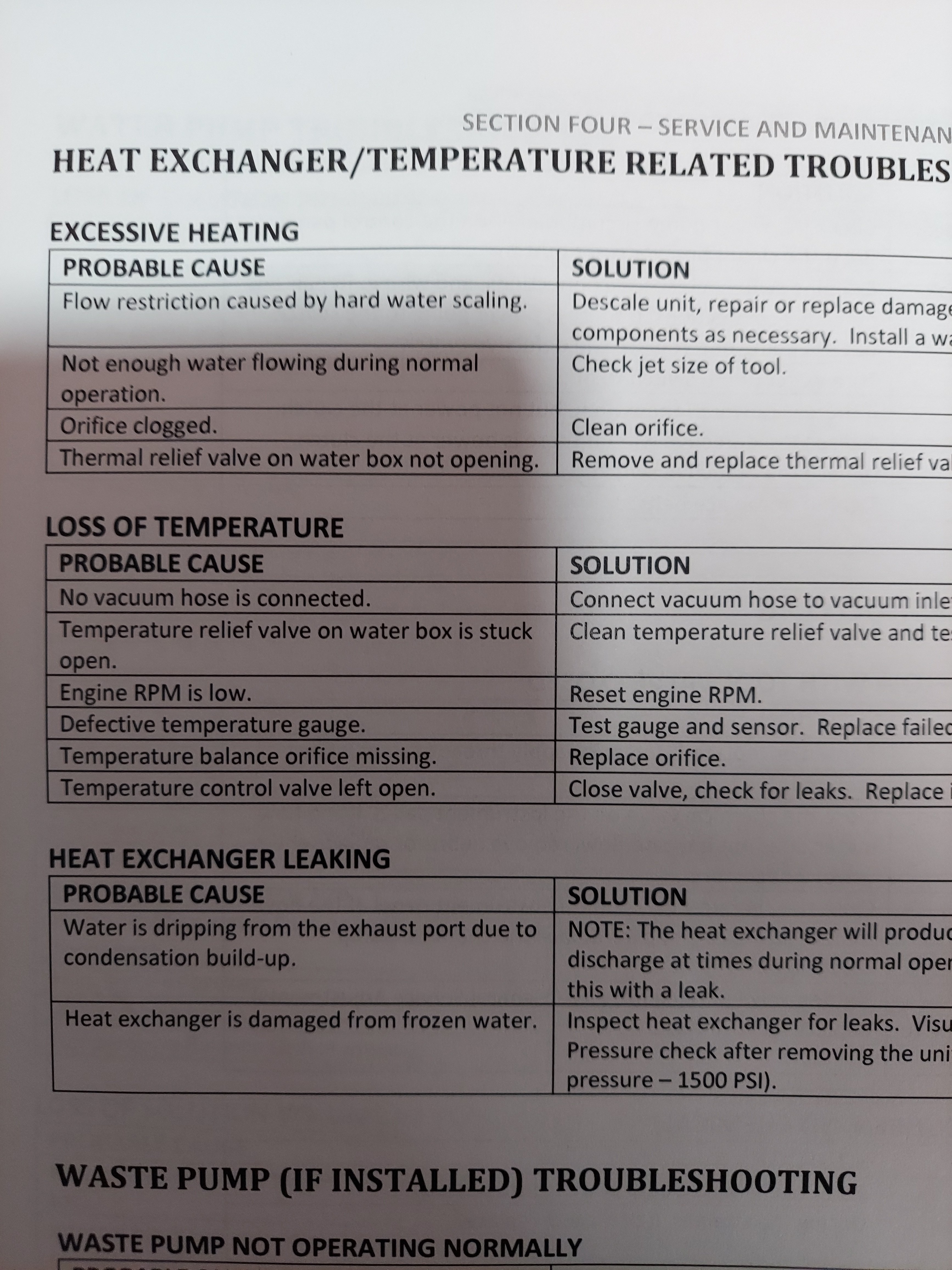

My unit is over heating and shutting down even when waterbox/heat exchanger has water flow.
It only happens when temperature thermostat is on.
Filter is clear.
I think the Bimba needs to be lubed.
Any suggestions

:headscratch:
over fill can blow a seal, but doesn't cause excessive heat.
the flow doesn't make sense either .
How could someone use hand tools or most all upl tools??
I also greased the bimba.
