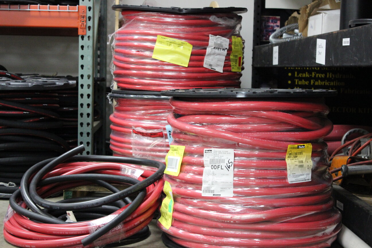

What's everybody doing for replacement TM hoses? Do you just order a 50' section of solution hose and have NAPA cut it into small pieces and put ends on it? How about stainless automotive hose? Where would a man go to get something of this nature?

I have a hose and fitting shop do custom lengths for me. Supply lines and that sort of thing. I buy stainless brake line and flare fittings for wand line replacement at automotive stores.

down the road from you...

If you have a Tractor Supply store near you they have a line of ready made hydraulic hoses that hold up real well.
Both 1/4" and 3/8" hoses from 18 inch up to I forget how long they make them, maybe 60 inches.

commercial marine supply places also carry ready made

before I was able to crimp my own, that's what I did

Thanks, I do have a Tractor Supply nearby. I’ll give them a try.

Hydraulic hoses aren't always appropriate for steam and water applications.
been told that, but never got a good explanation why.
they're rated for uber high pressure and more heat than any TM can make

They are rated for hydraulic oil, not for water.

Fluid dynamic are very different between hot oil which don't vary, and water.
Water, as heated and pressurized becomes superheated steam and changes characteristics, sometimes dangerously.

The brand of hydraulic hose Tractor supply carries is a 100R2AT hose which has a petroleum and water based fluid rating.
I was a little leery of the 1st one I put on my truckmount but the 1st one I put on was from the heat exchanger to the front panel and gets the most heat and abuse. It is still there, years later along with all the others I have put on.
