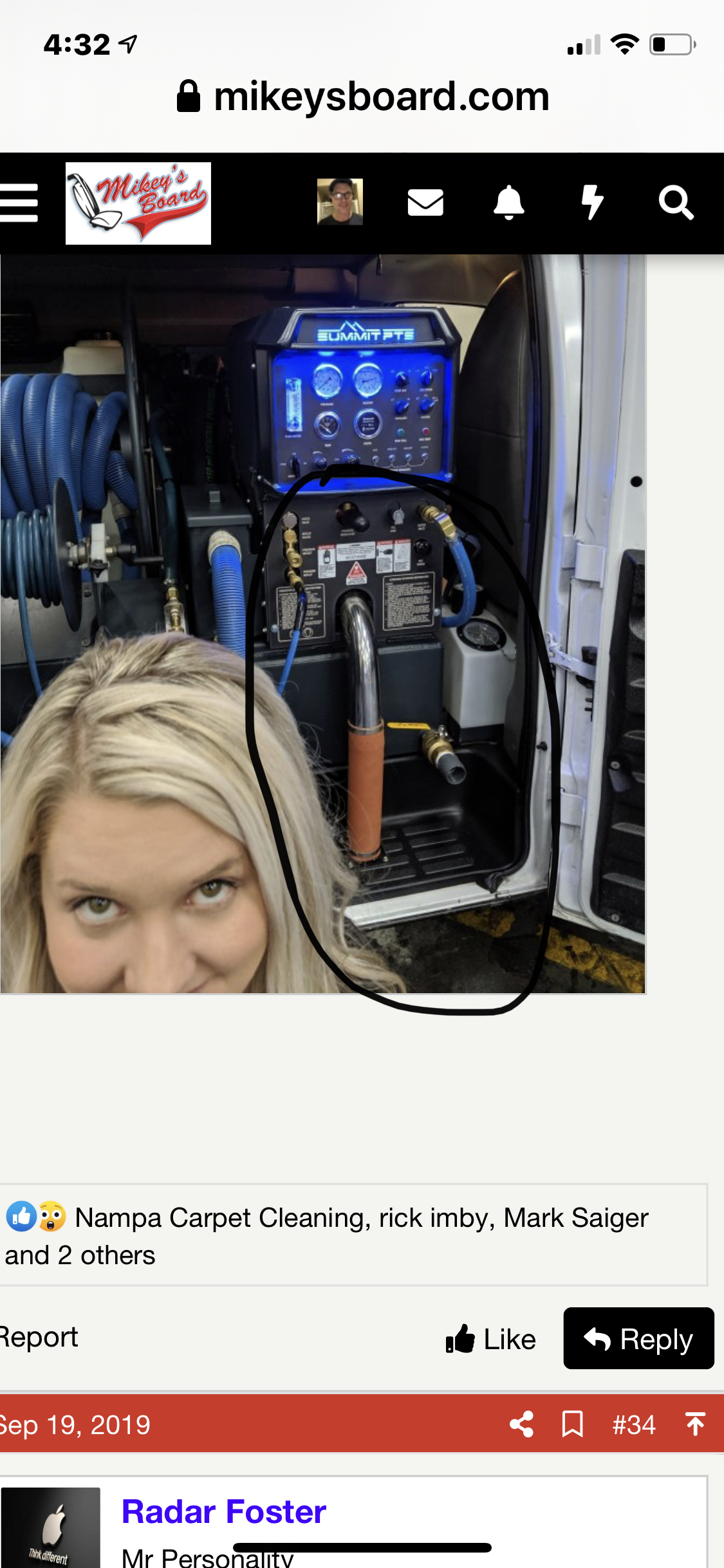

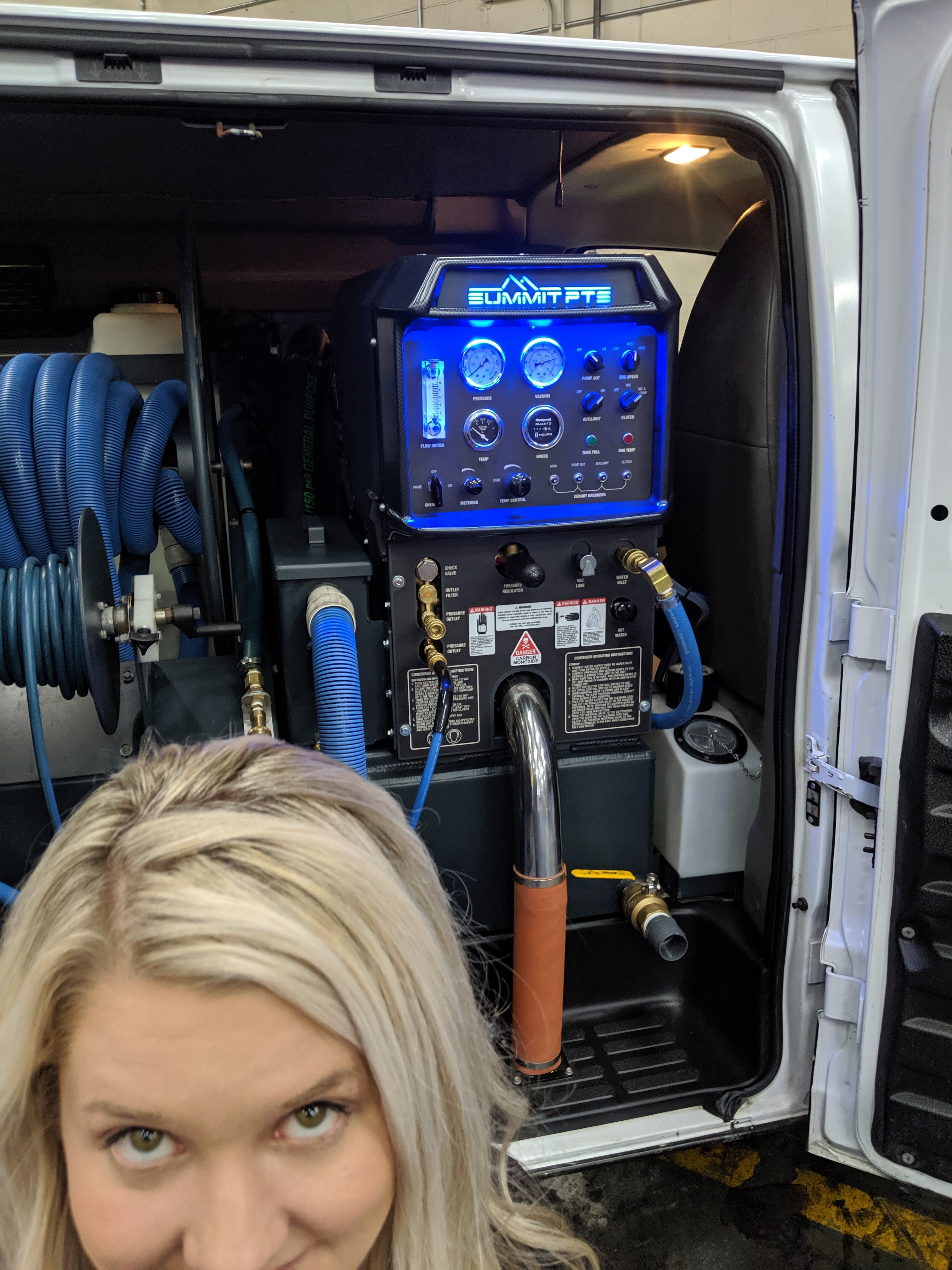

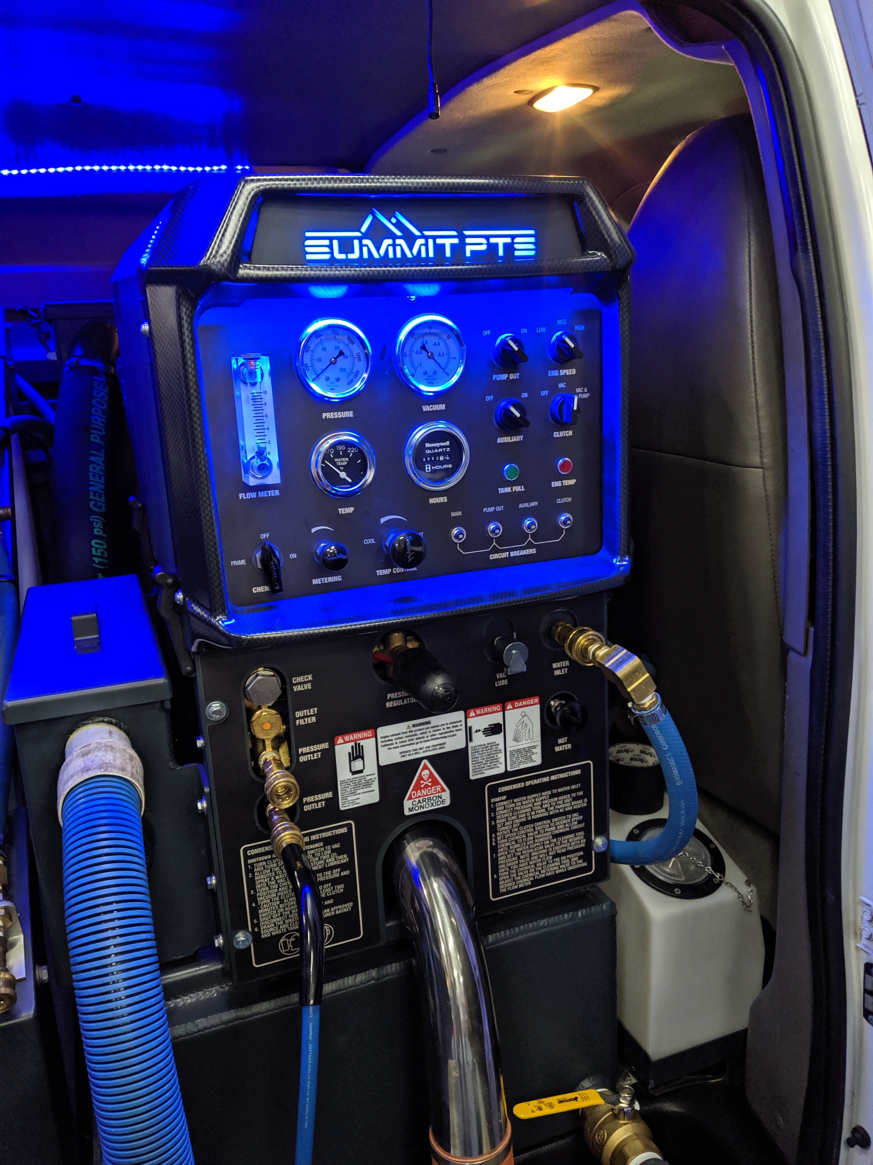

Their "fix" for the heat issues is a direct driven flex fan, no clutch. I'm installing the first one tomorrow but I worry it will be loud as took with the fan running at the same speed as the engine...
Cleaning Professional
11,572
I would strongly consider one but worried about fuel pump heating up. I have a new 6.0L Chevy
They haven’t changed the blower exhaust either
