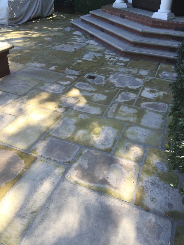

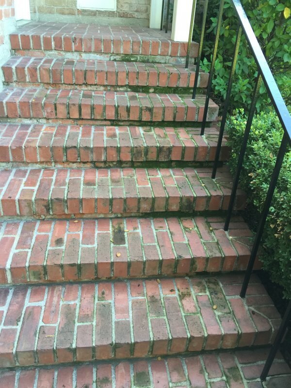

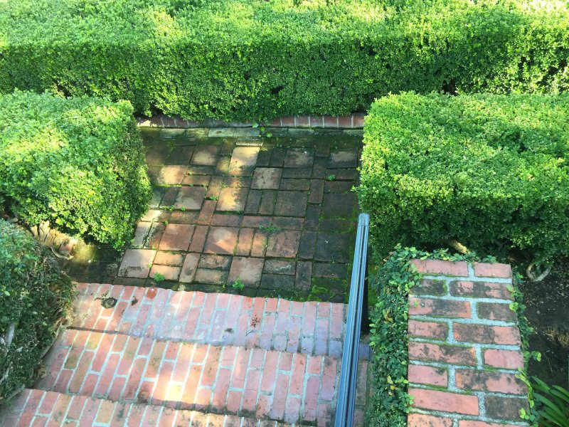

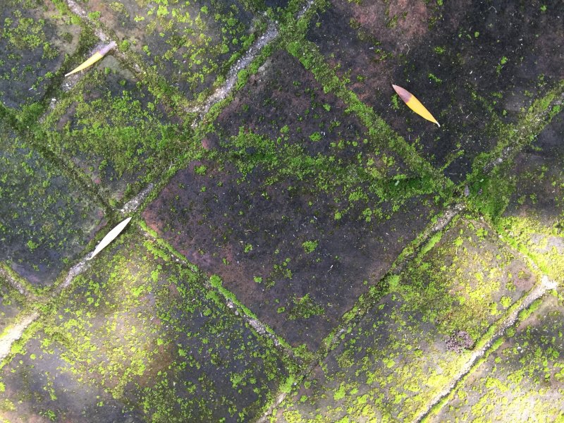

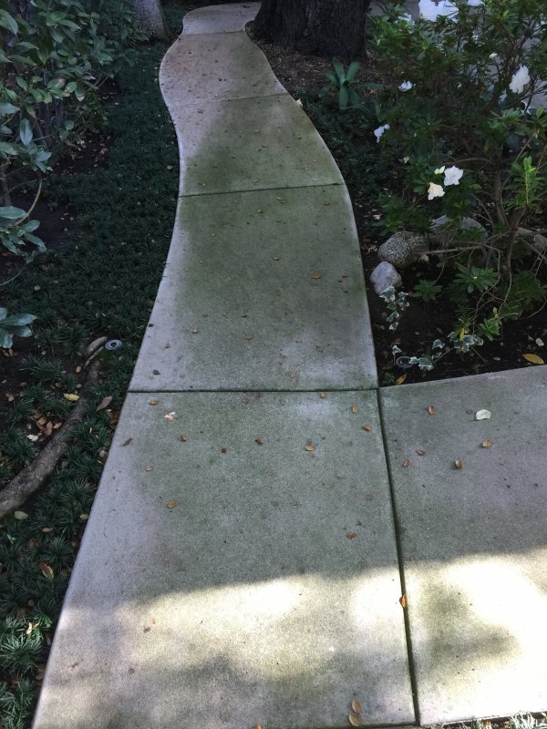

Pressure washing is a quick fix but I am looking for more, I want to kill & slow down the moss\mold growth as much as possible so the areas look great year round, customers exact words are "I want it looking perfect everyday" so cost of product is not a concern, my plan is to treat the areas a couple of times for a few weeks then 175 scrub followed by pressure wash. Looking for suggestions.
1. 50% Bleach\water
2. 50% Bleach\water+trisodium phosphate
3. http://www.mossout.com/walk.htm
4.???

Control moisture if poss.. If low lying... It's tougher battle
Allow more sun
Cleaning Professional
117,387
sure but brick over moist dirt, under that tree, AINT going to say looking like new for long.

Visiting isn't the issue, I am there once a week "maintaing" the interior...she has been a client for 19 years so I know what she expects & will be satisfied with.
Pressure washing has risks associated that I would like to avoid, blowing out mortar & streaking just to name a few.
I could test a few products in the lower Rose Garden, I doubt they have stepped foot down there in years & its pretty bad.

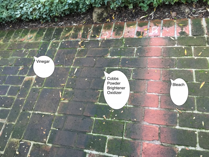

I grabbed some bleach & white vinegar on my way out this morning & had some of Cobbs Powder Brightener Oxidizer to try, sprayed all 3, gave 15 minutes of dwell & then scrubbed, vinegar did nada, Oxidizer fizzed but the bleach was the clear winner (did not rinse, wanted to leave overnight for further observation)

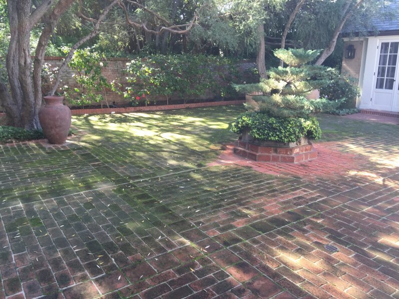

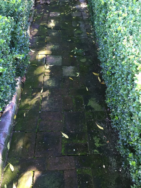

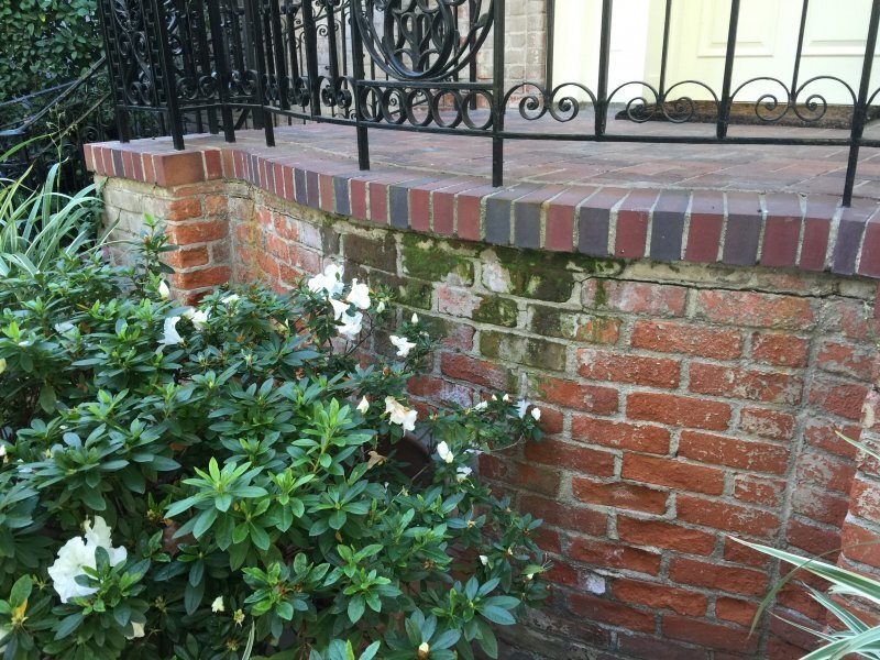

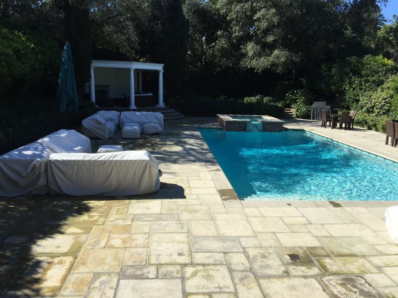

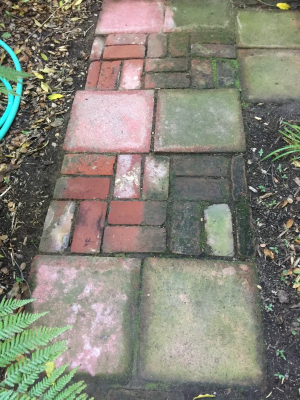

More areas (Client has had pressure washer issues in the past & warned against streaks & damage so cant just blast it away)
I remember Ken Horton saying he had a client with the same problem. He had a slide show with an upscale property where they had trees on this huge sidewalk that would create the problem. He had photo's of where they treated it and it didn't grow back.
I don't remember if it was his product (Bioprotect) on one of his concrete products. http://www.bioprotectionservices.com/
Reactions: Jim Nazarian
What ever it was and it may very well be the Bioprotect because it has the residual fighting ability, worked very well. He said they had tried numerous products until they used what ever it was but it did the trick.
Looked just like your pictures but a side walk at a mansion.

Thinking of using D2 in the critical areas like the steps & around the pool & looking for something more cost effective in the other areas.
I saw http://wetandforget.com/product_wet_and_forget_outdoor.html on the Home Depot web site & thought it would be to weak of a product since it was available to consumers, but I will purchase some & add it to our testing.

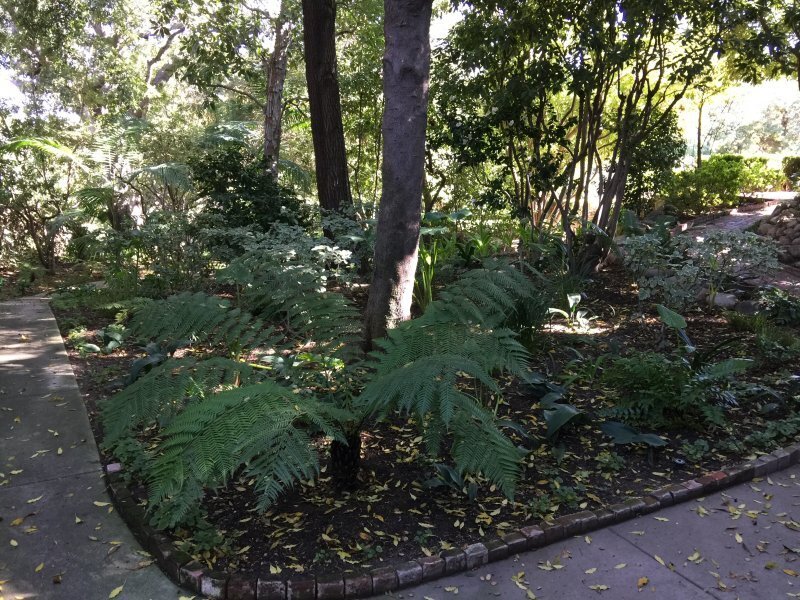

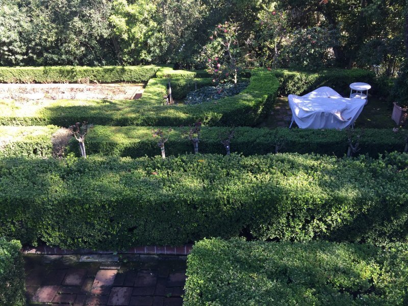

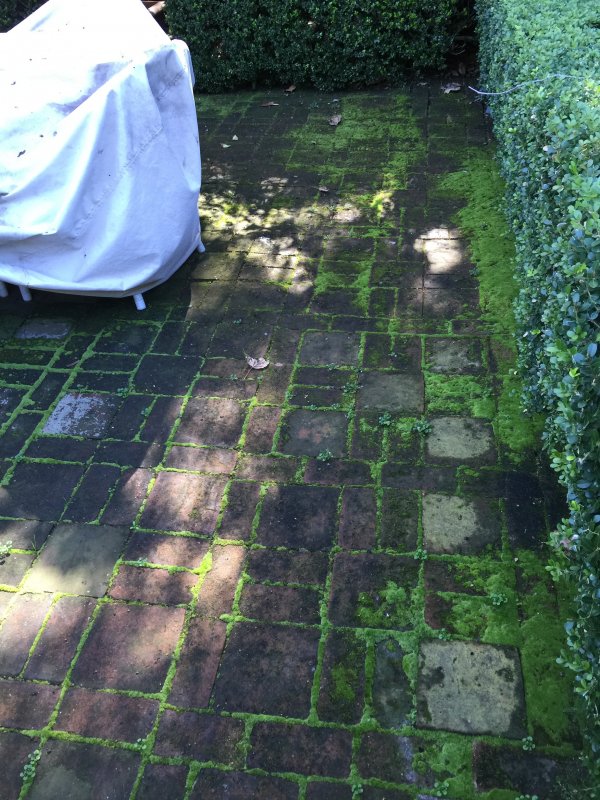

A few more pictures I took today of "Mossvilla"

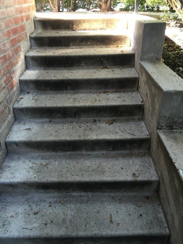

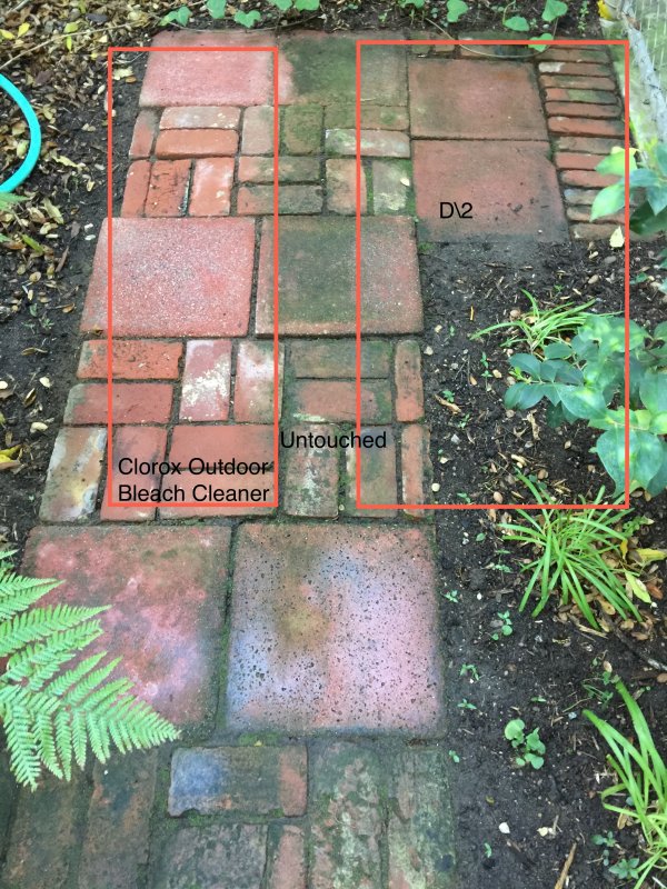

I did a quick side by test, Clorox Outdoor Bleach Cleaner on the left & D\2 on the right (middle kind of untouched) (Clorox was 50 % water dilution)
Spray-15 minute dwell-nylon broom scrub, rinse off.
If appearance & cost were the deciding factors Clorox would be the clear winner, I assume D\2 will do a better job "killing" the bacteria-fungazide & might slow down regrowth but at what cost?
More testing of d\2 next week, thanks Cameron for everything!

Doesn't look too bad, but what you're dealing with is some heavy growth. I have used that concentrated bleach before, it's gnarly stuff.
