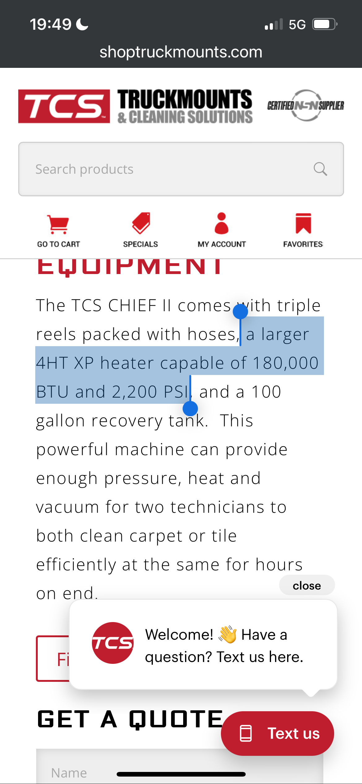

Looks like the 180,ooo BTU heater comes with the Chief 2. Is the heater external from the unit, or is it housed within the unit (ie: enclosed within what's shown in the image of the link provided)?
If I go with this unit, in addition to what's listed, I will need a propane tank and I should be good to go, right?
Finally, to confirm, the Chief 2 will be able to comfortably do carpet, tile/grout, and water extraction with ease? Or will it still struggle?
Edit: I can't seem to find any information on PSI for the Chief II??

The pump is capable of 2000psi....which you won't need
I believe the 4ht extreme is included which is also good to 2000 psi.
You would be able to high pressure clean with heat
The heater is external to the unit

The chief 2 will do everything well. The heater is a separate from the machine. I'm not sure if the pressure but the heater is rated for 2200 psi. Most truck mount pumps will give you at least 1000-1200 psi. Some a little more. You can confirm that with TCS. They should have everything you need, including a belly propane tank. Let them know the make and year of your van and they should be able to give you a quote on installation.

49,307
TCS heaters have a max pressure capacity of 800 psi.
Chief II has a 4ht “extreme”
4ht comes in high pressure 1000psi and extreme 2000psi
Looks like the 3ht has that option too
Reactions: alexcarpets
I will be looking at going with the "extreme" if I go with this unit. That said I have two questions:

1. The heater only heats the water but the coils/plumbing are rated to 2000 psi
2. The 4ht has plenty of heat. You are going to be using much closer to 1.25 gpm than 3.75 . And that is constant flow which you will seldom use. In normal use you will get higher temps up to the high temp limit of the heater.
