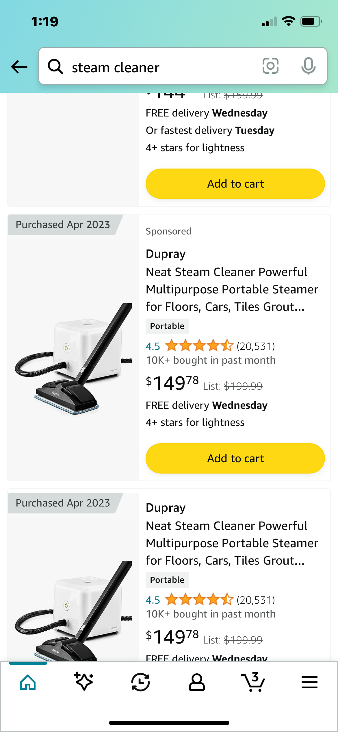

It’s almost always a good investment to start out with a TM if you can swing it, but if you have to start small then go with the standard 500 psi portable and pick up a small steam machine to help with grout.
The flat mop head shown in the picture is worthless but it comes with a good grout tool.

I appreciate you sharing that, and it's definitely an option. After having some discussions, I think I'm gonna have to just take out a loan and grab a TM.
