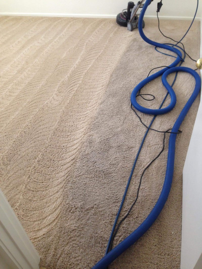

Quick question? Lately I've had a lot of polyester carpet with dark wear in the high traffic areas. Usually I can get rid of it but lately it's fighting me. I'm using Flex powder and Prochem All Fiber Deep Clean. Sometimes I hit it first with a quart of Prochem Power Solvent (spray trigger installed) then RotoVac it, then clean as normal - it's better but not to my liking? Is there some trick here I'm missing? Ty (yes it failed the nylon acid test, and it smelt fruity, and it was black shiny and hard after the burn) - the attached photo is usually how I clean so you can imagine my frustration with these dark wear areas.

This carpet is white, they have a dog, cats, and a creek / pond. He vacuumed with a Dyson, they I did with a Shark (filled my canister) and it still plugged my external screen filter outside (lost all vacuum) just a massive load of sand, soil, dog hair, etc (nasty) there is way to much crap in that carpet and it's wicked up brown now for the 3rd time / cleaning.

Load of sand=lots of abrasion. The carpet is distorted/etched. Think of rubbing sand on a new piece of plexiglas. All that sand was rubbing on fibers each time they stepped. No amount of cleaning can bring back fiber distortion.

Use an ammonia based protein spotter. Mist over the area well. Agitate it in.... extract with brush head.
The ammonia is really effective at cutting it up.
When done encap the darkened areas. It'll come out better.

I bet had the base of the carpet been checked prior to cleaning it would have shown soil saturation = dark, which would explain the repetitious wickings.
The other darkness is likely to be deterioration and the carpet does not reflect light as well in these areas.
Agitation and stronger products will only help some but not solve the problem. May be a candidate for that CTI product (forgot the name) that adds reflecting material to the carpet (you apply only in damaged areas). Never tried it myself.
Optical Brightner or bag of sparkles from arts and craft added to encap shampoo. The latter must be pre-approved by JiMmy.

A high soil load under such conditions is inevitable without full-time Wernering, which is not going to happen in reality.
Expect it to wick, and try to sell them 6 month service which will consist of HWE with a follow up padding using a stiff brew of encap-anti-funk to remove any wicking and further counter any odors.
Under those conditions, I would really want to shy away from getting it even lightly wet again in an attempt to correct it.

Why didn't you tell them to put a good Nylon down in those 3 rooms instead of hardwood? Dogs and outside dirt being brought in the house is gonna scratch that hardwood up within the first year and double the airborne allergies with no carpet.
And it seems like you've lost a good customer by telling them this. I strongly suggest using a butyl based prespray if you haven't done so in the past. It's worth going back for just a test on it. It'll be a good free education for you, and it'll help keep your relationship with your customer.
