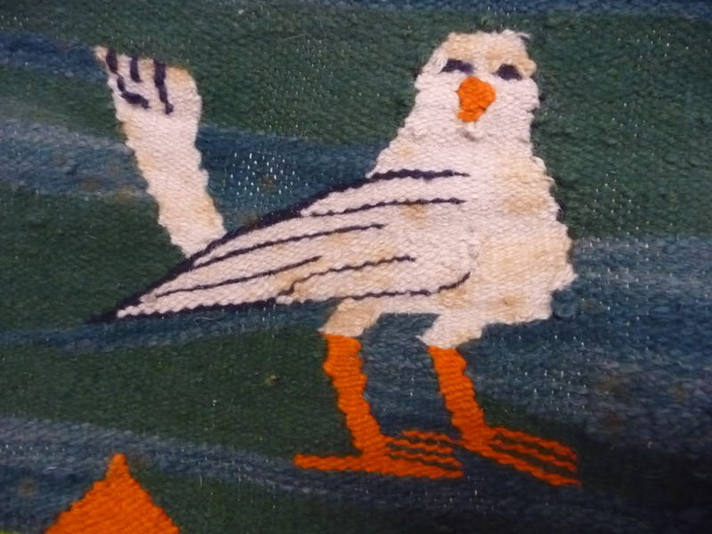

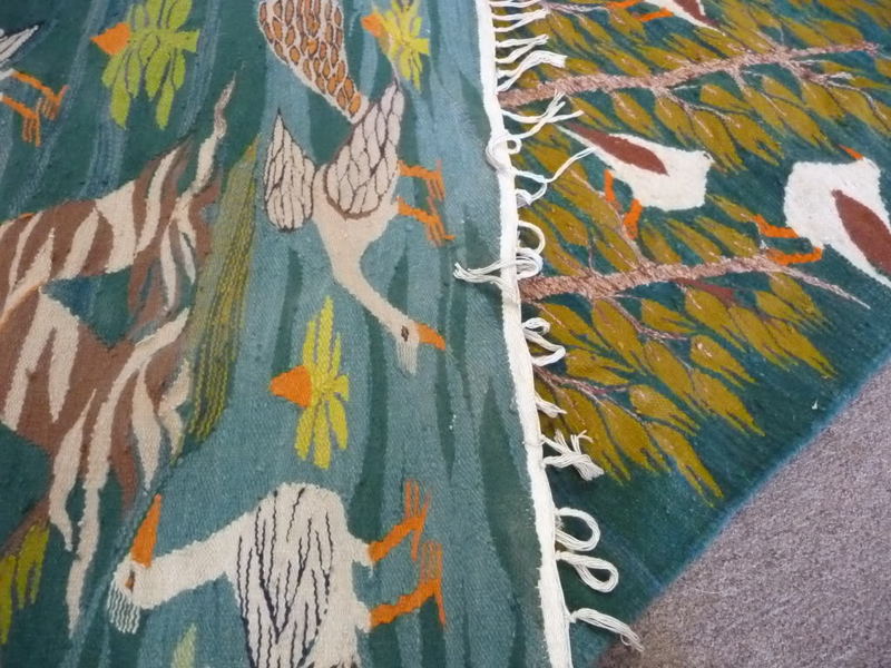

OK rug guys, whats going on here...
117,373
Owner says its been on a wall for 19 years and hanging over a sofa for a few more.
Never cleaned.
So whats your best guess as to why all the color movement?
Looks like it got wet and rolled up to me. Should I attempt to strip out the orange from the white?

On my monitor it looks like something was spilled on it and attracted soil to the fibers i'd wash before breaking out the sledgehammer
it looks like a Polish tapestry

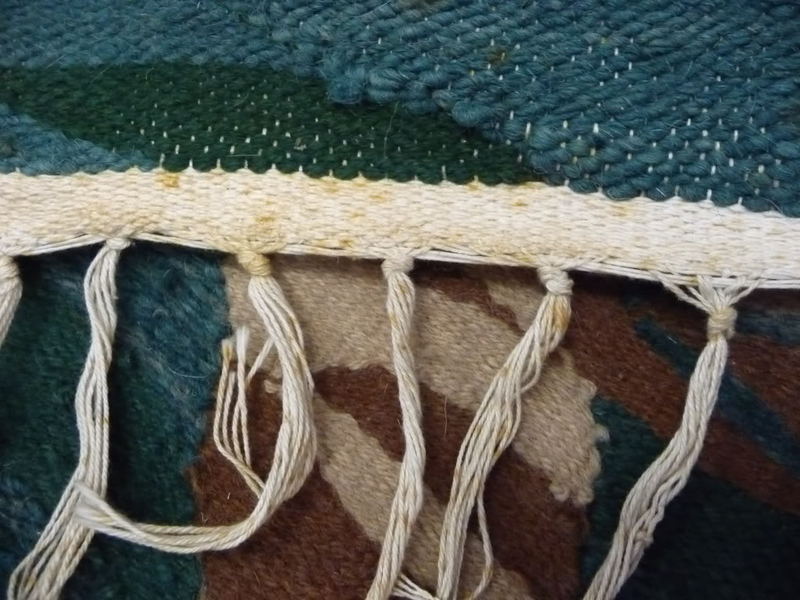

My best guess about the spots is humitity spots. Like the spots you get on your white dress shirts in the closet and on white cotton upholstery with down filling. Again, it's just a guess. If it is, most likely permanent. Takes about 5years or more to start showing up. You can correct with h202 but a slow process.

Calling that a tapestry is kind of like calling comic strip art the Mona Lisa, don'tcha think Harry? :-)
Fon Johnson
It could also be bug poop, possibly spider. If it is, it should wash out.
And NO, I'm not joking.

Mikey, it almost looks like a browning situation. Did this happen after cleaning? if so, try recleaning the rug and drying it up side down with an air mover blowing across the top.

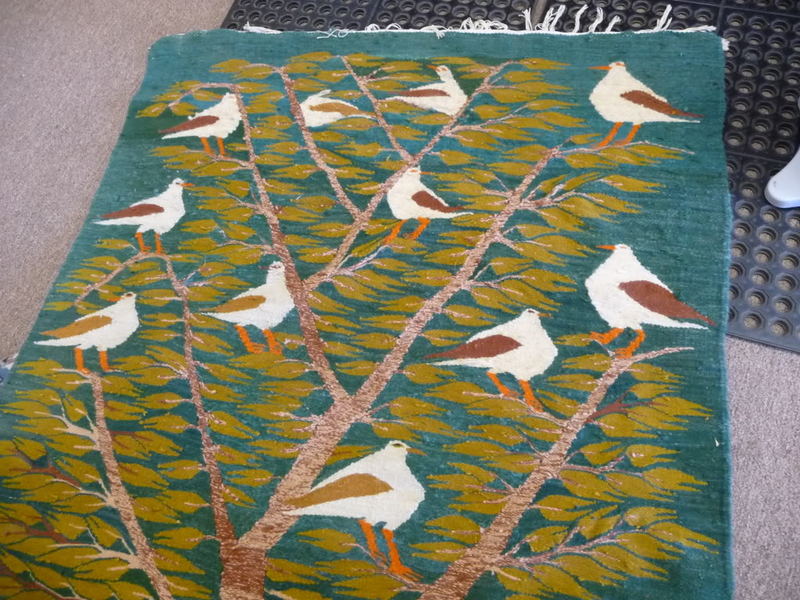

I cleaned it today. used MB Dye Set which didn't do squat. the pre sprayed with MB Fine Fabric Shampoo and extracted with a uph tool.
No running, looks much better.
But yeah, fabric is loaded with flaws and crap.
I couldn't tell if the orange went away while it was damp.
I'll take more pics when dry.
117,373

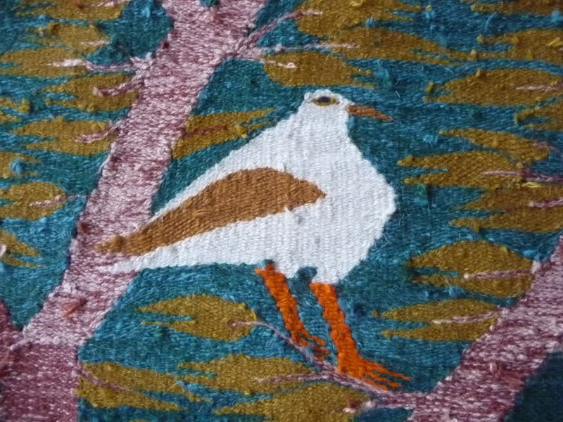

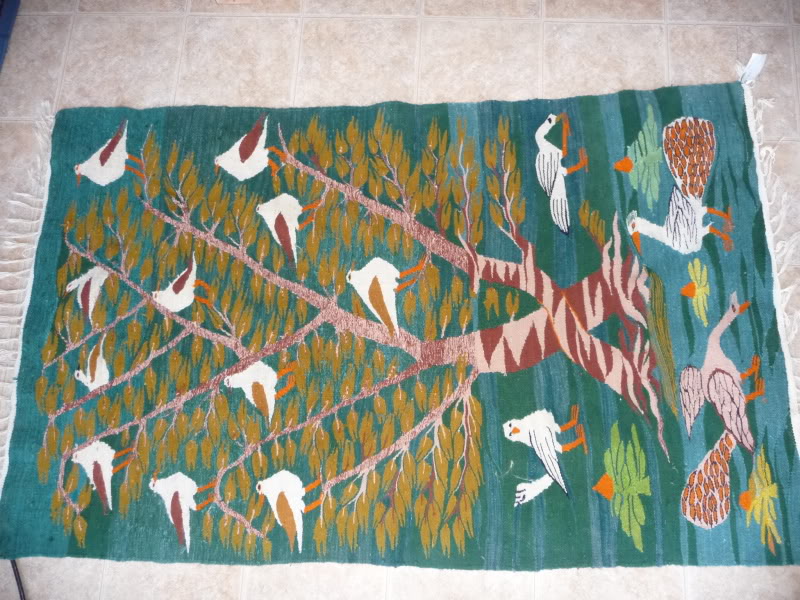

OK got it cleaned.
Most of the green and orange that moved into the white is now gone.
Some is still in the fringe.
Way better.
Cleaning took about 45 minutes. $175.
117,373
What ever MB's Dye Set is.
I used that first, shampooed it with their Fine Fabric stuff and soft water rinsed.
No touch up needed.

There really is a certain satisfaction to restoring these hand made goods that you just dont get from degreasing an acre of Olefin.
Looks great Mike!
I didn't think it would clean up as well as it did. I bet she will be thrilled.

Mikey... Next time do a pH test. Just a guess, but it looks very similar to cellulosic "burn" caused by an acidic chemical such as flame retardant. The scenario fits, too. Occurs spontaneously over a period of months or years and gradually gets worse.

After looking at those pictures more closely I think it was spotted browning...just bits of moisture in certain areas that caused it. Either way, it looks darn good now.
