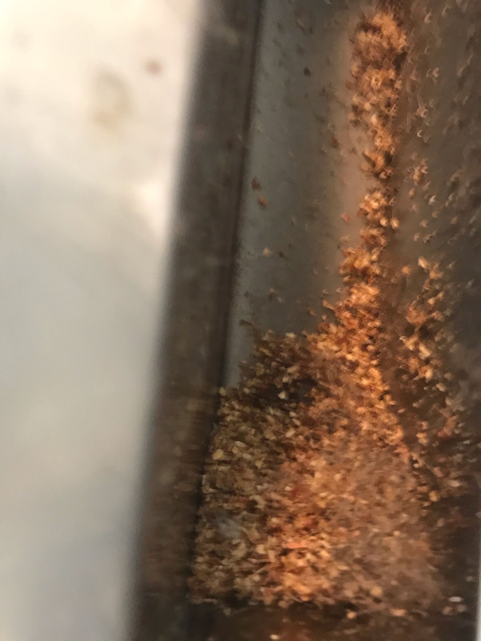

I was called in for some help where a cleaner couldn't get a cat odor out of a carpet. There were a few reasons that they didn't get the odor out, but one that I hadn't thought of much before:
Note the amount of "Kitty Litter" in the Renovator of my Brush Pro; this was from just one corner of the room where the two cat boxes were kept.
Getting this odor soaked litter out of the carpet went a big way to solving their problem
Treating the baseboards, walls, and getting rid of some furnishing the cats "used" took care of the rest.
Unlike dogs, cats like to just jump up on and "go" all over everything.

Hence, the use of vacuum cleaner, crb and black light by true professionals.. It is what distinguishes us from the idiots.

I'll pre-spray the shit out of them and then run the CRB to get cat litter and sand and hair out and then rinse it...

Only use UV light for YOUR diagnostic needs, not to sell the job. It will come back to bite you. Did one for a lawyer today that we ran the CRB both pre and post prespraying. Vacuumed the shitlins' with the TM hose.
Cleanup is easy, pop out the brushes and hit with the pressure wand as we wrap up.
