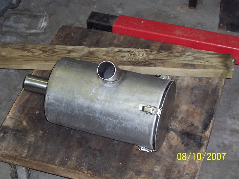

Tony Neville
This is what we did for a simple bullet proof filter.
Tony
