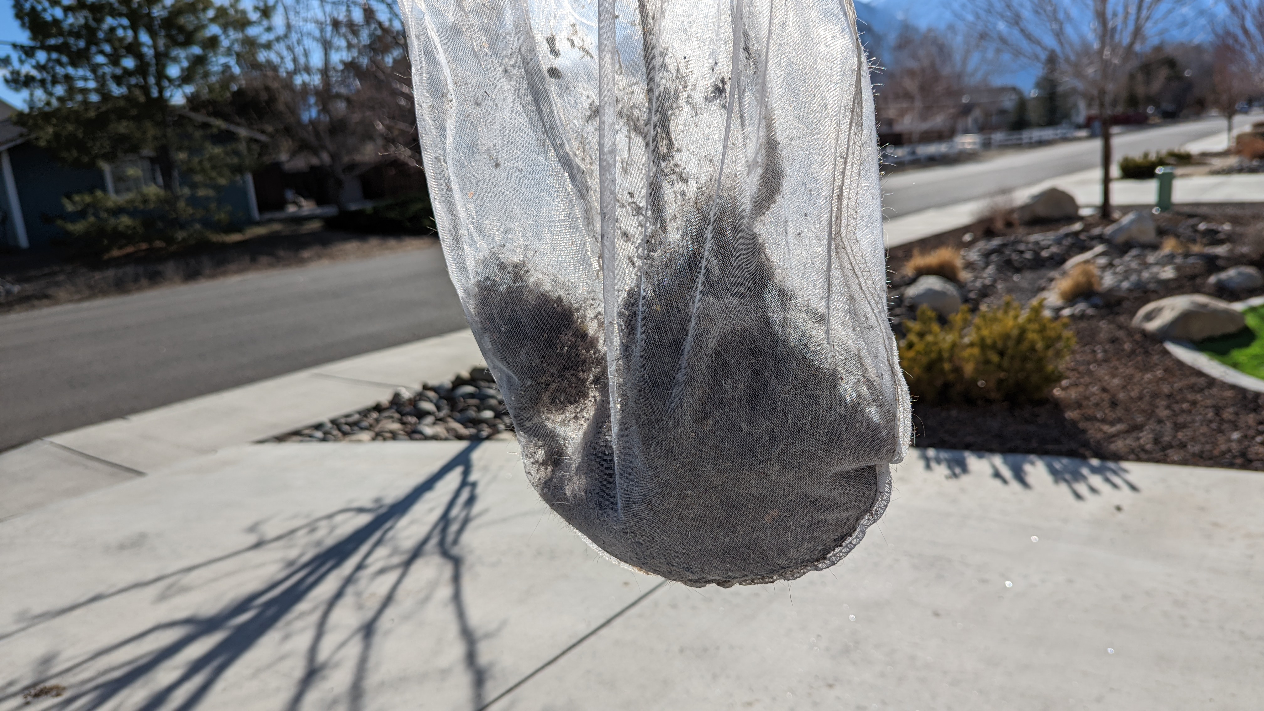

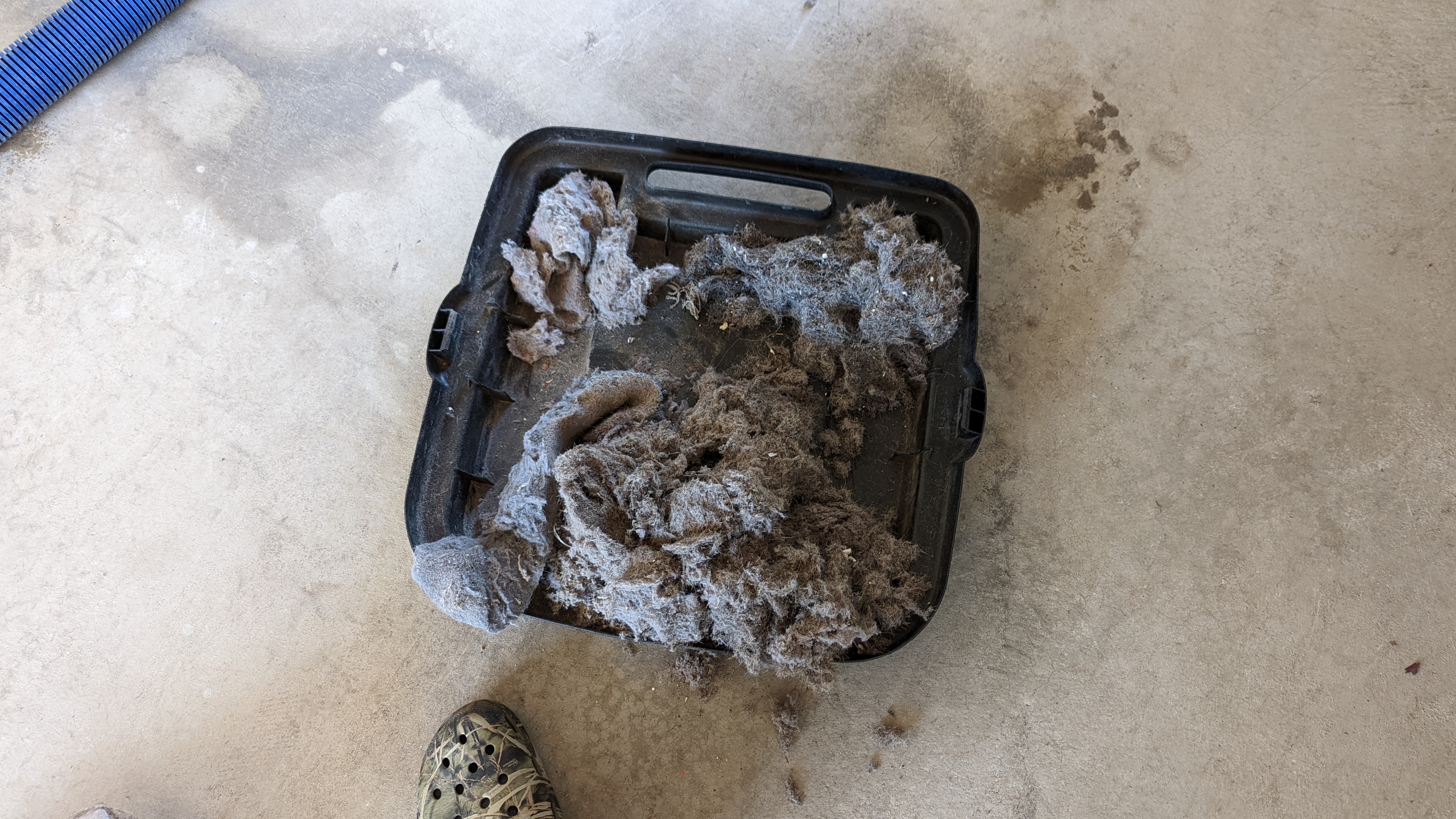

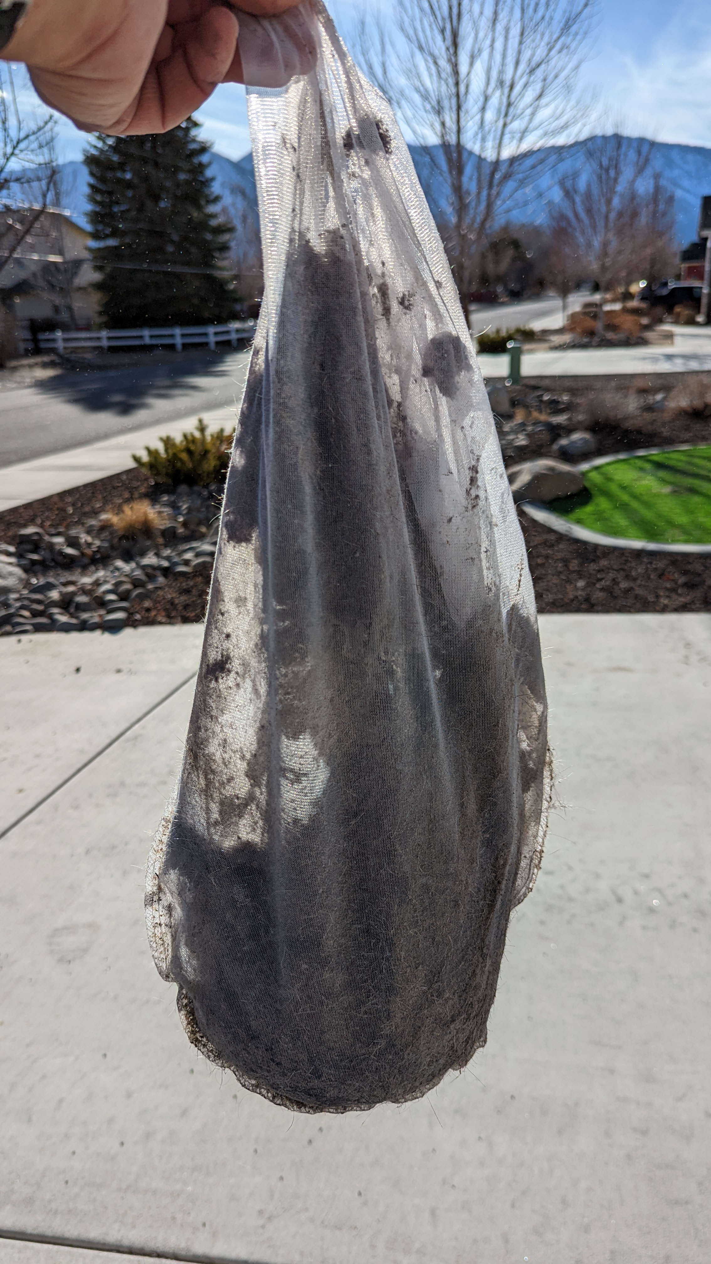

:eekk::eekk::eekk::eekk::eekk::eekk::eekk::eekk::eekk::eekk::eekk::eekk::eekk::hopeless::eekk::eekk: PXL_20220308_233531364.jpgPXL_20220308_234901950.jpgPXL_20220308_235602009.jpgPXL_20220308_235653862.jpg
We have two dryers/ vents. One for carpet cleaning rags and one for our household stuff. The smaller bundle of goodness is from the household...

I entered one side with 1.5 inch vac hose hooked to the 370Tm and used a Doggy blow dryer from other end to clean dryer vents.

we do lots of dryer vents. if you have a decent air compressor you just need a non rigid air line and a reverse skip ball. You can put your air line through a small wiffle ball to help bend corners if needed. small compressors wont work you want at least 150psi

If you're blowing out all the way, how do you go about containing it and what do you charge prevent and what liability do you take on if a pipe comes loose..
