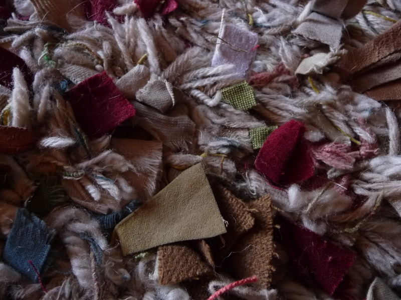

hey Hyde, ever cleaned one of these?
117,379

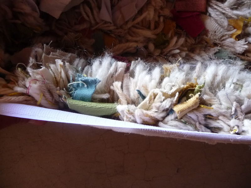

It's Velcro'd together in 3 sections due to how thick and heavy it is.
Can you tell me what tribe made it?

thats one ugly rug i've cleaned indian rug rugs but nothign exactly like that is it home made ?
the kindergarten tribe from Mrs Herman's art class
Mrs Herman was really cool, but a weirdo (Saturn Cafe type weirdo)
That uglEE rag is something she'd have in her home
I recall seeing something same/similar years ago.
Think it was used as an entry/foyer rag
I don't recall whether we cleaned it or not

we see a couple of those a year~ butt ass ugly (I like the chex mix comparison). We wash-em

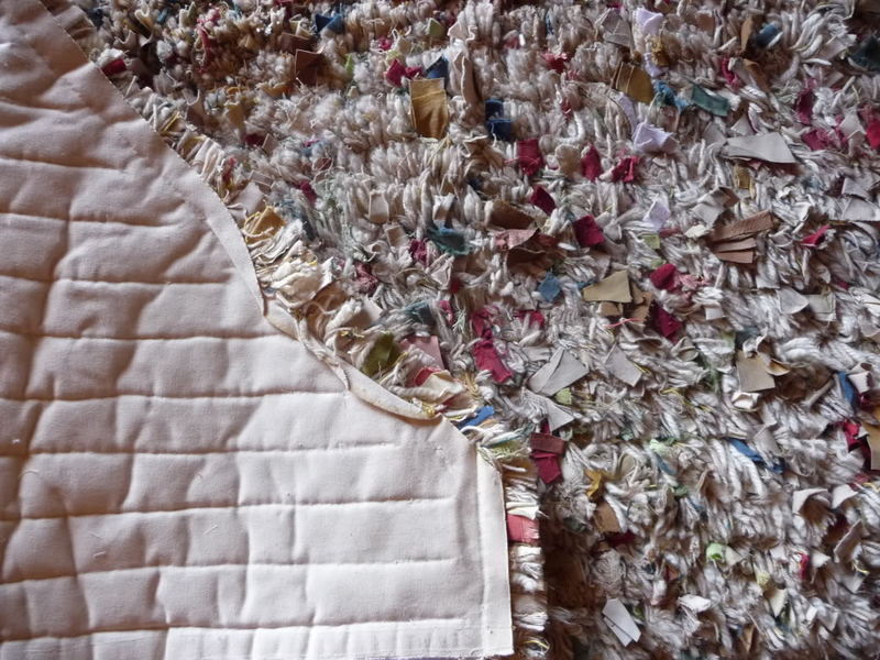

We have sold a few of these out of our shop.. Some people wanted them so we have always carried one or two for those nitches. They usually are constructed well. But smell the back before washing. If it smells like bad latex then prequalifty with your customer. Otherwise, wash the crap out.

If you wash it expect the deep colors to bleed. That magenta and denim I see in the pic are suspect and the leather will stiffen. If there are no bleeding issues we'll wash these, but we have a flatbed washer so the rug isn't wet for very long.
It can be cleaned with a wand on a tack-out floor, you'll just leave a lot of water behind. Each tuft is hand sewn and aggresive agitation will tear some loose. Many of the ones I've seen have a soft back with no latex and can be immersion dry cleaned.
PS: I say send it back to the guy that sold it and tell them to clean it. :twisted:

I did clean it actually. Dry foam, and an internal jet tool.
We've washed a few rag rugs, check for color fastness and thread strength.
We get all kinds, home made, professional, had one made with her fathers ties (we drycleaned), we also had one that the mother had made of jean material from the time the daughter was a child to adult hood. (HWE hand tool).
They seem to be getting more popular, many we HWE flat, flip and do the other side as we do braided rugs.
