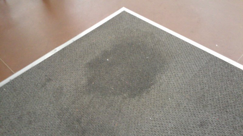

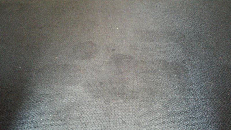

I'll go and take a pic of the other side to show u the spills that they want gone

Here's the trashed side

14,316
Incorrect, it's used as part/day two of a true restoration process.
Day one, dry and wet flushing of the carpet.
Day two, polishing of the dry carpet.
I agree fully. That's why I was planning on getting some absorbent pads for my 175 if the HWE didn't do the job.
