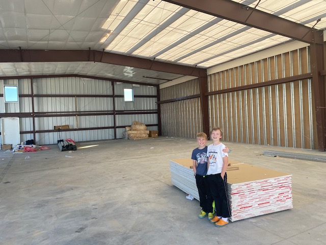

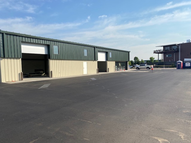

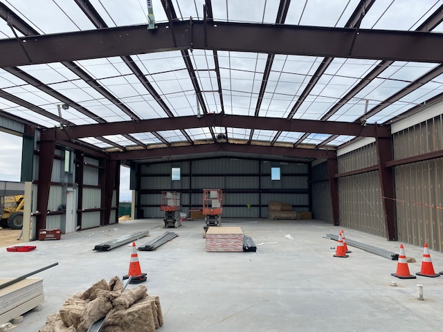

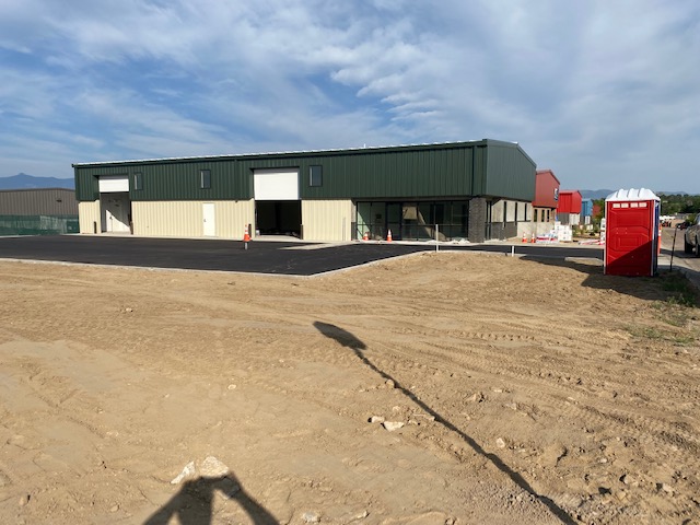

After 15 years or so of carpeting cleaning I am moving out of my 3 car garage to a nice warehouse that I am having built. It should be done in about a month. I would like to epoxy the floors and am looking for input on what brand or any advice. I been looking and there are so many option ranging from $3-30 grand. I am OK with paying more if it is worth it. I just do know know. I did epoxy at my garage at my house it was just the cheap stuff you get at Lowes and it has held up pretty good for the last 20 years. What are your guys thoughts.
It is a 5000sq ft bldg with about 1000 sq ft office area.
