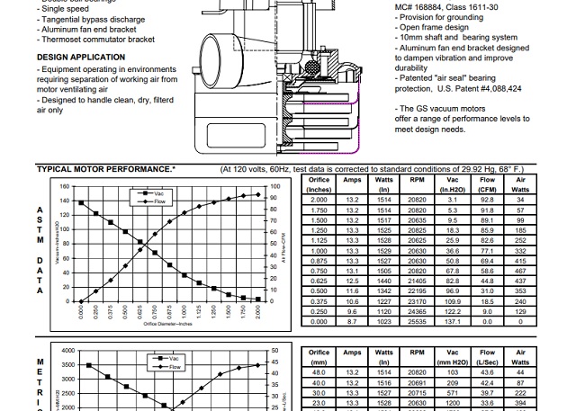

FB7777
Well the thread is about electric truckmounts.......
A vacuum performance curve would be helpful in determining the performance one could expect running their porty from the truck.
I know it can be done
You seem like the guy to ask. Ed is too busy pretending he ran an 11 truck resoil empire.........instead of saying he is the manufacturer of the unit in the op (he'll say that is my fault)
