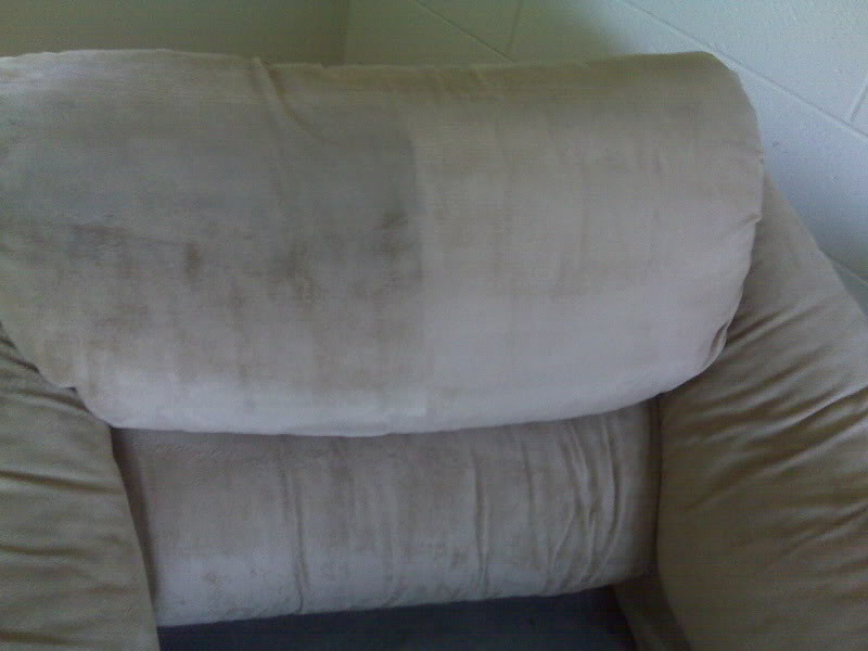

microfiber is synthetic and usually solid color equals a good strong prespray, aggitate with a horse hair brush, extract with an upholstery tool, brush with a carding brush, collect check and walk away
A
americlean
I have one local company who refers their microfiber cleaning to me. I don't know why. I have never had a problem with them. I did 3 this week and all came out great. Lower the temp and psi and your good to go.

I love microfiber. It always cleans up great for me. Cleaned one the other day that a kid had done allot of artwork on with a black marker. It looked like new when I was done. I use the Prochem tool and the mist and vac method for areas that do not need much cleaning. Microfiber that has been treated with protector sheds water, so you may want to take a towel if you are working on a hard surface floor. I will take Microfiber over light color cotton any day. No bleeding no browning. Make sure you groom the fiber with a towel or brush before it dries.

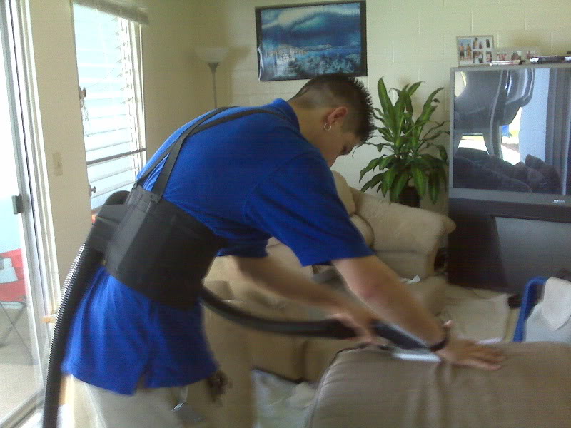

I agree, drimasters are terrible on microfiber. It's like taking a shower. I break out the trusty ol' hydry and let 'er rip.
S
Spurling
If you keep the fabric tight with one hand .. using the drymaster is the perfect tool .. no overspray, running water or dripping.
