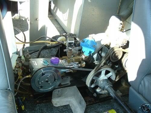

Alright, who can post a picture for me? I'm computer illiterate. I'll show you something to demonstrate an obvious example. How long has the 5.8 been in designation? A long time. This whole rpm,cfm,clutch torque issue has just been coming to light in recent history so I'm more than happy to share my findings with anyone who has interest. I was just as ignorant as everyone else up until I decided to build my own machine.. And I think Butler is #1 in quality so please don't think otherwise.

Here is the Pic

Now take a look at the pulley on the driveshaft and then look at the pulley on the blower. On Butler, Steam genie, Cleanco Classics and White Magics (maybe others too) the blower was driven off to the side so the engine of the van would run anywhere from 1200-1600 rpms while turning the blower at a faster speed. This was done to save gas and so the engine wouldn't overheat. Remember the old Hydramasters? They were a 1 to 1 ratio. The Vans engine had to run at 22-2400 rpms to get the blower spinning that fast. They had overheating issues then. Now with their overdrive set up, they can still run the blower that fast but the engine is now down to 1500rpm or so like the rest of us. Back to this pic. If the vans engine is running at 1500 rpm on the high speed, that means that shaft pulley is spinning at 1500 rpm or there abouts. I estimate that shaft pulley to be around 7 inches in diameter and that blower pulley to be around 5 inches in diameter. So if that shaft pulley is spinning at 1500 rpm, what do think the blower is spinning? Use some common sense. Even IF the blower pulley was smaller and was driven 2 to 1 that would still be only 3000 rpm. However, it's not. That blower was spinning about 2150-2200. A clutch can only take so much. Especially the ones used at the time and some still today. It is what it is...

Thanks Matt,
That is actually about where I thought it would be. Those under driven figures explain alot to me. Thanks again.

A visual always helps.. Another thing I'll throw out there. There's a few ways to change the blower speed. You could put a larger pulley on the driveshaft, but then you have a large weight hanging on the end which can lead to pre-mature bearing failure. You can put a smaller pulley on the blower, but then you have a problem with belts slipping. I tried this but when the blower starts demanding power under load there's not enough surface area covered by the belt to get a good enough grip on the pulley. Thus you have belt slippage. I went down to a 3 inch and it was terrible. Next, you can try a combination of the two and it helps but only a little. Finally, your big solution is raise the engine rpm. Let's say your constant blower speed will be 700 rpms over the shaft speed no matter what. So, in order to drive that blower in the 3600-3700 rpm range you'll need to run that V8 van engine around 3000 rpms. How's that sound? It sounds like a gas hog nightmare and overheating issues galore to me... You gotta just take it for what it is. A simple single wand system with great power for 100-250ft. hose runs. That covers alot of ground for most cleaners but it won't cut it for everyone. Take a look at a slide in for a moment. Whether it's a 2cylinder Kohler or a 4 cylinder Nissan it doesn't matter. Both of those engines with run great in the 3000-3500 rpm range all day long and not kill ya on your fuel bill. At a 1 to 1 ratio you have complete control over that blower speed for the entire rpm range. If you want 1500 rpms for upholstery dial it in. If you want to run 500 ft. of hose and need that blower at max speed then dial it in. That's a benefit of a slide in. A benefit of a clutch drive is the massive volume of hot engine coolant. You can have great heat on just a simple liquid exchanger alone. You can also save room in the van and have a push button machine for mechanically challenged employees. There's trade offs to everything... What's right for one guy is completely wrong for the next.

By looking at that picture i must have my belts on wrong I have them running under the tensioner not over it. Is this going to be a problem I just put them on like the last ones were on. I have a RPM meter I can probably check it if i have decent weather tomorrow I have to give it time for the glue to setup.
I couldn't tell you how accurate it is but I'll post the numbers if i can get them.

P.S Jester: You probably have a different year model than is pictured. Butler has done the belts both ways.
