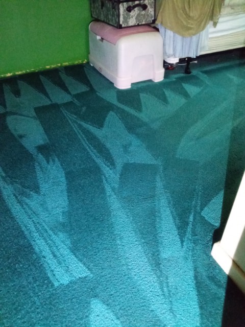

Why not groom with a rake?
It takes longer but I believe using a CRB with soft brushes makes the carpet fibers stand up better and makes the carpet look better than with a rake. Especially cheap polyester
Some people HATE the TRUTH but the TRUTH is VLM WORKS !!!
I love VLM !!!

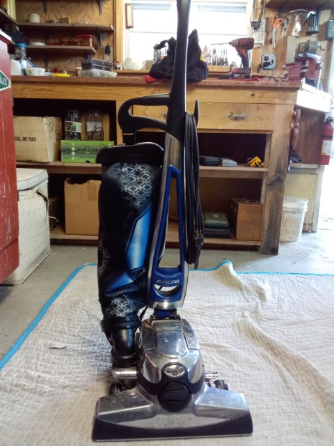

Silver Solution works good in certain situations, but I didn't think you were supposed to spike it?
Haven't used Silver Solution much in the last year but when I do use it I only use it on lightly soiled carpet and furniture. You can add peroxide to Silver Solution.
I have that same Kirby vacuum.

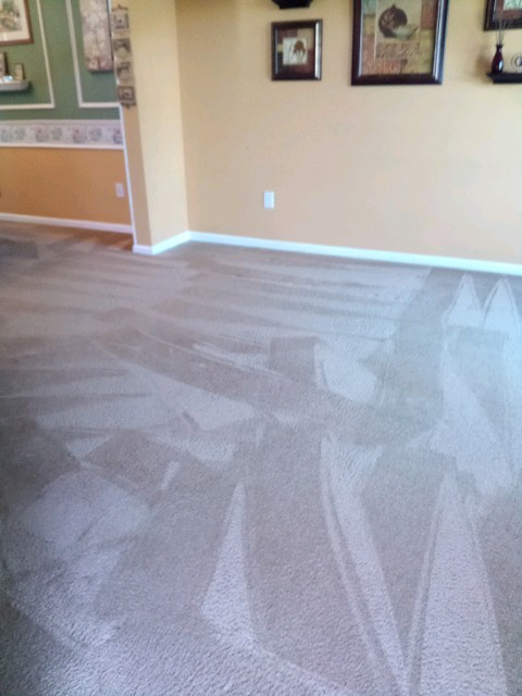

I would groom a carpet like that especially if I was going to post photos of it...
SteamwayPro
Apr 8, 2012
289
USA
George
I would groom a carpet like that especially if I was going to eat post photos of it...
Not sure what that means
I guess eat post photos means take post photos
Doesn't matter if I'm taking post photos or not that's how I do it

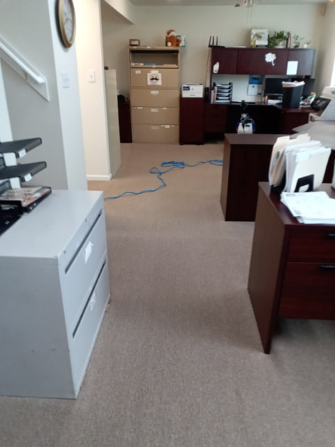

Looks like a low budget location so they probably didn't notice or care
Your exactly right about that. 30 year old nylon carpet. It was a trashed rental and I had to use a shop vac to vacuum up all the crap before I started to clean. The owner of the townhouse paid me and he appreciated the work I did but the tenants probably trashed it again within a week

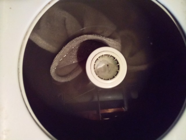

I've seen a lot of Procyon copy cats. The true test is to put some in a pail and run hot water in it. If it foams, it's crap. Procyon doesn't foam at all.
Your exactly right about that !!!
And that's why I use Procyon Powder to clean my bonnets. NO FOAM !!!
It's a expensive bonnet cleaner and needs HOT Water but it doesn't foam and I don't care if it's expensive. All I care about is getting the best possible end results
I hated when I looked into my washing machine and saw it loaded with foam. With Procyon Powder there is NO FOAM and it cleans my bonnets better than anything I have tried. Have you ever taken your bonnets out of the washer and they felt a little stiff ??? I have but no more !!!
I want to get all the dirt and detergents out of my bonnets, so they're soft fresh and clean to start with. That way they can better do their job
VLM cleans by absorbing dirt into bonnets that's encapsulated in the cleaning solution so clean soft bonnets are very important to getting the best possible end results
Doing all the little things adds up to better end results. Cleaner carpet and happy customers !!!

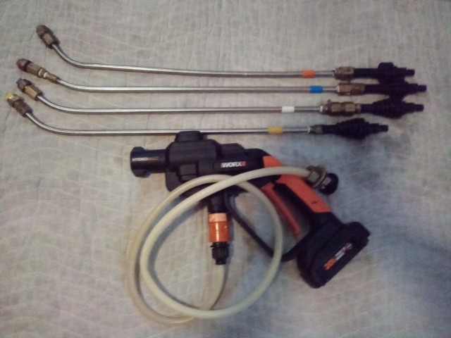

My opinion on the best chemicals for VLM in Residential homes has changed over the last year
I still like Carpet Details for homes with elderly and need zero odor or very light soiling but for the other 95% I have found Vacaway detergents are the best for VLM cleaning of Residential carpet
Carpet Details struggles to get the excellent results I need on difficult to clean polyester carpet
Double Trouble is amazing cleaner of polyester carpet at 2oz and has very low odor using a 8002 jet on a Worx Sprayer. Heavily soiled needs 3oz
The BEST Sprayer for VLM is a Worx ... PERIOD !!!
I love VLM !!!
