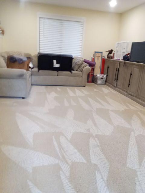

Vacuum
Prespray with Worx Sprayer and Carpet Details
Scrub with Brush Master Pro 35 14'' CRB
Extract with Trinity Odyssey
Groom
It's not the 1990's anymore
VLM WORKS !!!

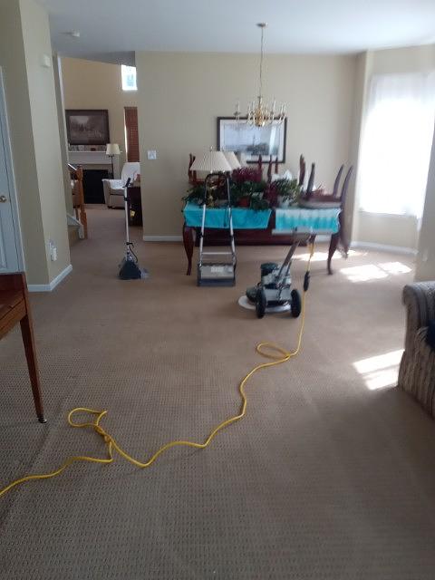

Gotta be careful Posting the TRUTH about VLM because anon might BAN Me from the Carpet Cleaning Room
anon HATES the TRUTH !!!
Vacuum
Prespray with Worx Sprayer and Silver Solution and Detonator (Peroxide)
Extract with Orbot Vibe TL and Cotton Bonnets
Groom with 10'' CRB
VLM WORKS !!!

Why not groom with a rake?

Silver Solution works good in certain situations, but I didn't think you were supposed to spike it?

To be fair I think nearly anything works on well maintained carpet....
