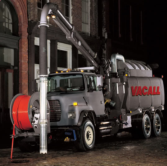

sweendogg said:
Forget Vortex or AT's, This will be the next generation of carpet cleaning, and 4 to the door.. ha, we'll be going 12" to the wand, And instead of 1000' of hose.. we'll be talking 10,000 feet.. Clean entire collage campuses from one location! :roll: :wink:
That is what I used to do for a living before carpet cleaning hydro-vac excavating that is a real truck screw the vortex!

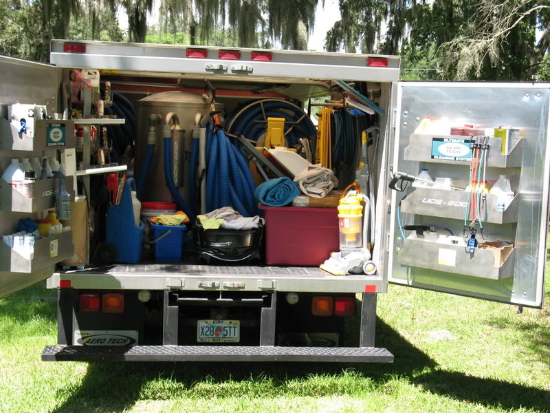

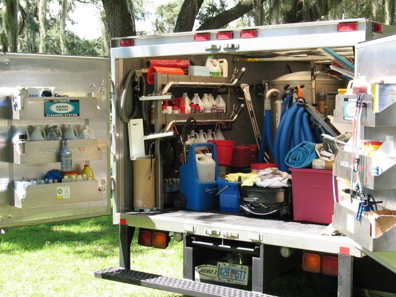

FYI \
Tom Cermak's had his AT for over 2 years now and still Lovin every minute!
Fan's, Dehu's, repair tool's, vacuum , Airpaths, Rover...spotting kits and more!
Big trucks love them hate them want them ... your choice ... I've made mine!
And The AT was only 72K with water softner, wands, engine heater and side light.
Jim Martin
10,877
Jim Martin
I would just cringe every time I opened that door........
How do you get things in and out of there with out killing yourself...........
how do you get to the filters.........
Nice electrical box on the left there BTW..one of the better ones I have seen.........
you should put it in a water prof box though.......
captaincarpet
Nov 14, 2006
546
Thomas Cermak
That picture was just for that particular day, what is in the back changes almost every day. , some days we're set up for Tile & Grout, some the power stretcher and/or mini stretcher are in back for Repair & Reinstall, Some days both Dye kits... some days nothin but fans & dehu's for floods...
I'd need an extra 18 wheeler if I wanted to take everything everywhere.
The back can be a nightmare when we are multi tasking on the same day!
(but its a lot better than trying to do all that out of the back of a van lol)
As far as filters and such, vacuum out for cleaning first, Wands next for cleaning, then filters are easily accessable.

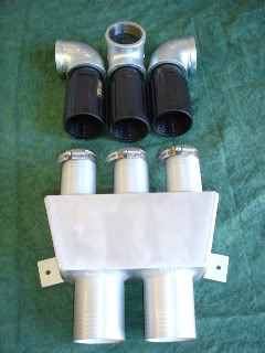

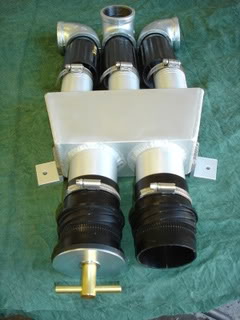

Lose the ball valve on the third vac port, it's only 1.5" ID, swap out the grey pastic elbows for galv ones. I'll post pics of a coolcuff modified galv elbow you can plumb in, just follow it as a template as you already have the rest.
Yes, those are Starter (adapter) cuffs threaded into the Galv. elbow, we do them here cause it's a pain to do by hand. It absolutely flows better when done.
