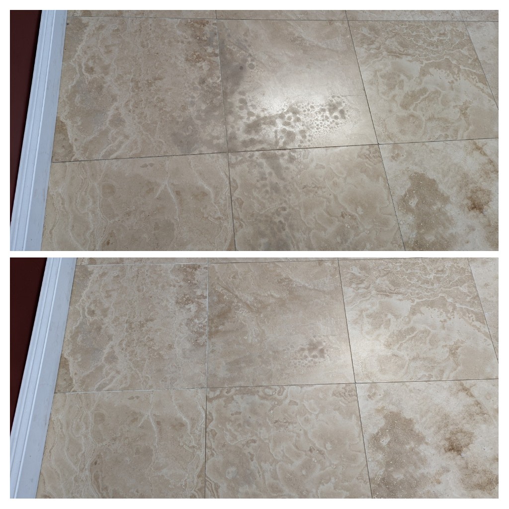

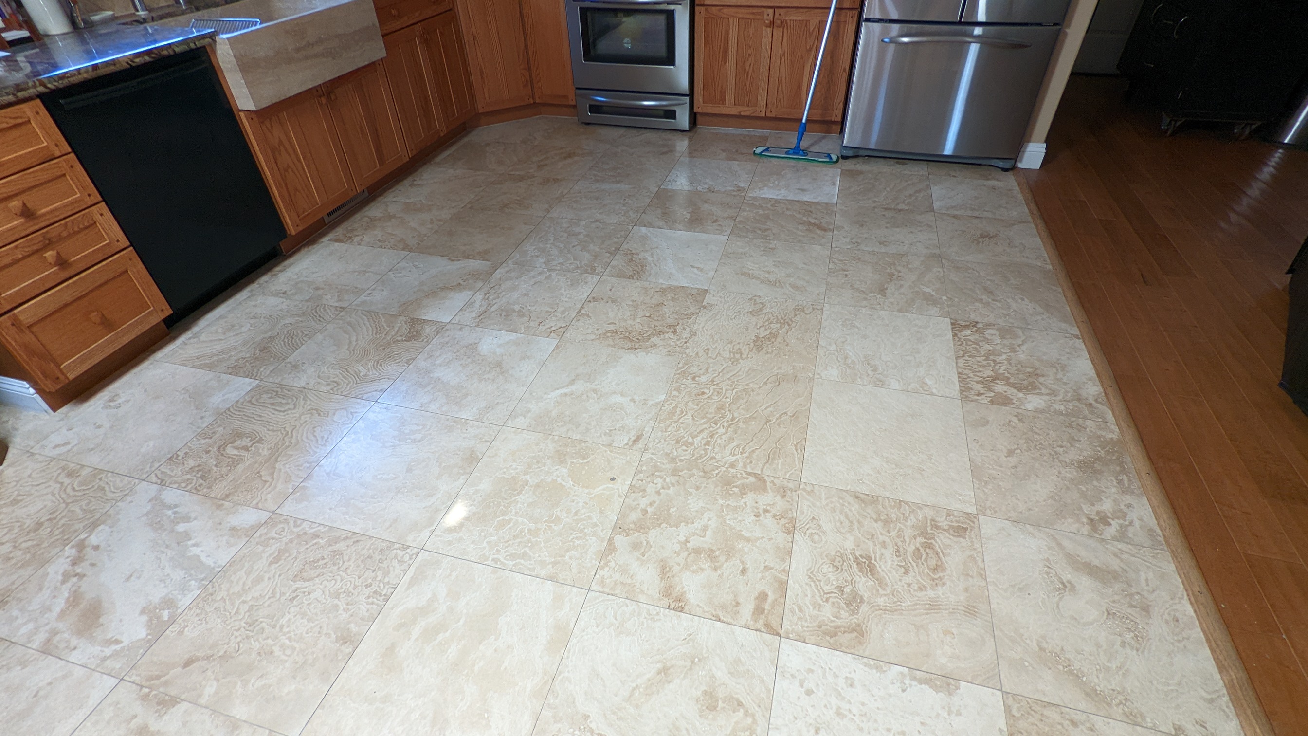

Turns out it was real travertine, very unusual one..
Got the red out but the etching remains. They didn't want to resurface the floor.. 20220831_111026-COLLAGE.jpgPXL_20220831_170836167.jpg

Not only did I misdiagnose this floor from the photograph that I posted elsewhere. I also blew it in the freakfact that my Crocs left footprints after using Sager tsunami and sugar oxy end cap to chemically etch the floor, normally I would have used 40 volume but I removed it as I'm headed to Vegas on Saturday and the only peroxide base product I had was the oxy encap, while it worked well, there were some kind of weird chemical reaction with my favorite casual footwear

These people turned out to be super cool after I was done overloading them with travertine information and doing the magic on the floor. I got invited out to his garage where he had a classic. Woody a. BMW c90 a Yamaha 450 trail bike two E mountain bikes and E road bike. A classic road bike. Some kind of badass motorized scooter for the wife and he had a two motorized wheel. Fully suspended skateboard and a much rather cool shit in his garage and they spent way too much time there for 200 bucks but it was well worth it
