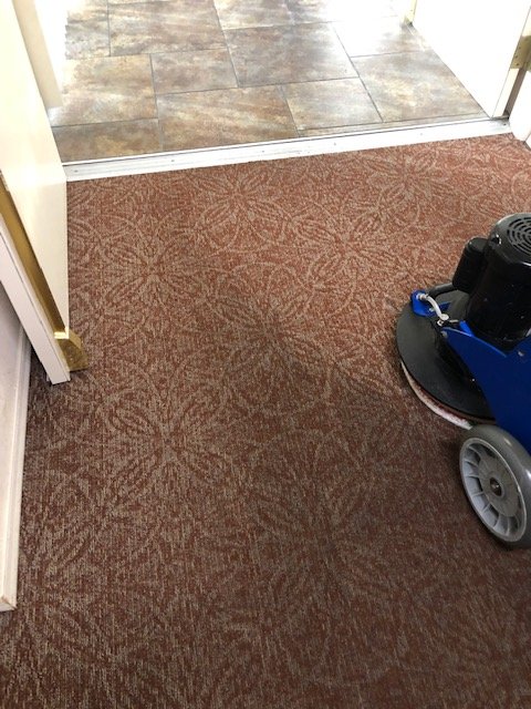

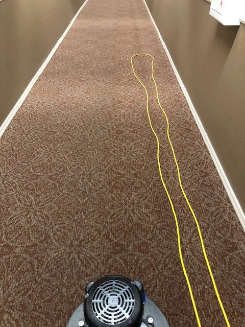

I'm a little late responding. I have a Trinity Phoenix. Used one at Phoenix Mikey's Fest 2 years ago.
Great machine.
I shot a short video and my Iphone doesn't let me transfer video's to my laptop via cable, or gmail too large of files. It will let me post to FB though.
I posted the video on Trinity Group. If you can swing it to this forum Mike please do, I couldn't figure out how to do it (without video being too garbled).
I call it mowing the carpet, pretty simple and quick.
For high traffic lanes I have my own approach. I use a very wet tornado pad, usually follow with a tan fiber pad, then pick up soil with a microfiber pad. That's just the dark areas though, otherwise I'll use only a microfiber pad on the rest.
This job there was only about 10% of the area where I used the 3 step method (I could probably skip the fiber pad, but it works really well where there have been those carpet protectors and everything else looks bad, so I lean on this method a lot).
This job I did today, about 720 sq. ft. an hour. This is post covid, and I still am only at 1/2 stamina.
