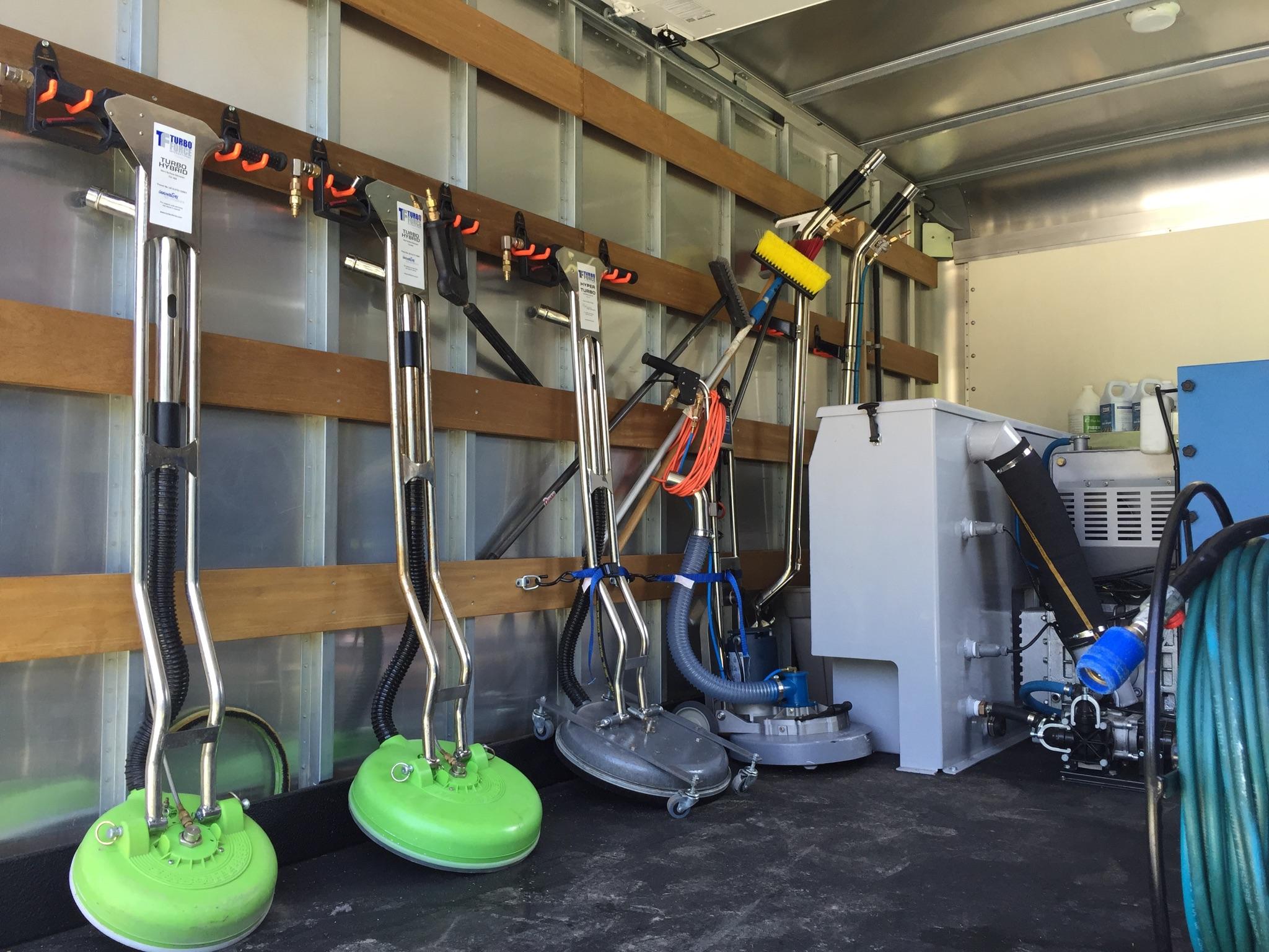

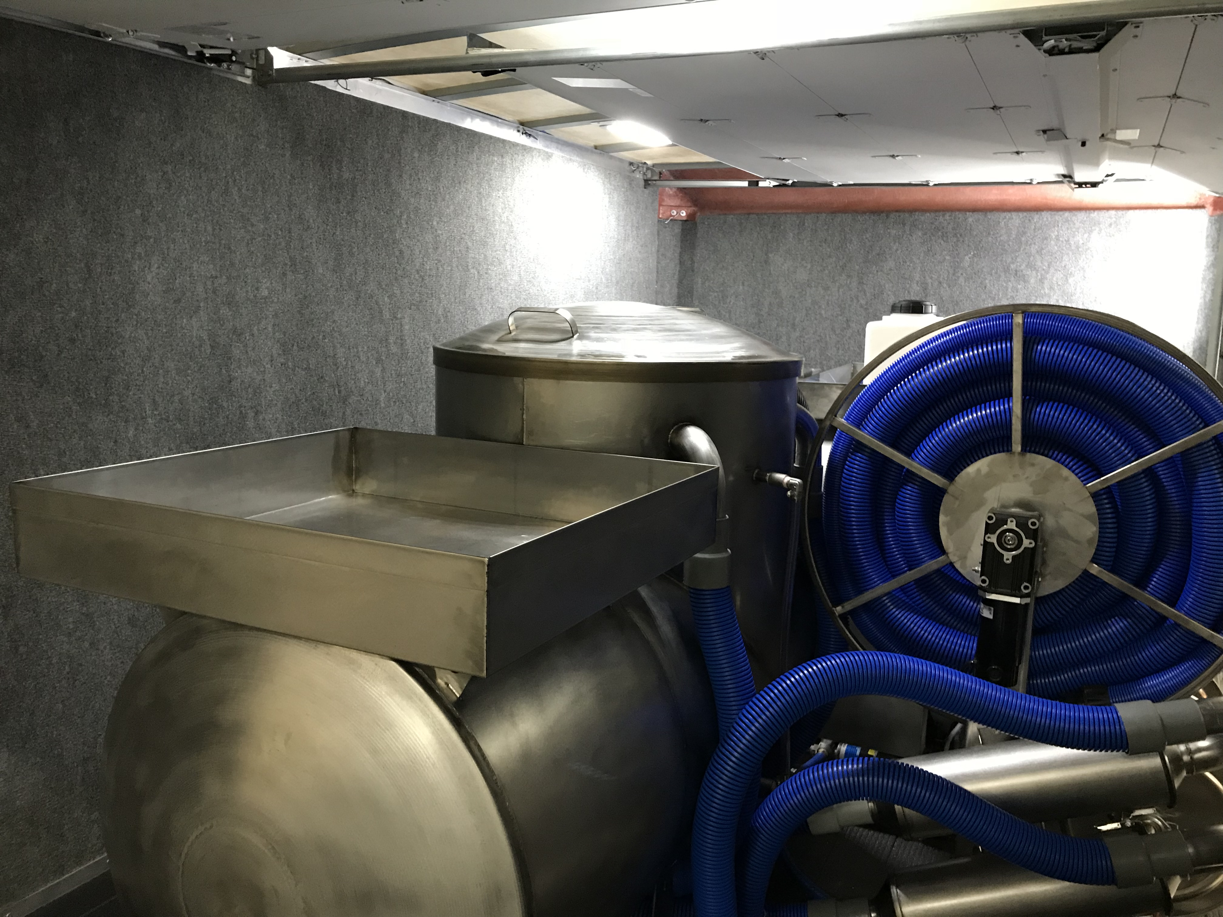

My Apex had the Comet. Worked great until the springs get clogged and I hated taking it apart every other week (even with Devastator filter) New TM has the pumpout made by Janitors Closet. Its mounted inside the waste tank (saves space) and is backflushed to keep it clean. I do clean it out when I clean the waste tank. Have had it a year and has never failed me.
It also allowed me to have the smaller waste tank which means more room in the van!

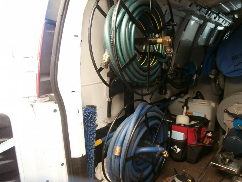

Hi J. Can you post photos of set-up to show how that works. Currently on truckmounts we use AMT belt-driven trash pumps pulling from bottom of recovery tank, but sometimes they have difficulty in countering the suction.
roro
J
JS41035

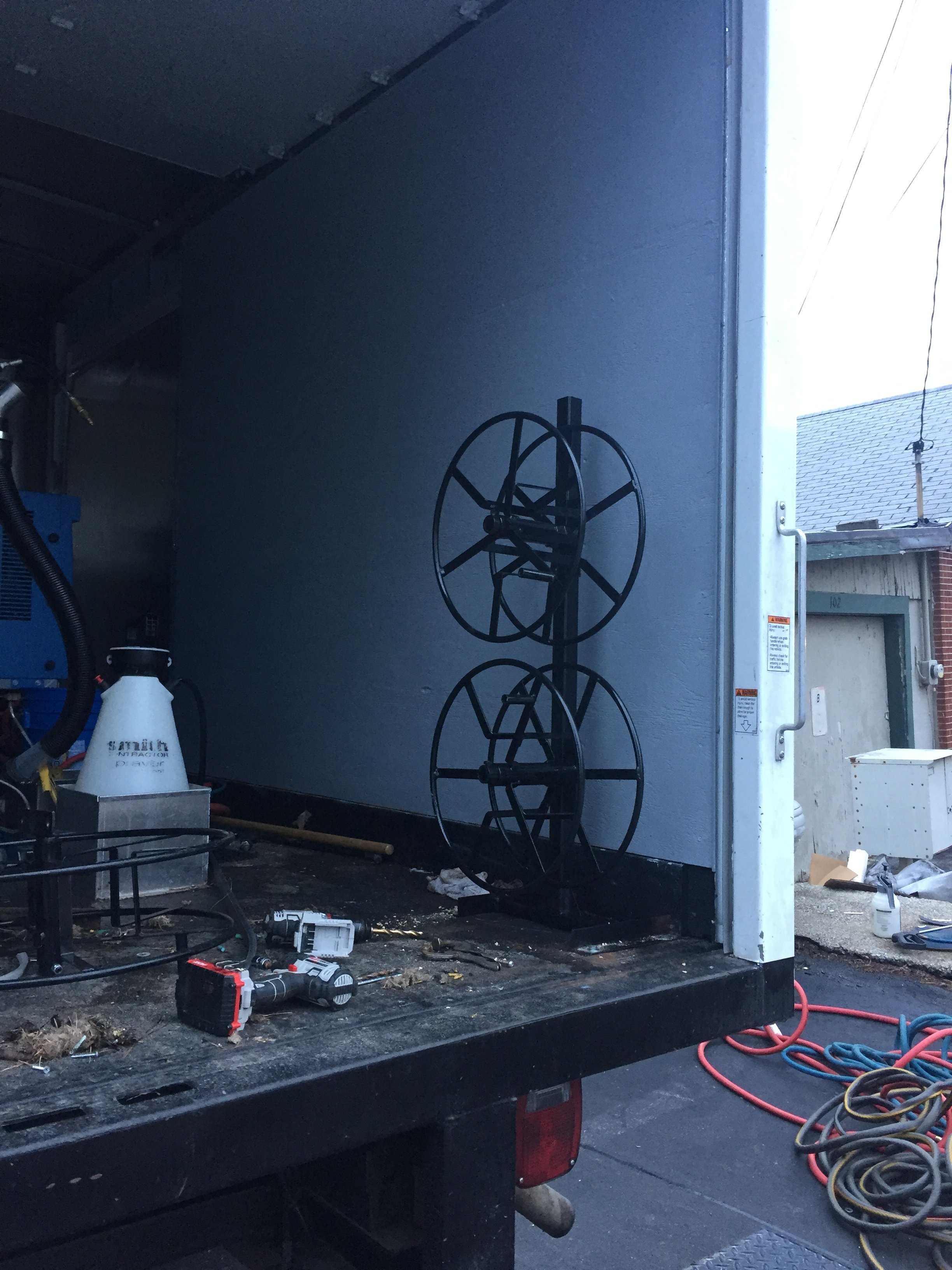

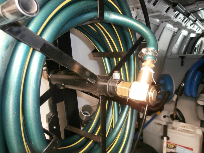

the top two pics are from Jim Martins setup. He posted the Wintrax part numbers also.
My APO is plumbed into the top reel and fresh water is on the bottom because I evidently enjoy getting wastewater on myself when I wrap up.

Jim Martin
10,878
Arizona
Jim Martin
Put a cap on the end.. That way it does not get all over you or your truck....

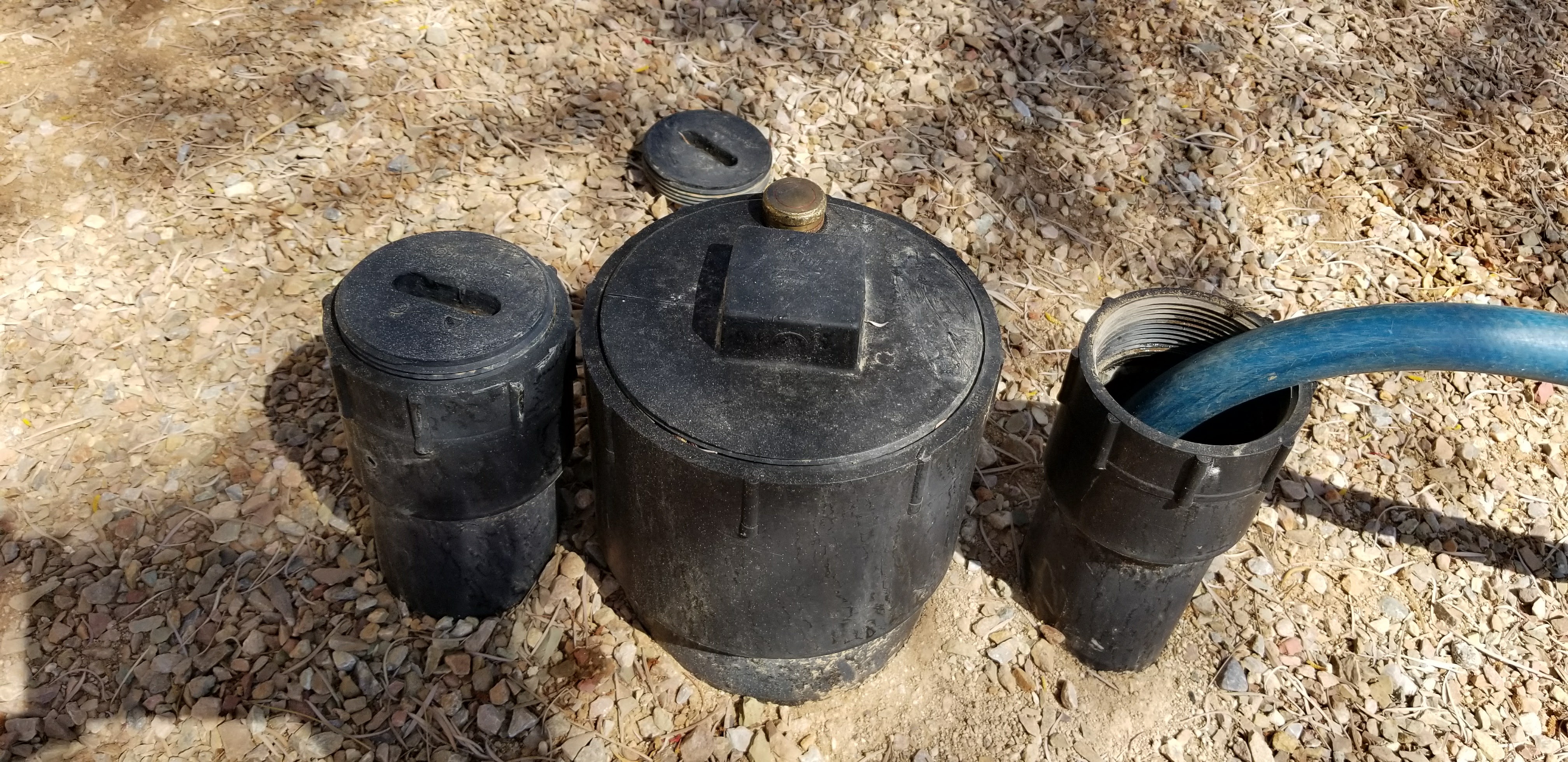

the big one is the sanitary sewer, that one is their well.....

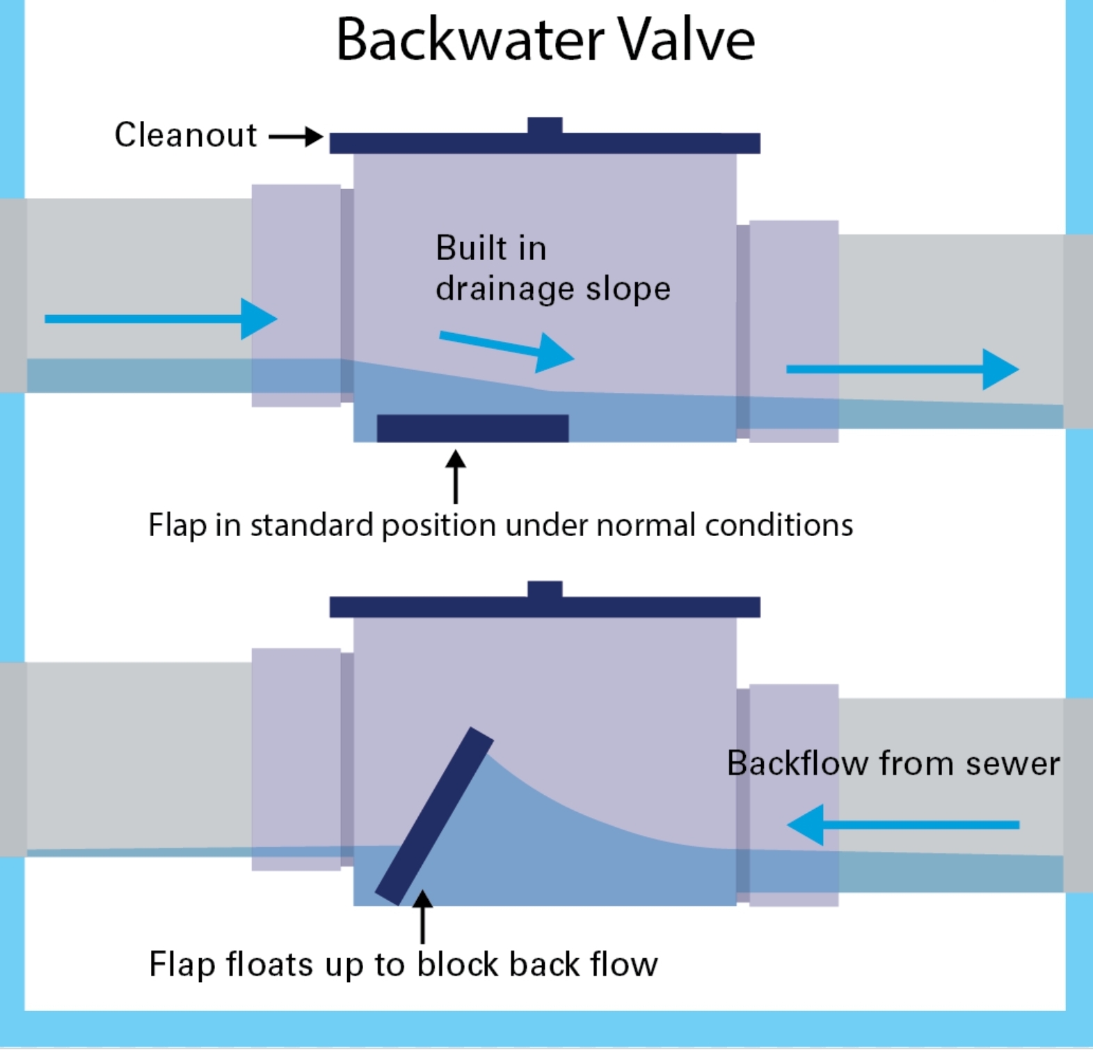

The one the hose is in goes to the street..... The one on the left is from the home... The large one in the middle is a one way flapper that allows the sewer to go out of the house.. but is for some reason everything backs up on the street side... If will not go into the home...
