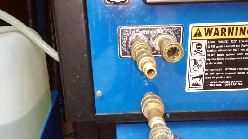

Who else does this to help prevent freeze damage?
14,640
If it ever freezes, it will just expand out, to prevent any pressure buildup inside the heat exchanger
14,640
I would rate this right up there with the pull out method of birth control.
Don't get me wrong, I use a heater. But if a breaker trips and the heater shuts off, causing the water to freeze...I would rather the pressure to be released, allowing the water to freeze without damaging anything.
Am I wrong on this?

What if the nipple area freezes first .. then theres no room for the expansion
Get a circuit trip alarm or temp drop alarm !!
18,851
Lee Stockwell
If it freezes it will be in the bottoms of the coils usually.
I do drain all tool valve and manifolds, as well as vacuuming water from the system completely, other than the fresh tank.
It makes sense in theory but the reality is if its cold enough to freeze, you're only partially protecting one area.
Not only can you still have trouble there but way upstream there is going to be a world of hurt coming. :errf:
14,640
I agree. I would never depend solely on that thought of giving water a place to expand. It's just something else to help prevent any major damage if and when the heater fails.

Will work about as well as freeze plugs. It sucks to have to worry about it. I have a compressor on board so I would if necessary blow it out at the end of the day. Manufacturers should offer a freeze package with low point drains. I'll bet more than 3/4's of their market has the problem.
117,333
For the first time in my twenty plus truck carrer I have a 3/8ths male QC on the machine end of my garden hose.
Its wonderful.
