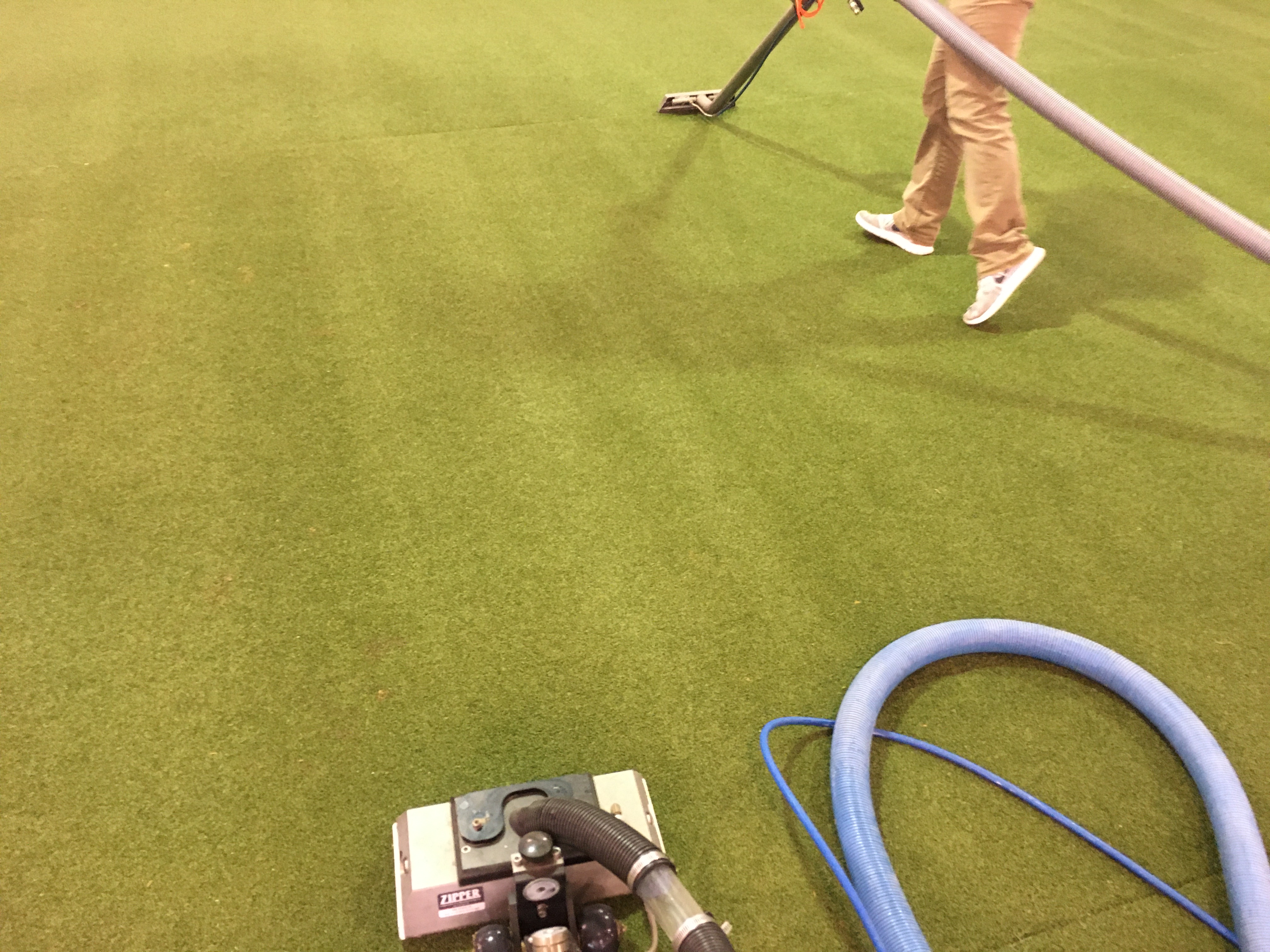

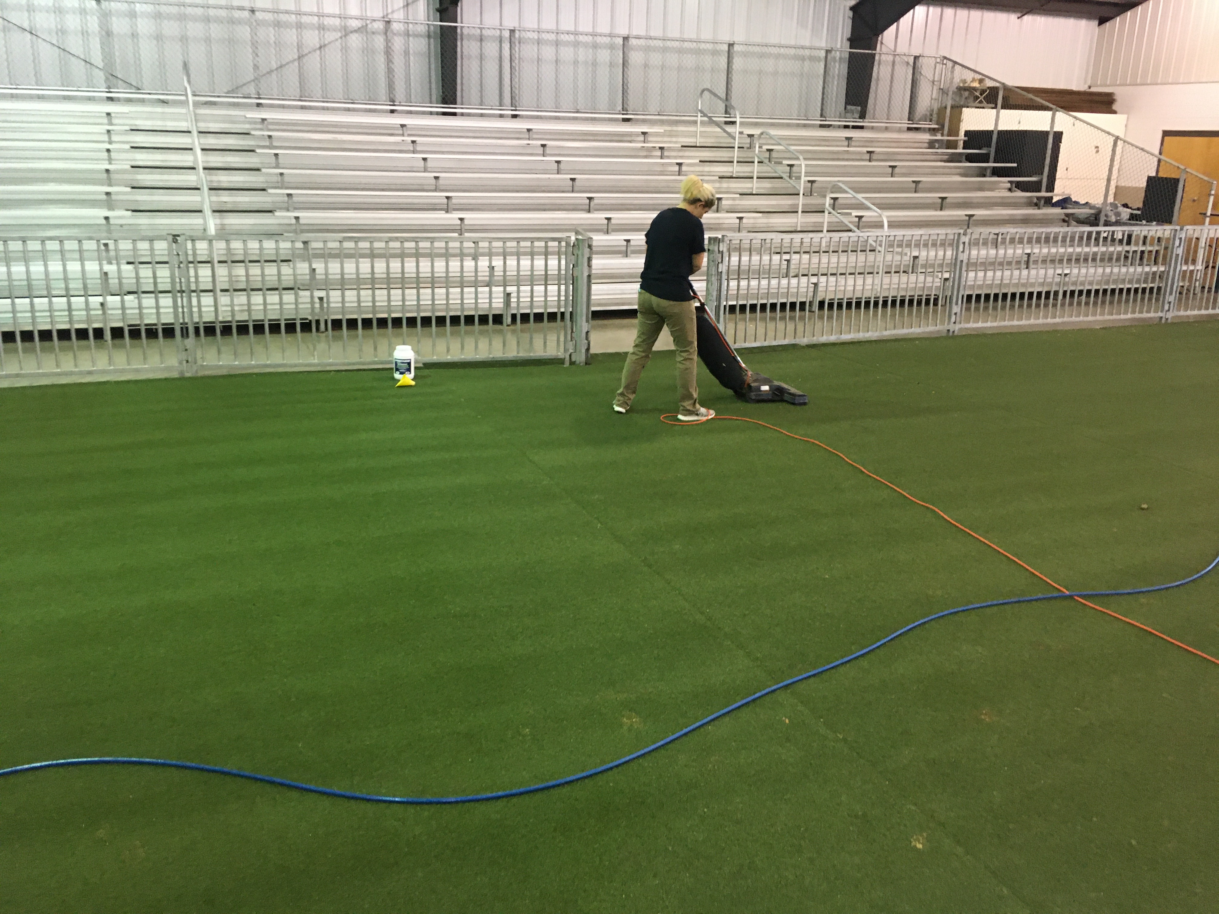

I dual wanded today on the pigturf job. I hwe with the zipper while she was right behind me with dry passes/no glide

Reduces friction
That’s what you guys aren’t comprehending. This job isn’t a regular Cc job. And no, I’m not gonna drag out my 175 or crb.
Friction is needed with all the ground in dry pig crap. That’s why I took off the glide. And it’s not too hard to push when you walk it.
And yes I prevacced it. It was a necessity with all the wood chips and loose crap. This is one of those jobs where the normal Cc rules don’t apply.
