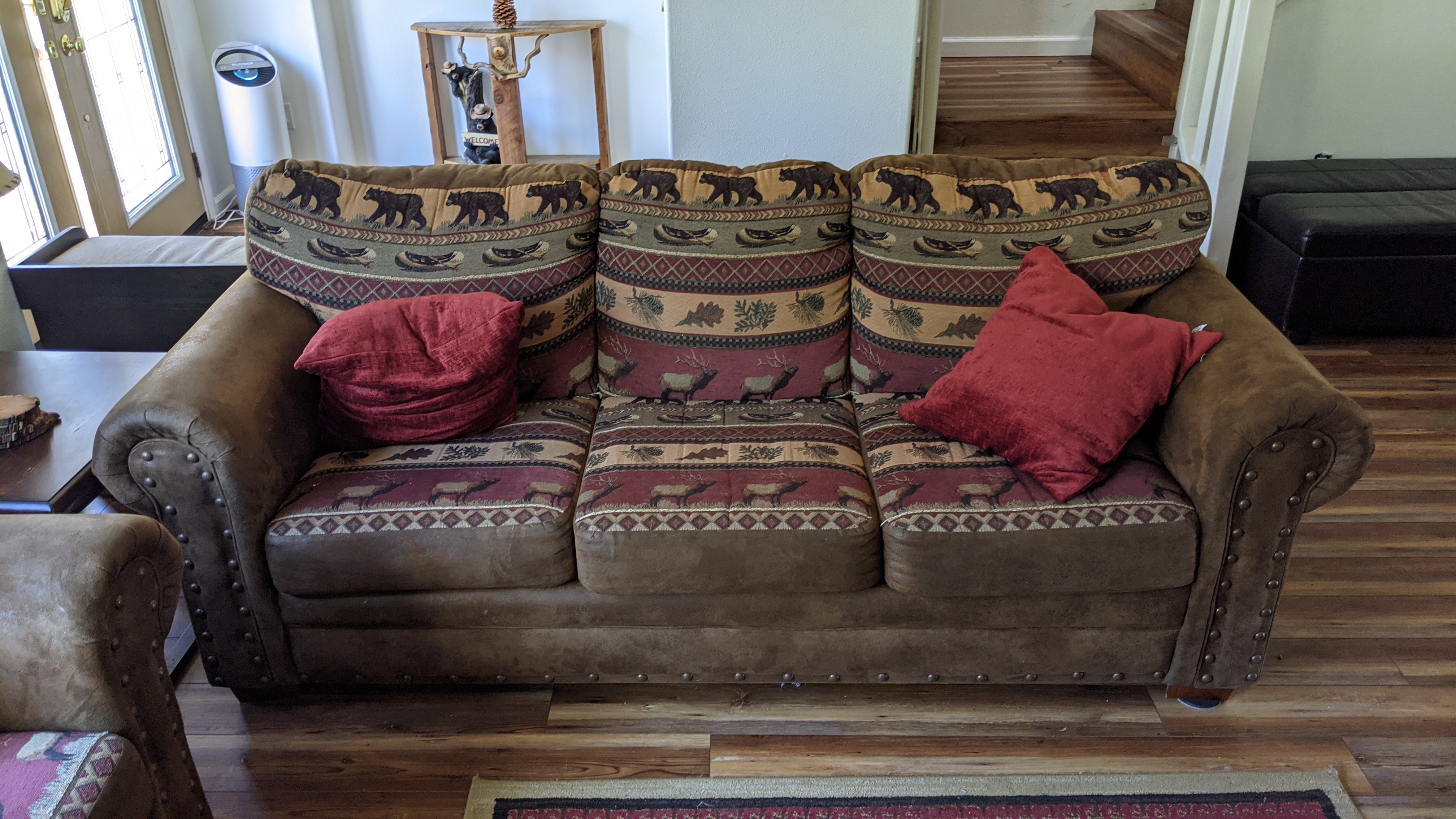

Perfect for dual method cleaning....LM on the micro suede, hwe on the fuax navajo..
