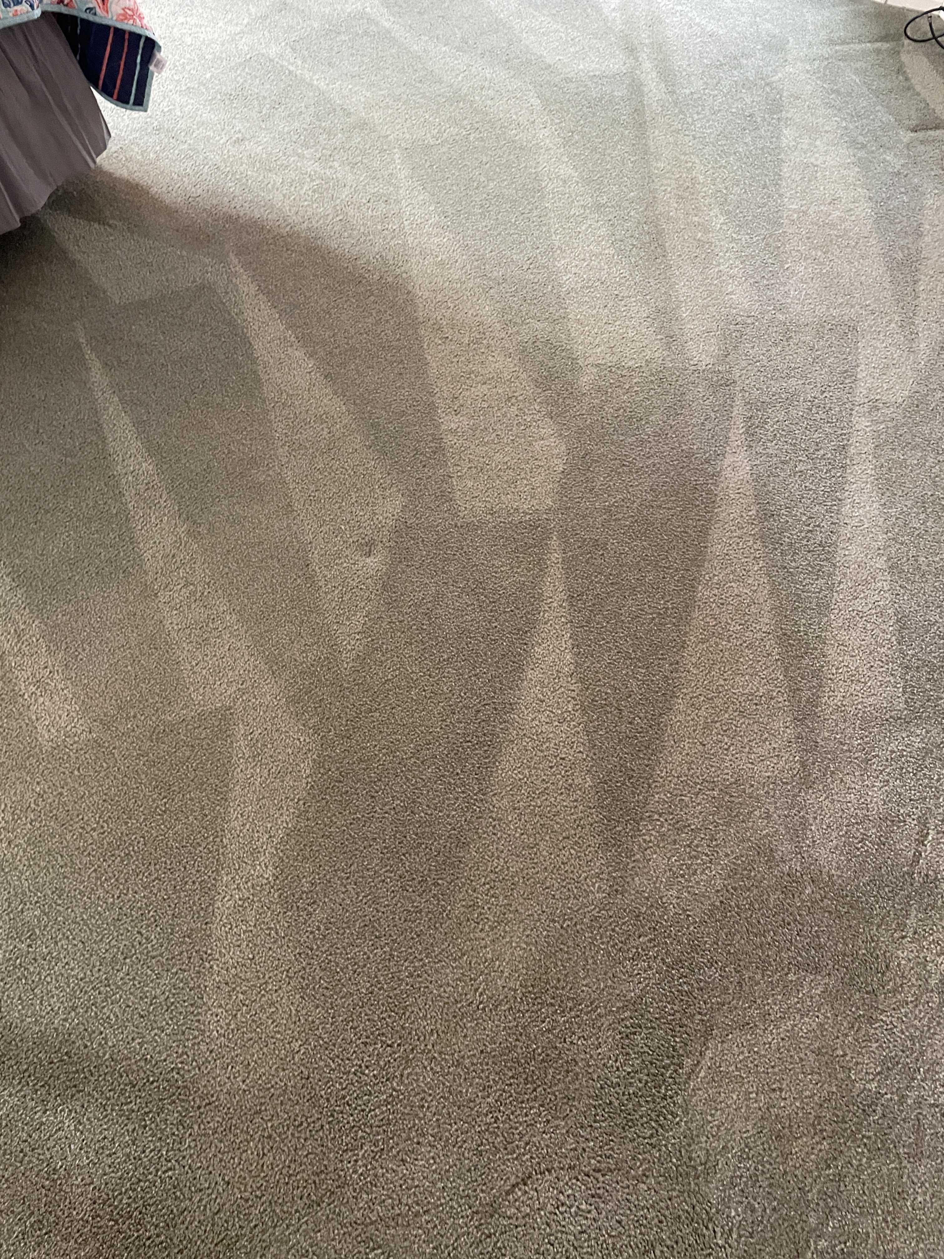

I am a bit obsessive, but that said. I pre vacuum all carpets first. Then HWE with dry strokes. ( real dry stokes forward and back in same path, not that saw tooth crap. ) When I complete the room I go back and dry stroke the entire room one last time to capture wicking moisture while looking for any issues.

Now, since Im never without the glide, I cant tell how many dry strokes, but more than a couple as im cleaning. Then to go over the whole room after I finish with a single pattern to cover the open area. only takes a minute or two. Keep in mind, Im primarily residential, smaller areas to cover.
I guess with commercial there needs to be more of a pattern of how many dry strokes.

One more time. 30 seconds.
Groomed it after.

I did groom and dry after that pic, didnt notice it with the eye. it was near my exit of the room and probably just the way the fibers are aligned at the time of the pic.

I'll do shark tooth if I don't like the customer, nor care if I ever see him again.
This is a passive-aggressive thing I do for some customers that lowball the estimate-I'll also fill up my fresh water tank at their house. 😱😈
I do multiple dry strokes and still leave teeth. Never had a single complaint. Is it that bad or are some of you just a little over the top.
Maybe I’ll change on Wednesday
Depends on how many dry strokes.. Maybe the Last dry stroke wasn't needed. either way- shark tooth proves the cleaning wasn't even/balanced for all the fibers.
