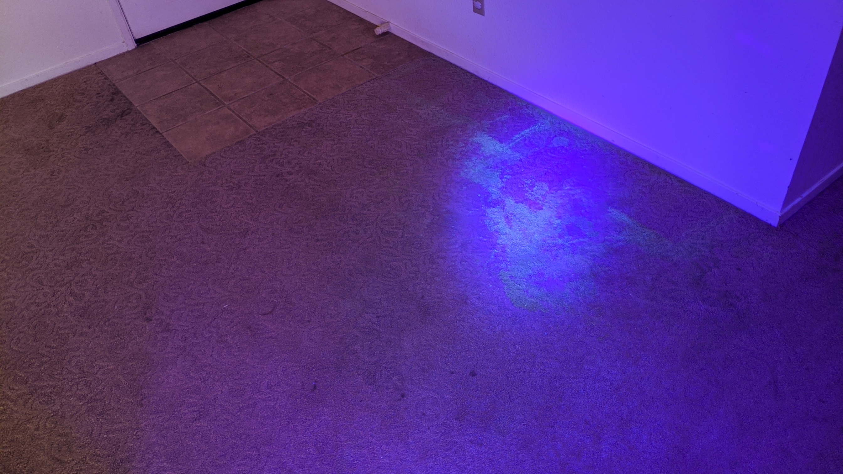

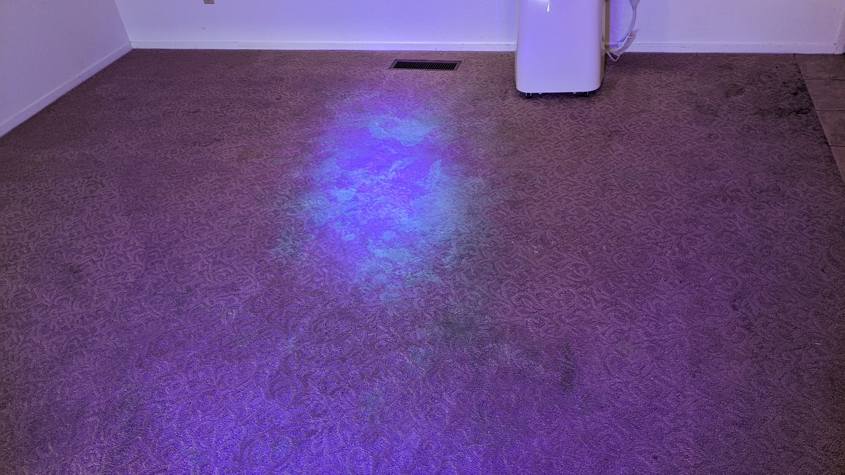

Well fvck me..I get to my first job which isn't even the one in question and it's close to 2,000 ft of sculptured nylon with at least 100 gallons of pug urine in it and the tenants concerned about getting their $1,200 deposit back...
Every inch of baseboard had been peed on a foot up and the markings throughout every square foot of this home is almost I dare say the worst I've ever seen but probably nothing in comparison to the Damon collection..
unfortunately the piece of shit PP500 when it's working is so bright you can't even see half the spots in the photos.. IMG_20200724_093642.jpgIMG_20200724_093649.jpg
unfortunately the piece of shit PP500 when it's working is so bright you can't even see half the spots in the photos..View attachment 101159View attachment 101160
Tears, I have tears. I’m just so proud.
