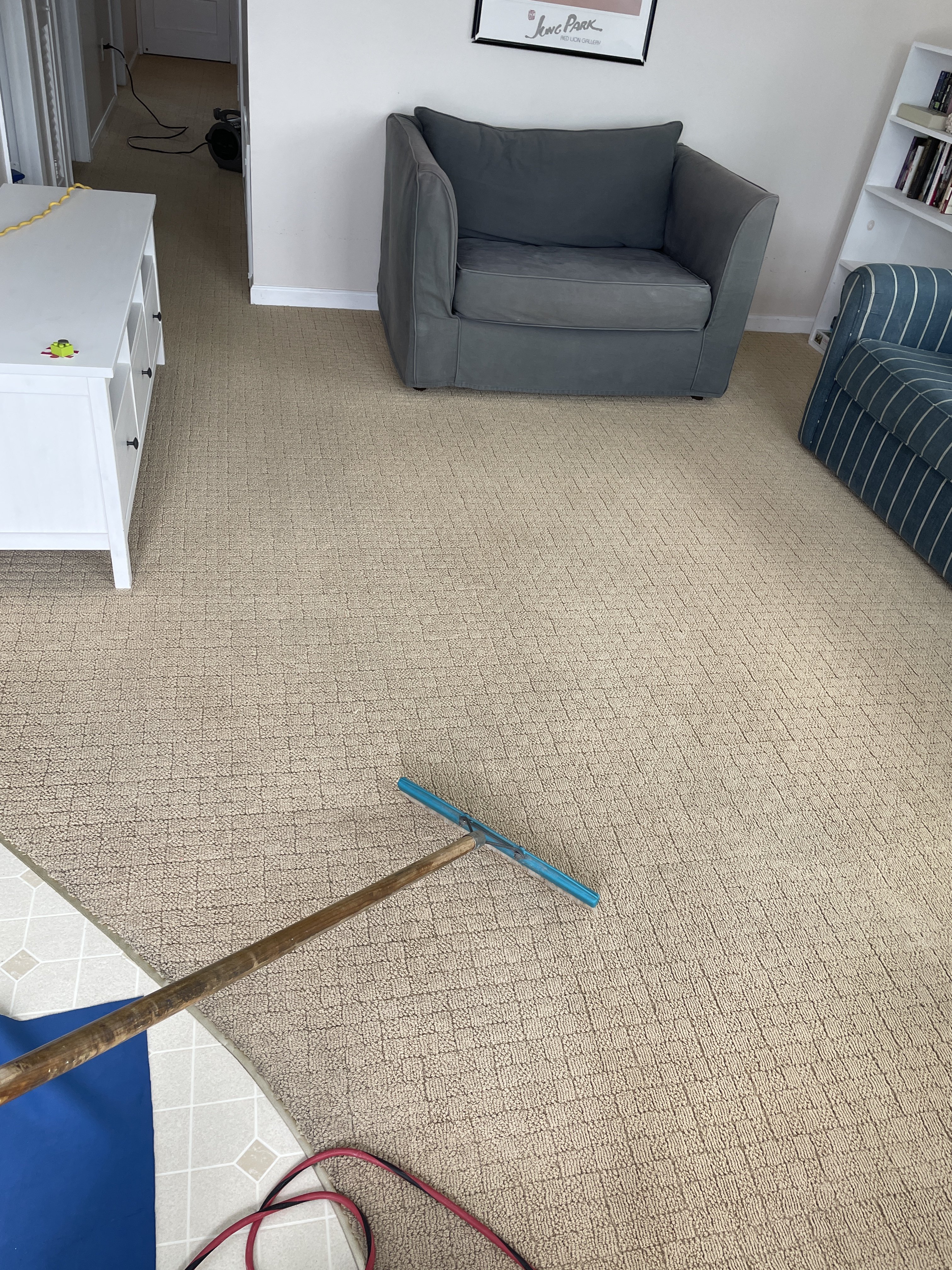

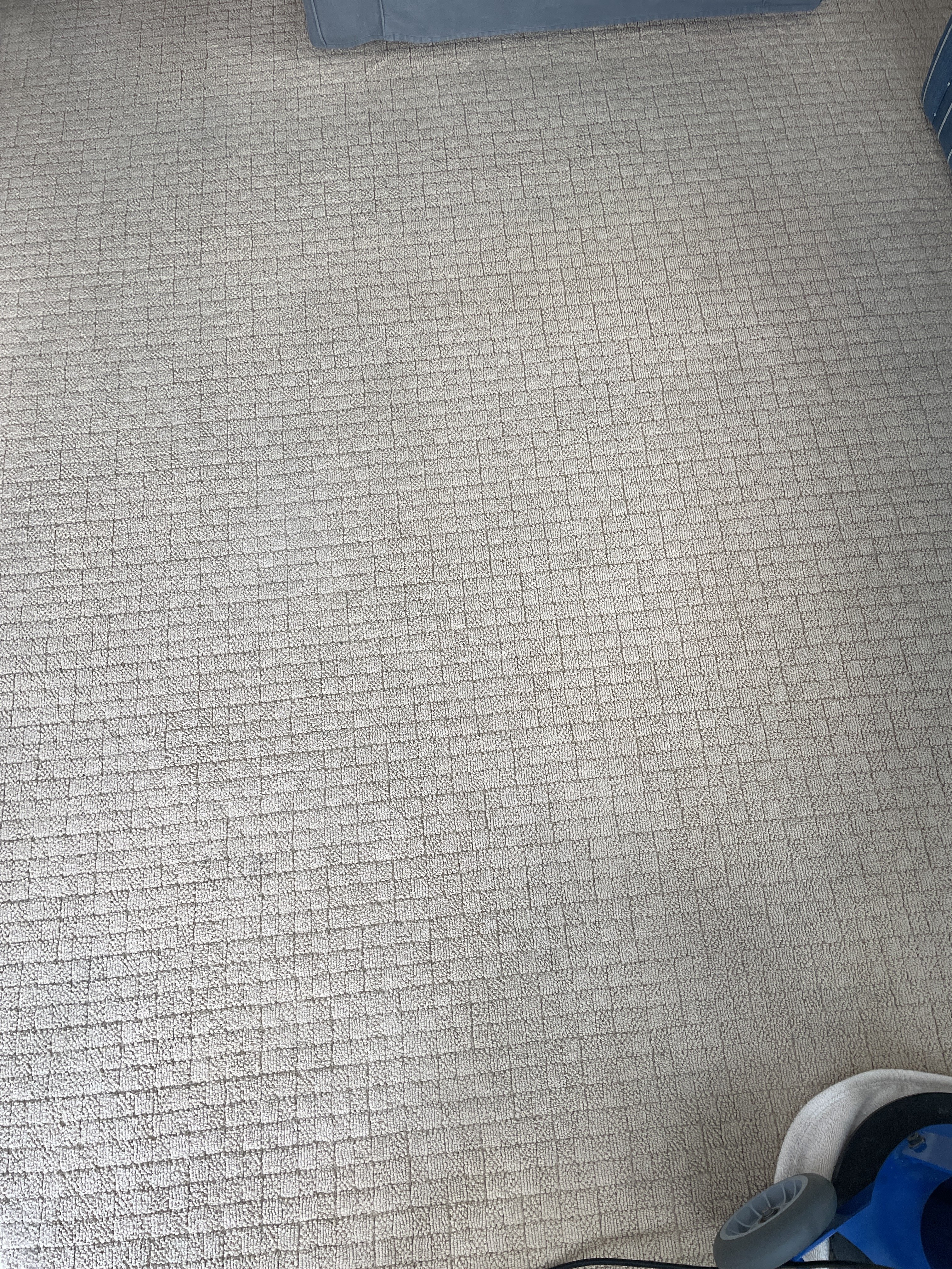

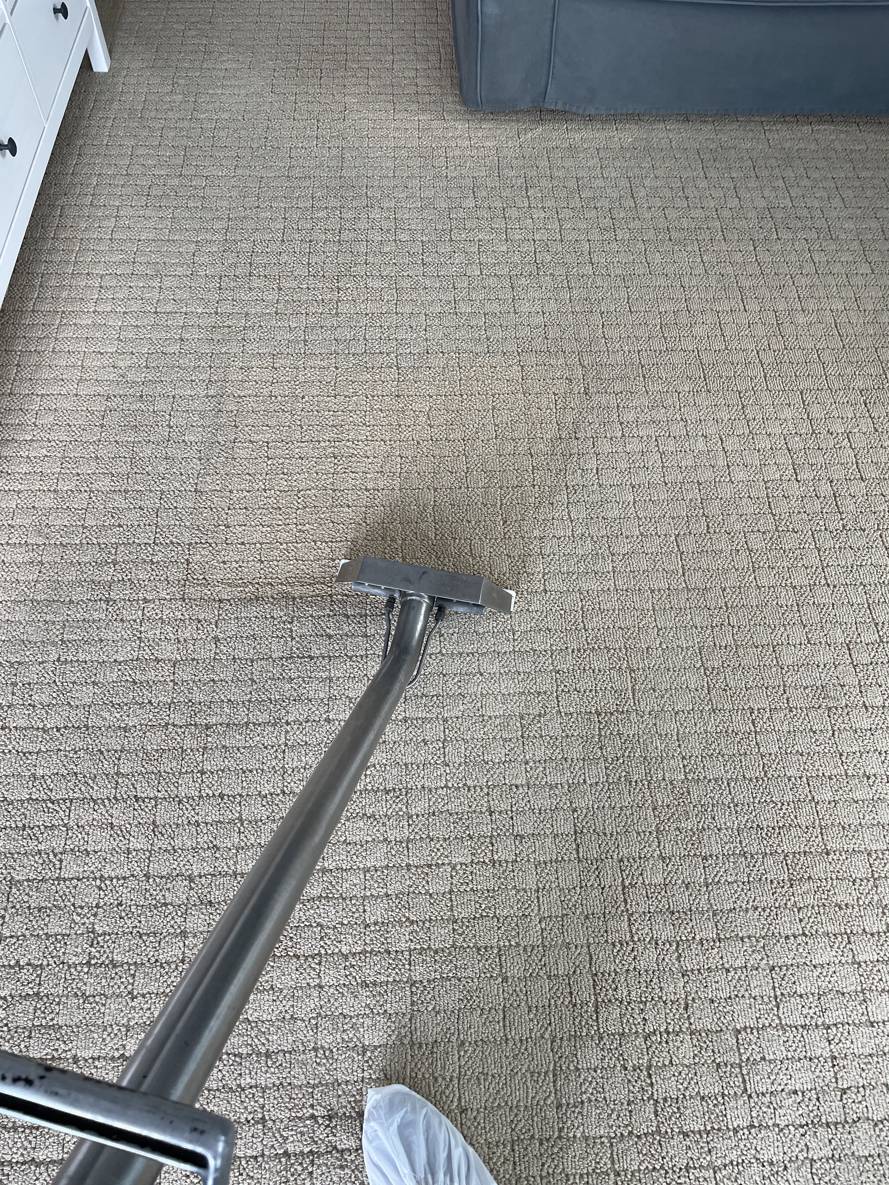

So I did my double vac of the Oreck followed by Kirby and used Tops Pad Cap Pro and the Odyseey to do the hallway and living room. She is so happy and has 4 freinds and neighbors, one let me in.

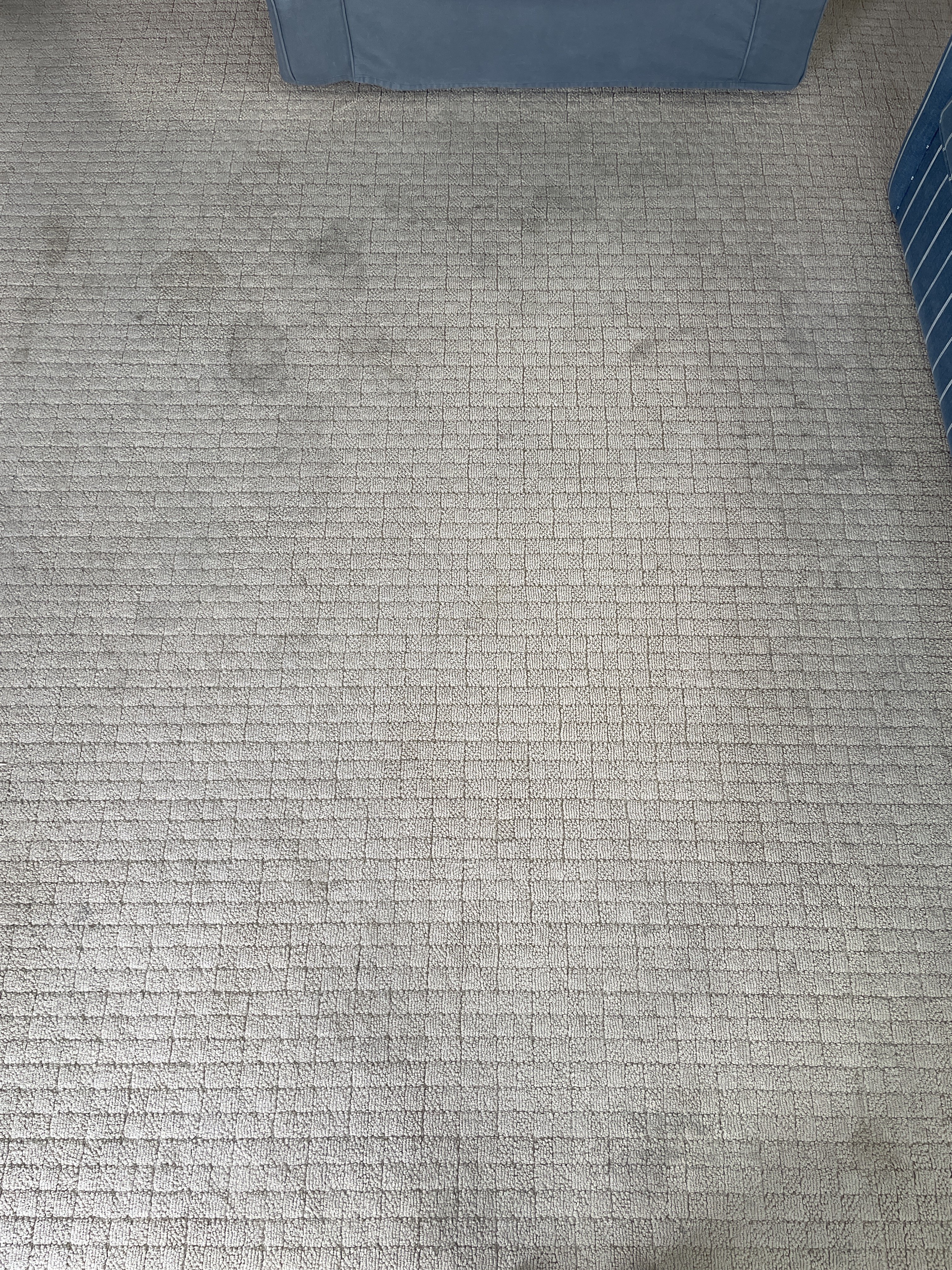

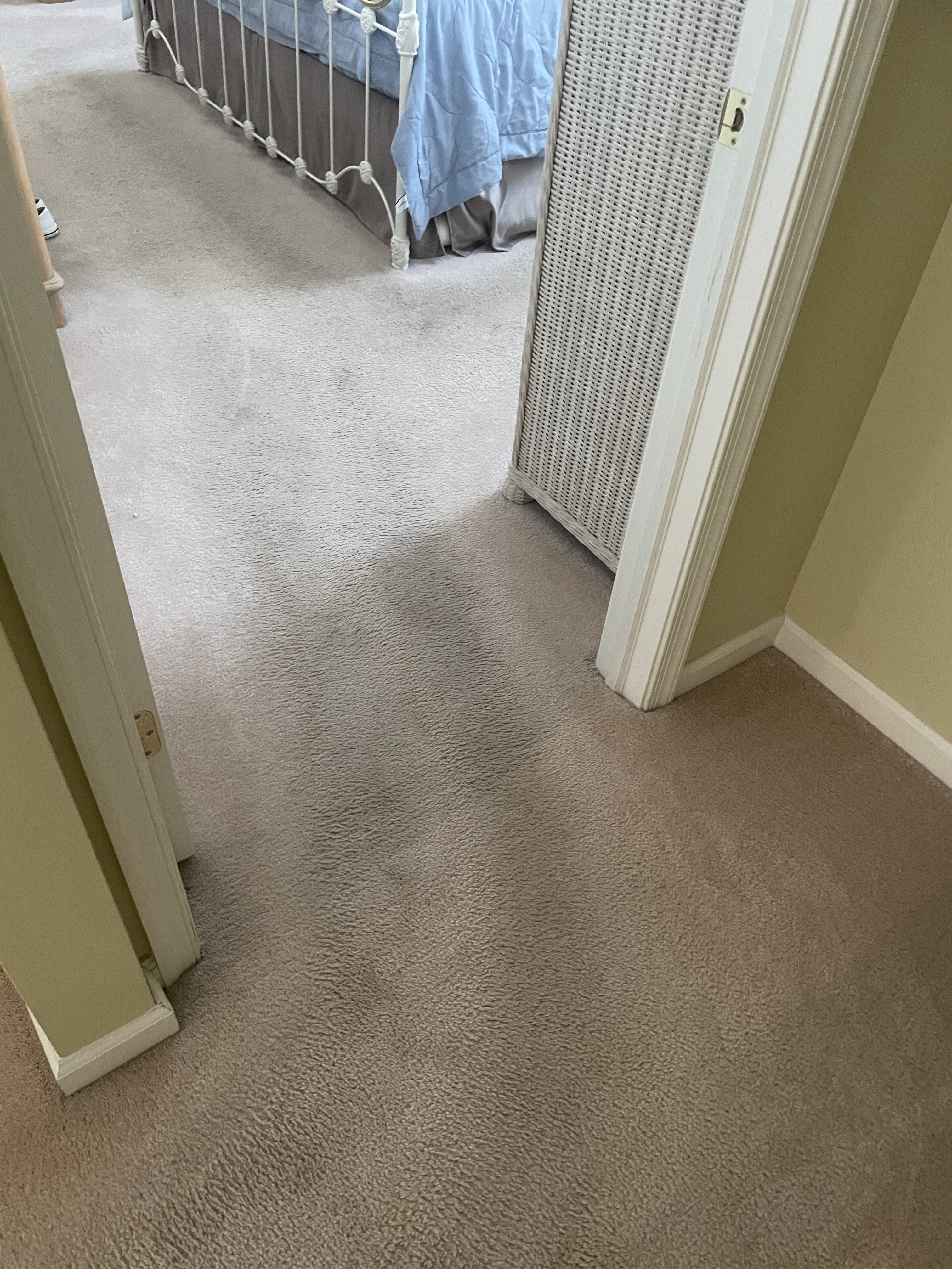

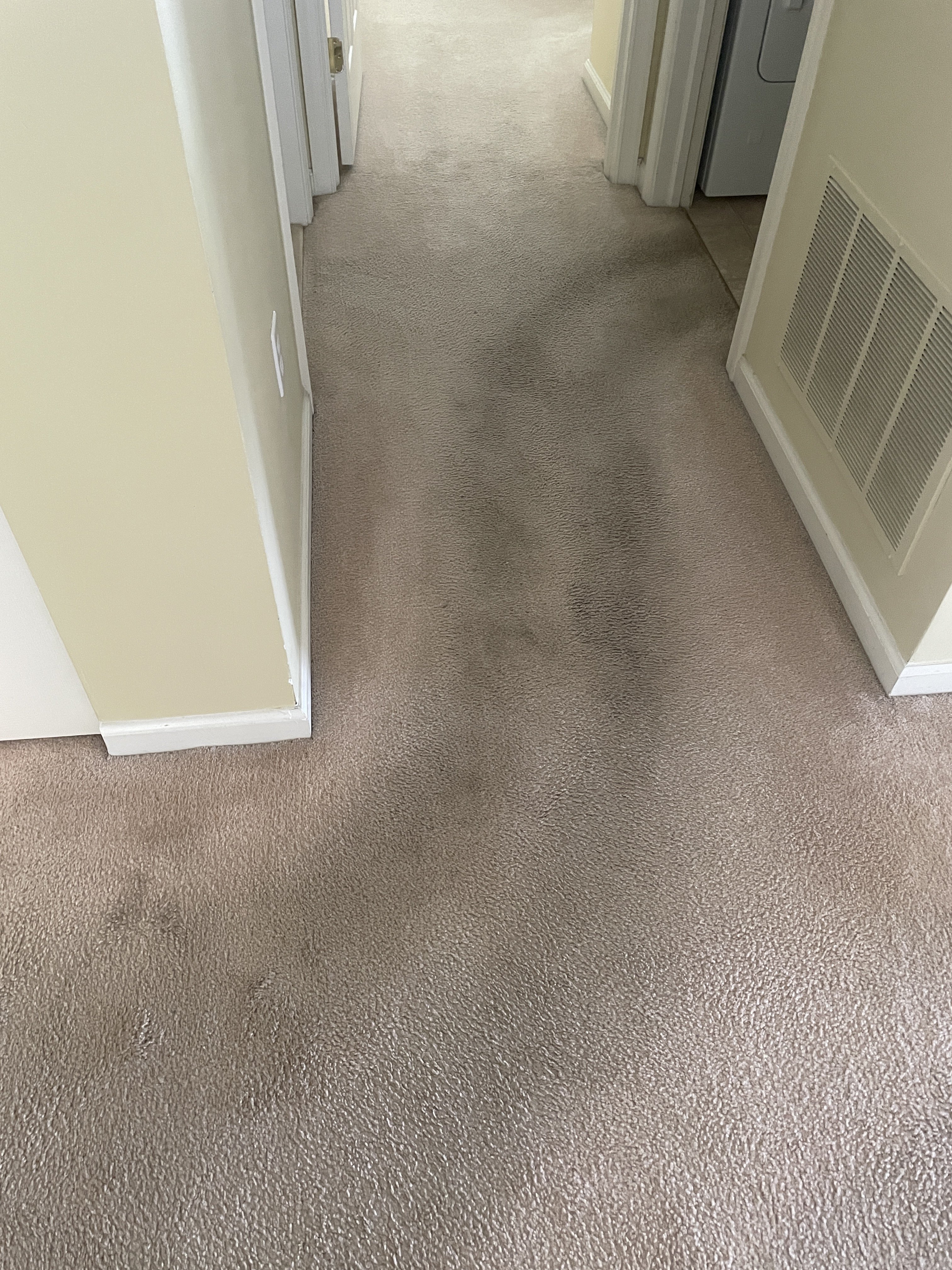

Results amazing, once again my camera sucks, and the lighting was horrible. But the pics show the area im talking about.
Where the PCQJ is and the other wands is where I HWE along with the stairs. To the left is just vacuumed.
Heres the hallway she wanted but not in budget.
After Odyssey with Pad Cap Pro, agitation pad and cotton pad.

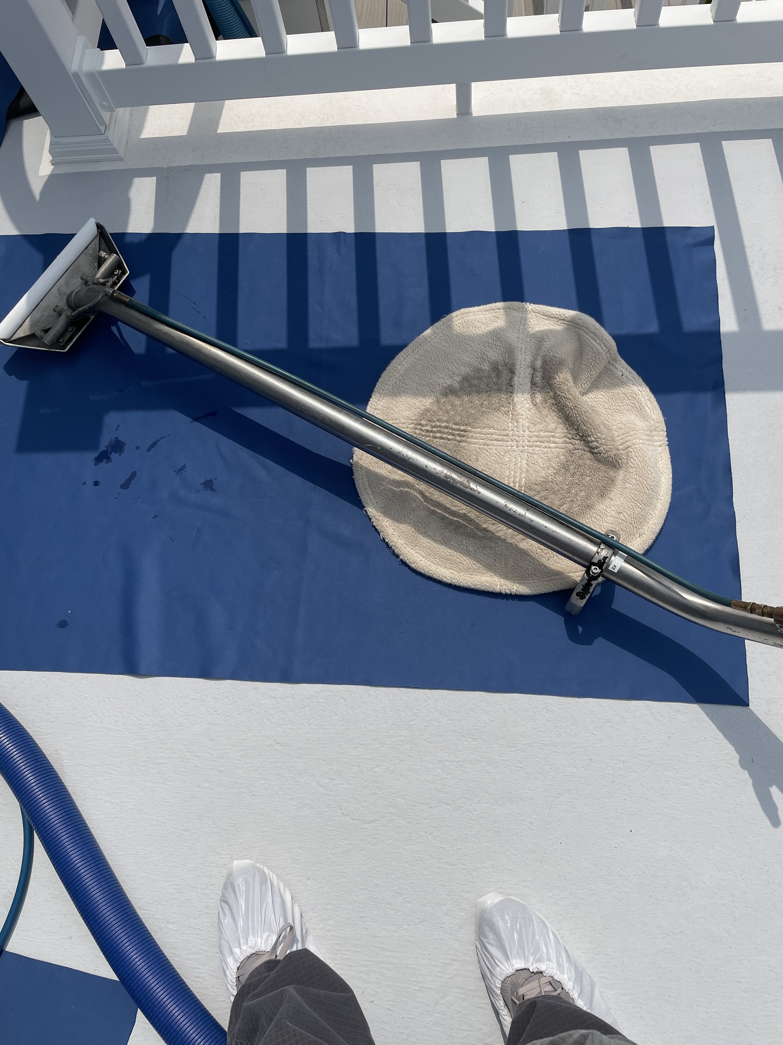

I also let the Pad Cap Pro dwell for 10 minutes as I was putting away my HWE hoses. I made certain not to touch what I padded and mess it up with water, lol. Seriously, she will give me and her friends the feedback of this experience. I feel good about it.
