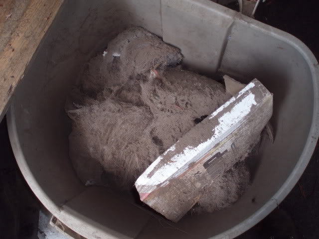

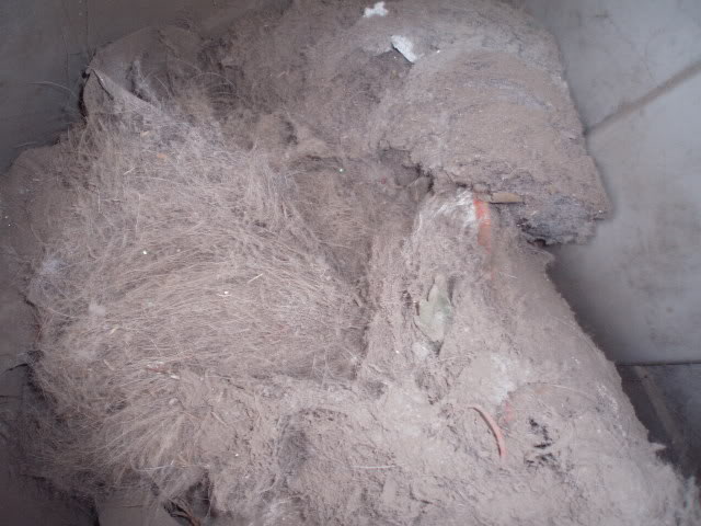

We let the customer pre vac.
117,321
yeah that's a great idea. :roll:
I absolutely hate that excuse for low priced induced laziness.
This ladies carpet "looked" fine. Stanley or Snow would have jumped right into it with both jets a soaking.
Us?
We new better and filled our Bissell and Sanitaire 6 TIMES!!
lr dr mbr and 2 set or steps.
and 4 dogs.
